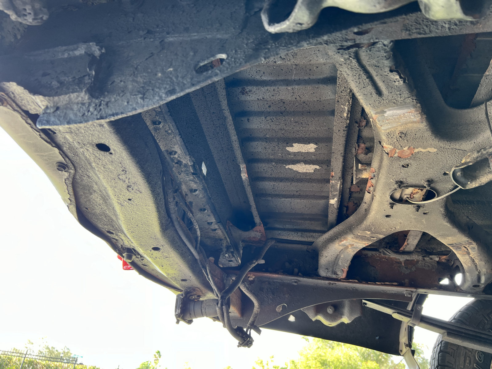

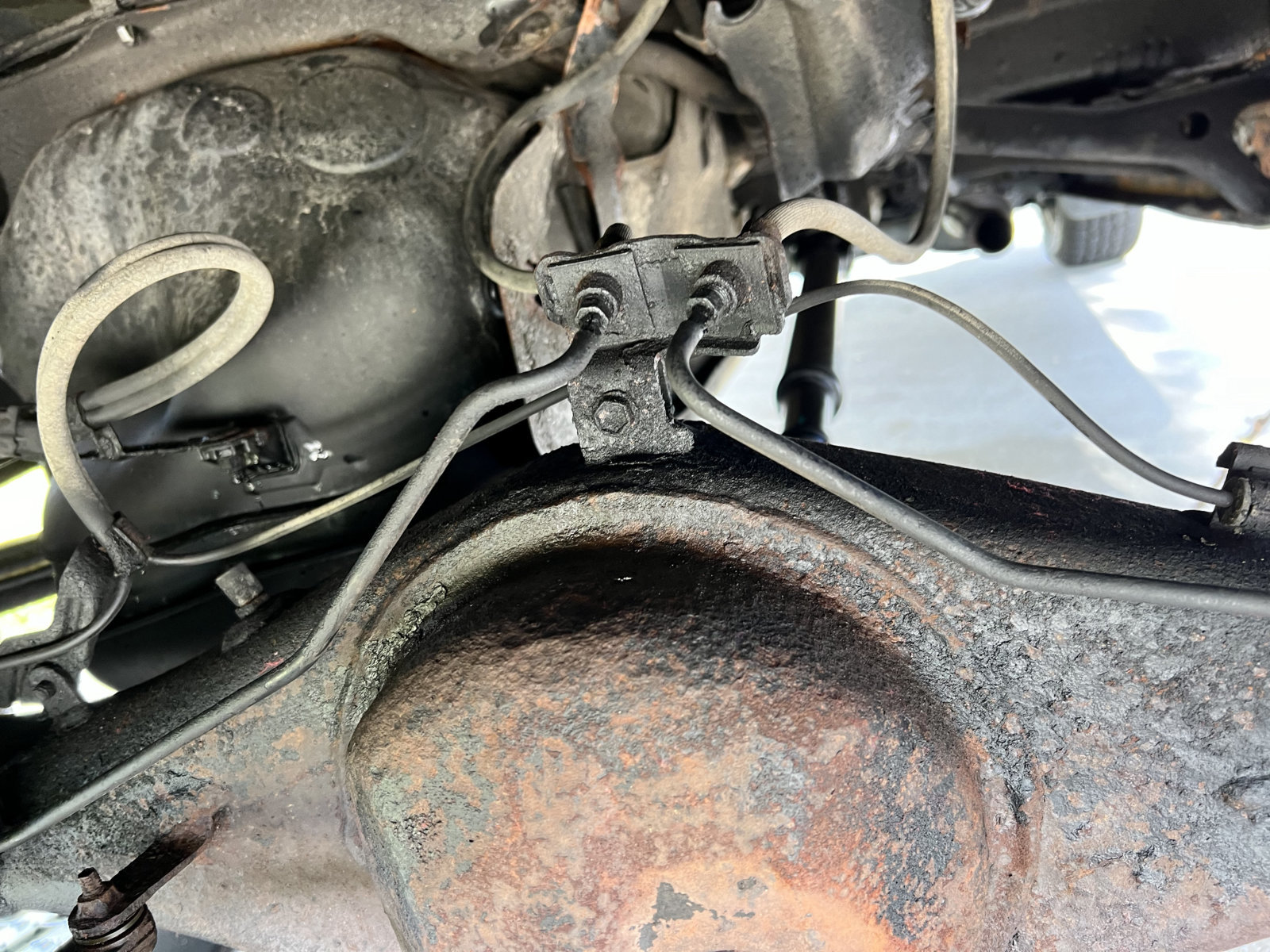

  14. Nov 29, 2023 at 4:44 PM
    #74
    Burgmane
    Burgmane [OP] New Member
    Nov 12, 2023
    #106850
    136
    Apollo Beach, FL
    2005 Limited DC 4WD
    Photos don’t really do it justice. It was wet and splattered everywhere on the drive yesterday. And like I said, took a quart easily. The drip is slow parked in the driveway so looking forward to draining it tomorrow or day after to see how much I really lost. Read there should be 3.8 quarts in there.
  15. Nov 29, 2023 at 4:48 PM

  18. Nov 29, 2023 at 10:48 PM
    #78
    whodatschrome
    whodatschrome New Member
    Sep 13, 2023
    #103882
    1,846
    North of North Plains, Oregon
    lots of dents
    The last pro tip is to drive the rear tires up a pair of ramps (if you got them). That extra 8” makes all the difference when laying on your side in a pool of oily water mixture.
    Burgmane[QUOTED][OP] and Mr.bee like this.
  19. Nov 30, 2023 at 2:48 AM
    #79
    w666
    w666 D. None of the above
    Dec 17, 2019
    #40020
    1,792
    Maryland
    04 Access Cab SR5 V8 4WD
    It looks like your sketchy seller may have gone to a lot of trouble to clean/paint the rear end, possibly to obscure a rust related leak. Also, check the mating surface where the 3 member meets the housing. Since he replaced the 3rd it may have been improperly sealed.
    Usually when the rear is blowing oil the first thing to check is the breather valve. Just go ahead and replace while you're under there (~ 12 bucks as I recall).
    Finally, did you replace the pinion seal when you replaced the flange?

  20. Nov 30, 2023 at 6:25 AM
    #80
    Burgmane
    Nov 12, 2023
    #106850
    136
    Apollo Beach, FL
    2005 Limited DC 4WD
    There's no question he coated everything in rust converter. I was well aware at purchase. Have thoroughly checked the front mating surface and there's no leaks up there. Also did not replace the pinion seal when we did the flange, it was clean with no leaks from that area and for all intents and purposes looked like it was replaced when he rebuilt rear end, so saw no need to pull it.
    I will definitely do breather valve, have seen recommended multiple times now.
    Now that we've chased all these gremlins down, the reverse diagnosis kind of makes sense. Northern truck, rust got to the rear diff housing and started leaking oil thru pinholes. Previous owner probably just ignored it, ran rear diff dry which nuked the gears. When that locked up at speed probably did all kinds of hell to the drive shaft, broke it. Truck goes to auction, shitty mechanic buys it to flip, installs 2004 rear end parts and buys 2005 drive shaft, drills 4 holes freehand in pinion flange to make it fit. Good 'nuff for short test drives around town, sells it to a moron (me), everything goes to shit within 200 miles and my life goes to hell for a month :rofl:
  21. Nov 30, 2023 at 6:29 AM
    #81
    w666
    Dec 17, 2019
    #40020
    1,792
    Maryland
    Maybe...pinhole leaks would just drip. Something is slinging it around. Pay particular attention tho the pinion area once you get it cleaned up. Just because the seal looked good doesn't mean it still is.
    bfunke and FrenchToasty like this.

  24. Nov 30, 2023 at 12:28 PM
    #84
    Burgmane
    Nov 12, 2023
    #106850
    136
    Apollo Beach, FL
    2005 Limited DC 4WD
    Took a break from work this afternoon, immediately grabbed the toilet brush out from the master bathroom and went to town on the diff. Engine degreaser and scrub job cleaned it up plenty. I'm almost disappointed in a weird way, the back cover looks way cleaner and less rusty than I thought it would be...some of the carnage that was still running ive seen on youtube and pics on here make mine look like childs play.
    No clear and obvious drips after drying for an hour. Will take for a short spin later to see if I can make some oil show up...but there is no clear/obvious penetration or pinhole to slap JB Weld on. There is obviously some sort of hack job/RTV/Gasket in a tube stuff between the front housing and main axle (sorry if I'm messing up terminology). When I feel around I'm not getting any obvious oil residue on my fingers, but it is just a bit slicker on that goopy dried seal deal. It would stand to reason the breather may be clogged and forcing lube out from the bottom of that, which sucks because slapping JB weld on the back of the pumpkin would have been easier than taking the drive shaft back off and the whole thing apart to re-do that seal.
    I would really like to be able to drive this truck 650 miles to hunt camp next week in Alabama. Not sure what I'll do if it's obvious the oil leak is coming from that RTV looking seal. I'll probably drain it and refill no matter what, if for nothing else than to verify how much lube is in there and how much I lost in my 1k miles of driving it (minus the quart I dumped in there).
    Oil spray on spare
    Degreaser on rear
    Cleaned rear pics
