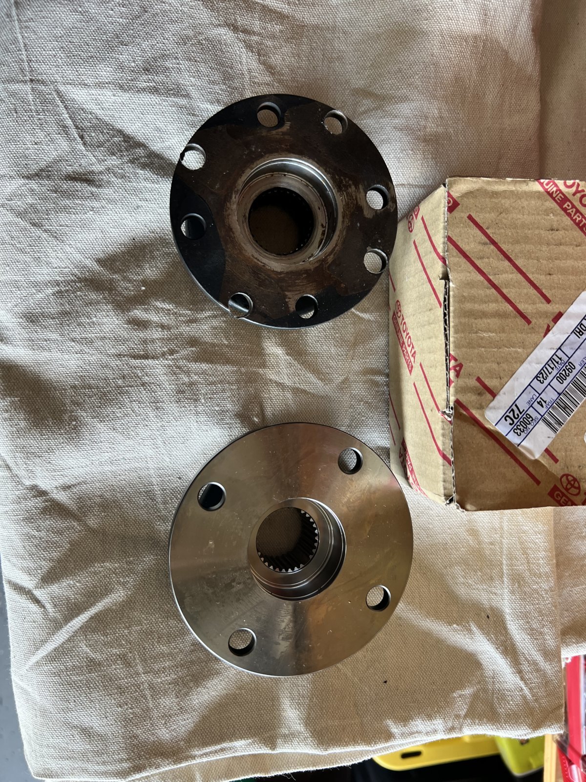

    I guess I'm wondering now, how'd your mechanic miss that one?

    lots of dents
    I can only thing i can think is that the yoke ears overhang out past the companion flange, and therefore the redrilled hole location couldn’t be easily seen.

    I swapped in a Ford 8.8 axle in the back of my YJ a while ago. Turned out my existing driveshaft had a different sized adapter yoke on the end of it (1310 u joint). I swapped on a 1330 yoke and all was good.

    is that black paint on the flange or had that driveshaft been on there that long?

    Yeah giving them the benefit of the doubt on this one. He should have caught it but it’s tight up there and the overhang from the yoke made it tough to see. You’d have to be looking specifically for it to see it, and I think that falls outside of the normal scope of a pre purchase inspection. Hell I removed the driveshaft myself and didn’t see it until after I had it off and pinion flange was exposed.
    Local Toyota dealership had 66mm companion/pinion flange for $120 after tax. Per some posts here all 3rd members for gen 1 have same spline count back there so should bolt up no problem. Videos of removal/installation look pretty straightforward of guys replacing pinion seals.
    So this idiot butchered a pinion flange, wrecked a bunch of new parts, and could have killed me/my family to save $120. Balza Motors Bradenton FL, avoid like the plague. Unbelievable.

    Black paint. He coated everything in rust prevent stuff.

    You should still confirm front and rear gear ratios match before putting any labor in this 3rd member.

    New 66mm pinion flange is in. Splines are identical and checked sizing with calipers, should bolt right up. New drive shaft supposed to arrive tomorrow. Will keep all posted after install.
