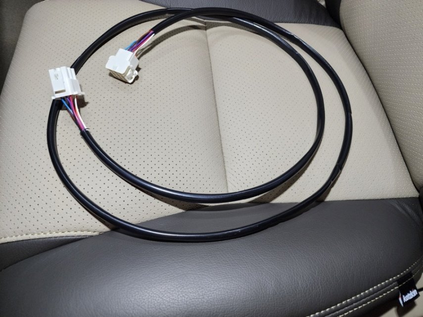

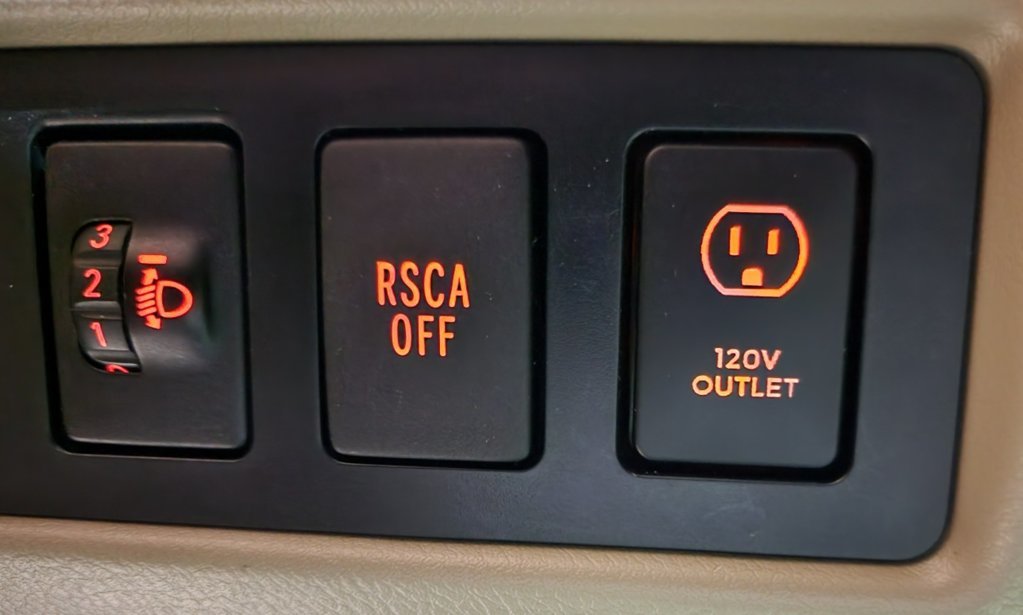

    Where did you make the connections for the headlight adjuster? Sorry if I missed it.
    Also for the dash piece, from what I’ve found you need to source the trim from a double cab with the power slider rear window for the headlight adjuster to fit flush. I have the switch already but can’t make mine sit flush at all, 08 problems

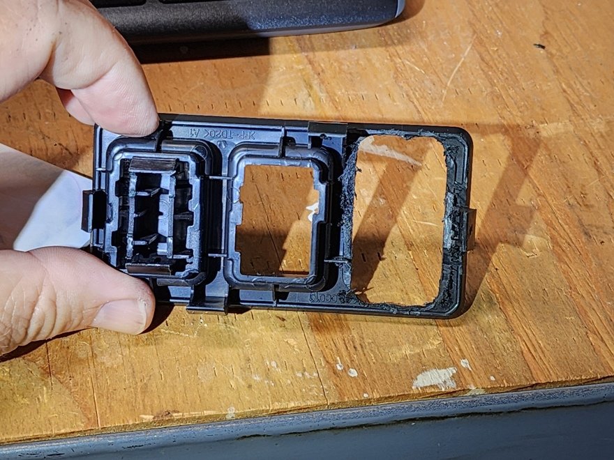

    I did not cover attaching power in the video. I used one of the adjacent dash controls (either RSCA or the bed light switch... I think the bed light switch) to get power. The way the connector on the Ebay cable is wired, they hard wire Ilum+ to +V and Ilum- to ground. If you hook it up like this, the backlight will be full brightness all the time. I cut Ilum- loose from the Ebay connector and tied it to the Ilum- of the adjacent control. I did not have to do anything with Ilum+.
    I am picky, but it didn't bother me to have the tilt adjust switch sit 1-2mm recessed. Besides buying a different lower dash piece, I imagine the inside edge of the added control switch could be built up with material and perhaps some Dremel action behind the dash so the control clips spring out without being quite as far in.

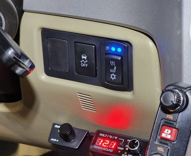

    AC Inverter dash on/off switch
    When I installed my 1000W AC inverter, I shoved the remote panel it came with off to the side under the center dash. I wanted to find a switch that had an inverter/AC related symbol, matched the adjacent dash controls, and popped right into an unused position. The one I found on Amazon works well so far. They have two option and the "newer Toyota model" version matched my measured dimensions best. https://www.amazon.com/dp/B09XTNHVL9 I had to cut apart my inverter remote-mount panel to get to the wires. I wired it so "120V Outlet" is lit anytime the other switches are lit. When I push the button to turn on the inverter, the AC outlet symbol lights up to let you know it is on.

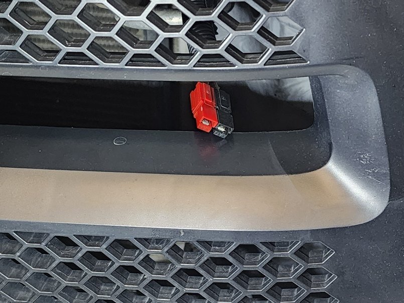

    Battery charging port
    I am often messing around in my truck with the radio on so I added an easy to get to charging port so I don't have to lift my hood each time and clamp on to the battery terminals. Fused it close to the + battery terminal with a 15A fuse and used Anderson Power Poles right behind the grille. The wires are protected in split loom tubing. I am going to find something to fit over the ends of the power poles even though it doesn't rain here much. I put another set of power poles on my 10A charger so I can just plug it into the truck and plug the charger into AC. After I am done charging, I push the wires down and it hides behind the grille.
