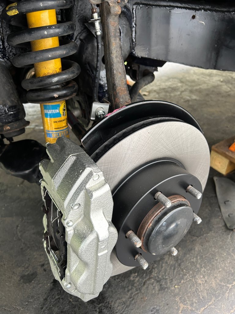

    I have new calipers and hoses that have been laying around for a couple months because I just didn't feel like opening the brake lines...now I have no excuse.

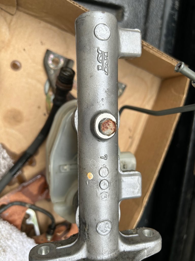

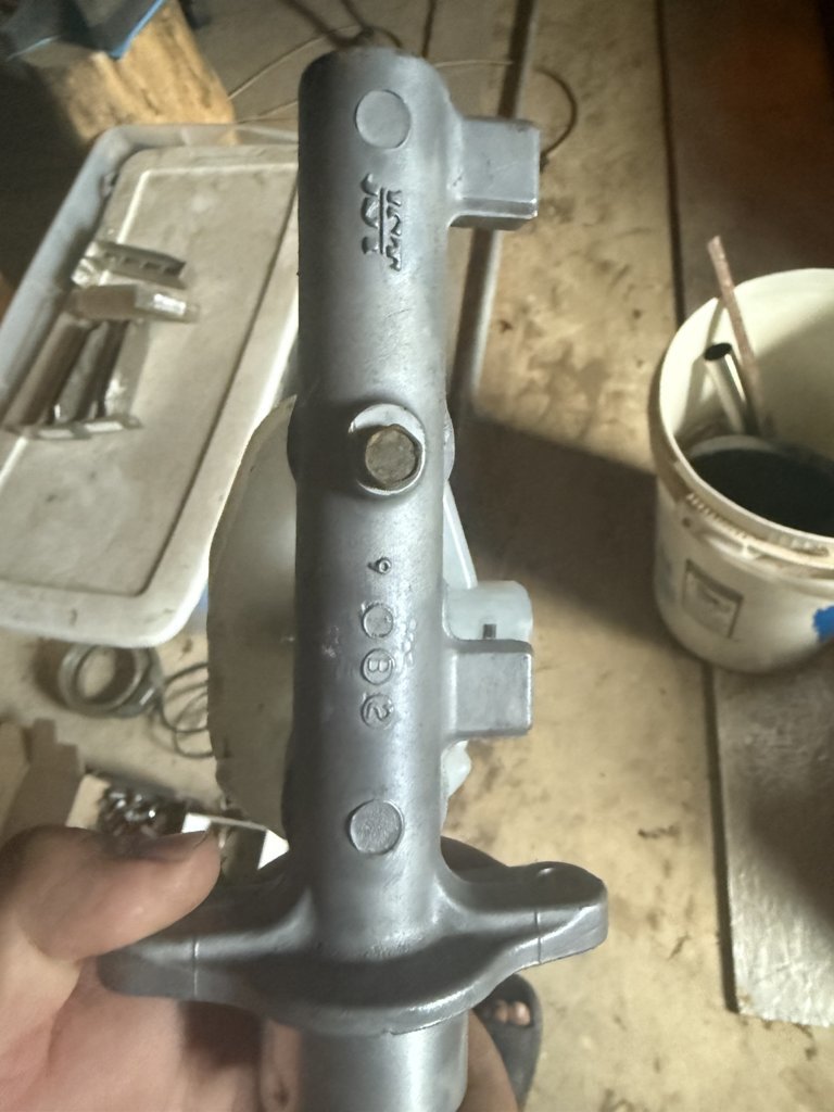

    Hmmm...I wonder if this is an OEM Master Cylinder?

    I got rid of mine so I don't have pictures of the markings on the bottom to compare. I do have this picture and it was definitely stamped Aisin 3/4". Yours might be smaller than 3/4" since AC, I can't remember off the top of my head.
    Do you have that slave cylinder thingy in-between the MC and booster?

    Does it have Aisin or a size stamped on the side?

    Mine says only 13/16" on the top side.

    Gotcha, thanks. I couldn't remember the size difference on them between AC and DC.
    My Sequoia MC is stamped 15/16".

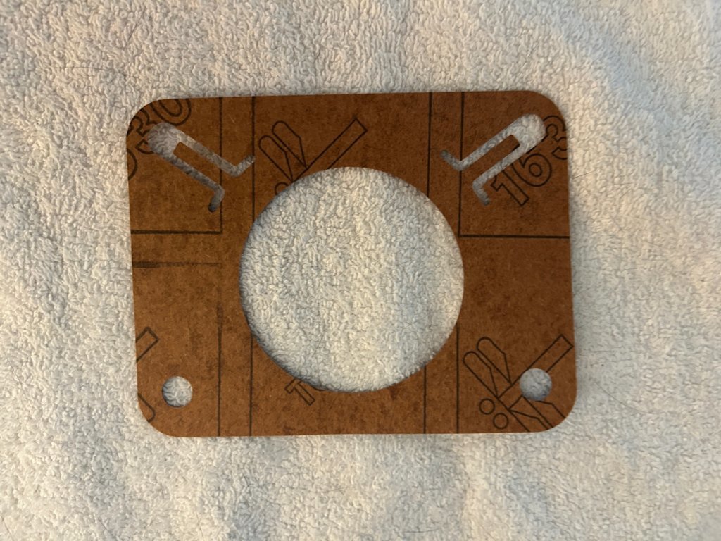

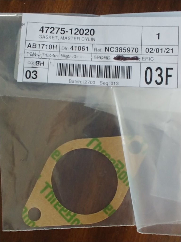

    The gasket between the booster and the firewall clearly has an "up" and a "down"...does anyone know which is which?

    Oops, never mind...I found it. Now the $64 question is why?

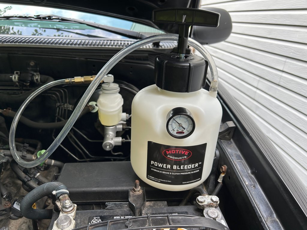

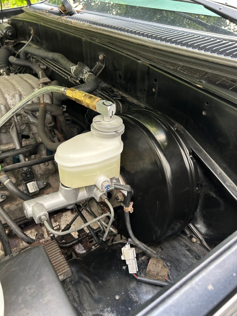

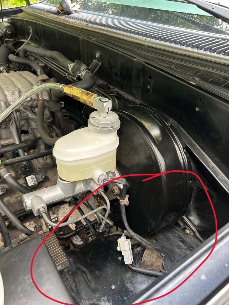

    Lots of shiny new brake parts! I'm using the Motive system "dry". It seems to be OK, but I've had to do it several times to get all the air out. Yes, I bench bled the new Master Cylinder first. Still a bit spongy...I'll go at it again after early tomorrow morning when it's not so hot (now I know why we measure temperature in degrees "F"!!!).

    #40572
    14,524
    Arkansas
    UH, where's all your evap shit??
  21. Jul 12, 2025 at 8:42 AM
    shifty`
    shifty` We call it “riding the gravy train”
    Jun 20, 2020
    #48239
    29,985
    ATL
    '06 AC Limited V8/4WD
    2004. Pretty sure EVAP can in that loc was only a 2000-2001 thing. Maybe thru 2002?
  22. Jul 12, 2025 at 8:44 AM
    KNABORES
    KNABORES Sarcasm incoming
    Jan 1, 2020
    #40572
    14,524
    Arkansas
    Really. So much room for activities then!!
