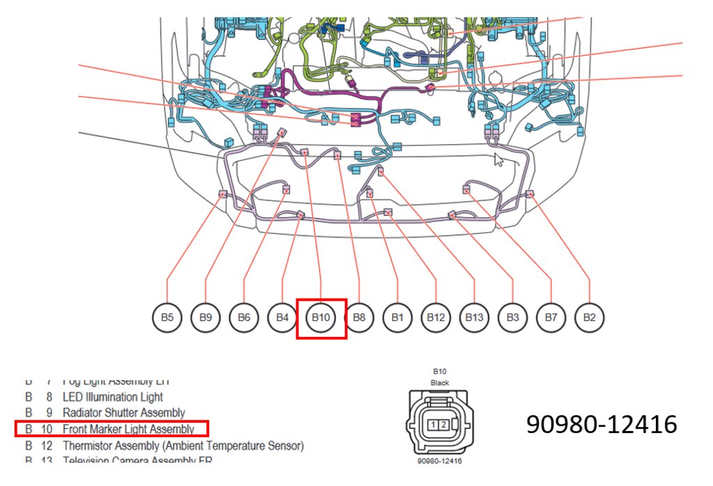

    Old thread - but I looked for this for a while and finally found it. Here is the part number you need if you want to make your own harness to plug into the factory raptor grille marker lights. 90980-12416
