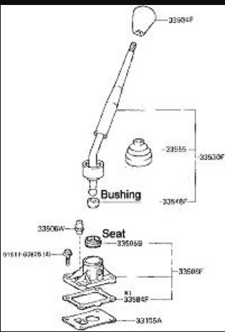

    How's your stick shift feel otherwise? Sloppy/floppy, or pretty tight? My Tacoma never needed it, so maybe Toyota finally upgraded that part, but on all my previous Toyota pickups, replacing the plastic bushing that sits at the seat of the stick shift made the transmission feel like new. They get thin, brittle, crack into pieces.

    Shifting feels tighter in the cold temps. Especially 2nd gear until it warms up then feels like before. I'm not familiar with the plastic bushing you mentioned. I'll have to look it up to see if my year has it.

    Seat and bushing. I'd guess you have them, but that doesn't mean they're worn out. Pretty easy to check.

    If you're replacing those, consider getting marlin crawler upgraded ones.

    I replaced those on my Tacoma that I had. They were basically worn to nothing. It made such a crazy difference and I had wished I knew about it sooner. In third gear you could shake the shifter like it was in neutral.

    Yep. In older pickups it made my transmission feel like new. Not sure why the Tacoma's were fine even at really high mileage, but in previous trucks it took the transmission from feeling completely sloppy, to really tight. World of difference.

    I had several older Toyota PUs and replacing the seat and bushing really improved shifting if they were worn.
