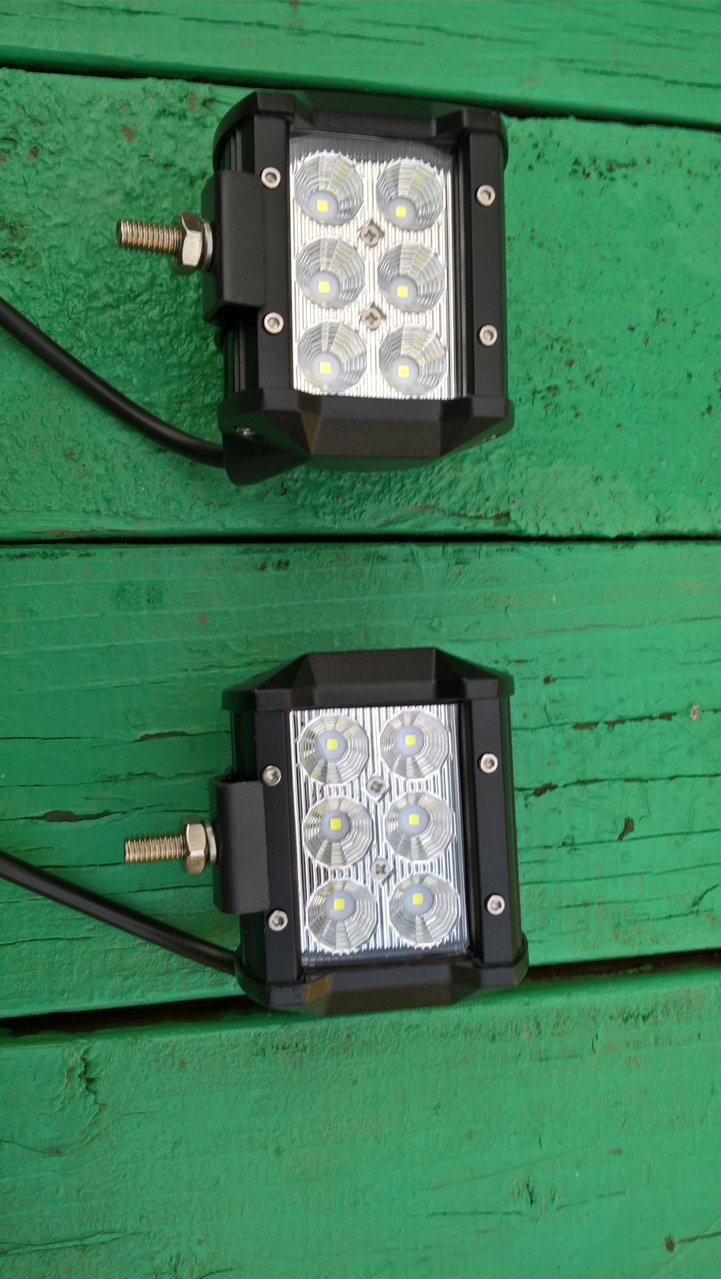

    Turns out all four are Spot beam. Solves that. Three mounted.....300W of old school KC goodness. And a spare...;)

    Dang...forgot I bought these. 60 degree 24 watters I think. Not a big deal but might as well use them too. Guess I need to look for more goodies in my storage unit.

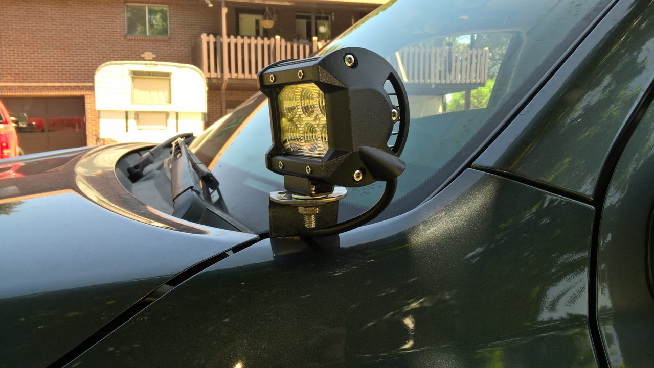

    There are some decent ditch light brackets out there but....$60 to $75 plus shipping???? I realized that my CB antenna hood channel mount would be perfect. My Firestik antenna is over 3.5 ft. Antenna barely moves off roading unless I hit a branch. Very beefy rigid stainless steel mounts. So....I just ordered a pair of Firestik hood channel mounts. Easy to adapt. I can place them anywhere along the hood channel and....the wiring will not get pinched. My CB antenna cable is doing just fine after 2+ years with zero chaffing. Free Super Fast White Tundra delivery via Amazon Prime!! $25.18 for the pair!
    [​IMG]USA made too!

    Well....I tested my theory. Firestik hood mounts work just fine. Utilized my existing Firestik CB hood mount. Ordered a pair. Ditch light mounts for $26! Saved $50. $$$ I can use for something else.....

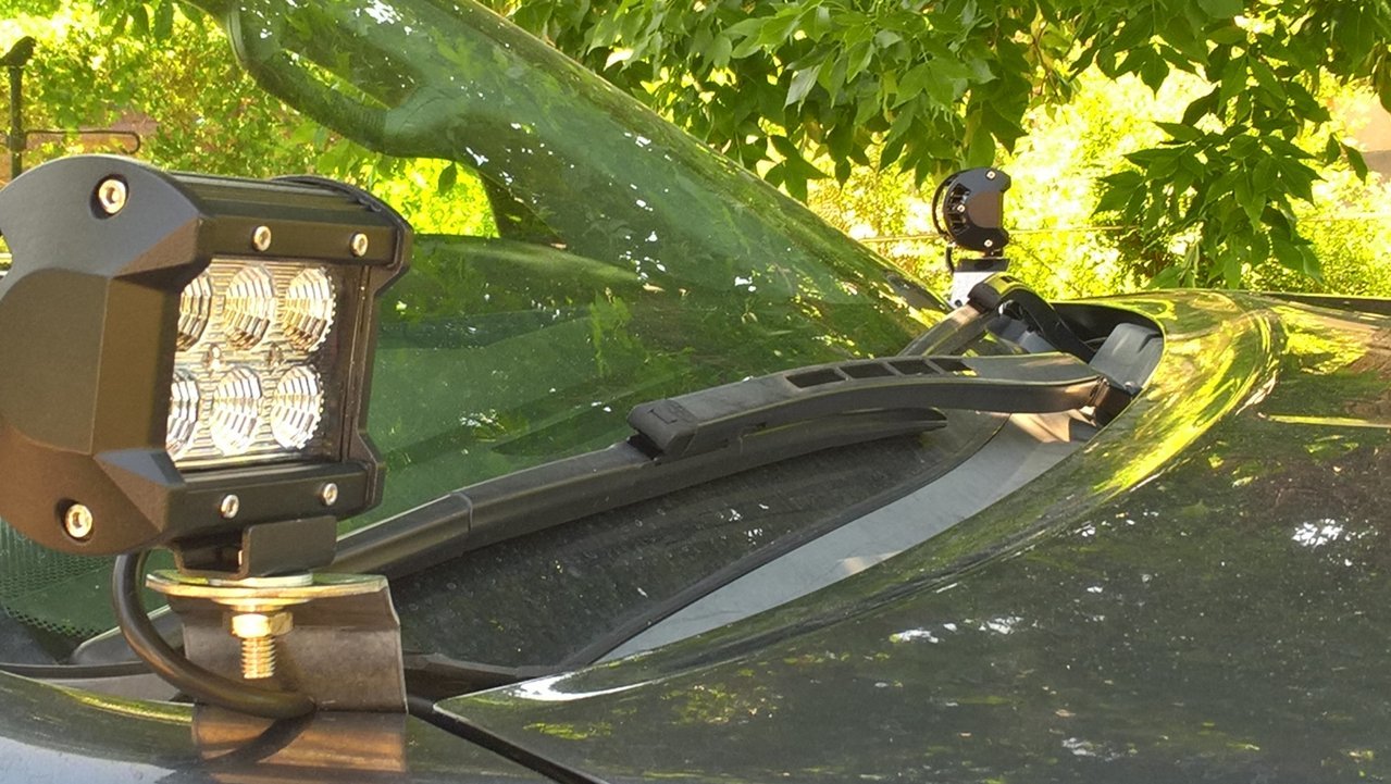

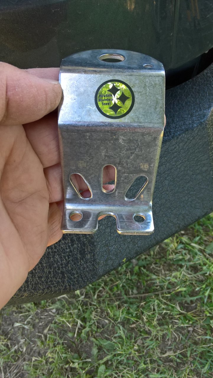

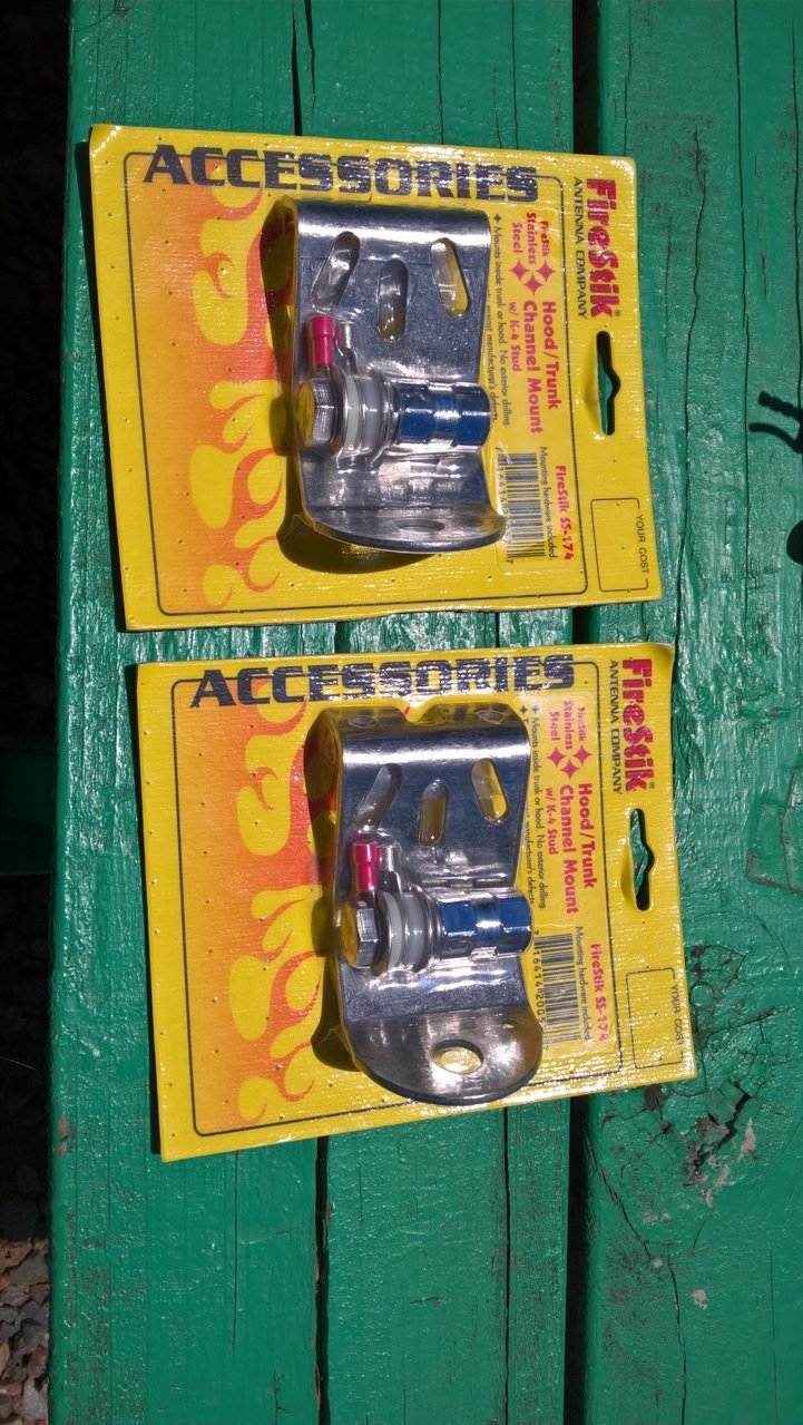

  21. Jun 2, 2018 at 12:14 PM
    #1581
    Black Wolf [OP] Chillin' in Alamosa
    43,186

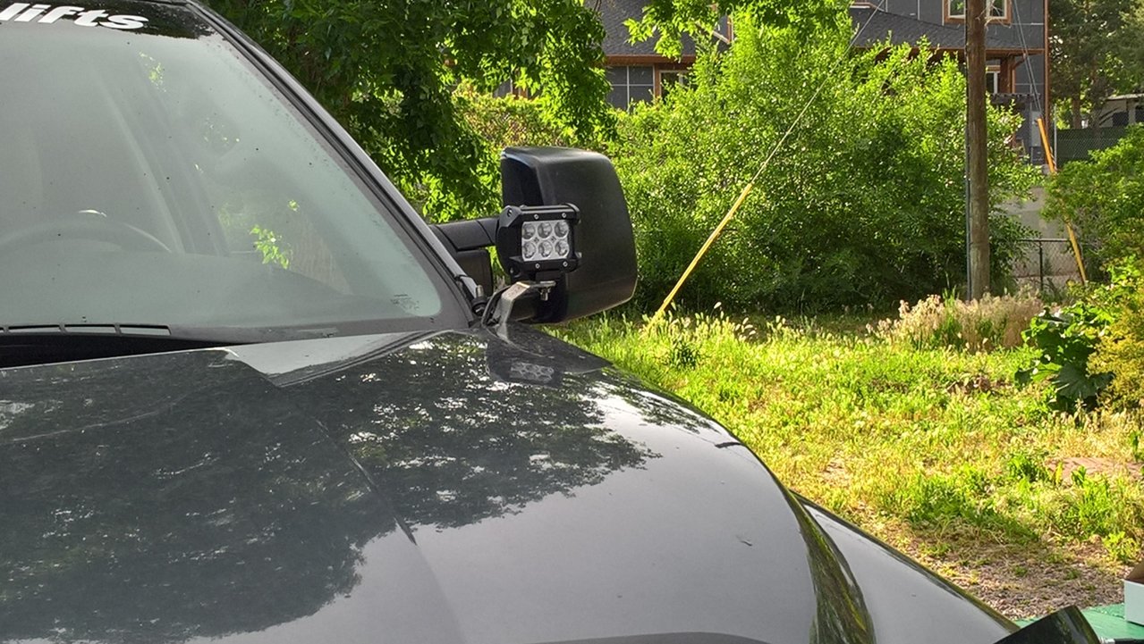

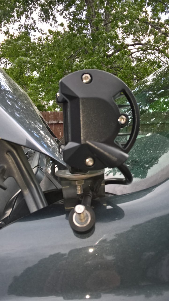

    Just got Firestik CB hood mounts which in a few minutes (after some vise/bending work) will become my ditch light brackets. Very beefy. less than $25 for the pair. beats paying $75......I think COMiamifan dropped them off but got away so fast i couldn't take a pic. Those white tunnys are fast!!!!!!
    Grumpy Uncle likes this.

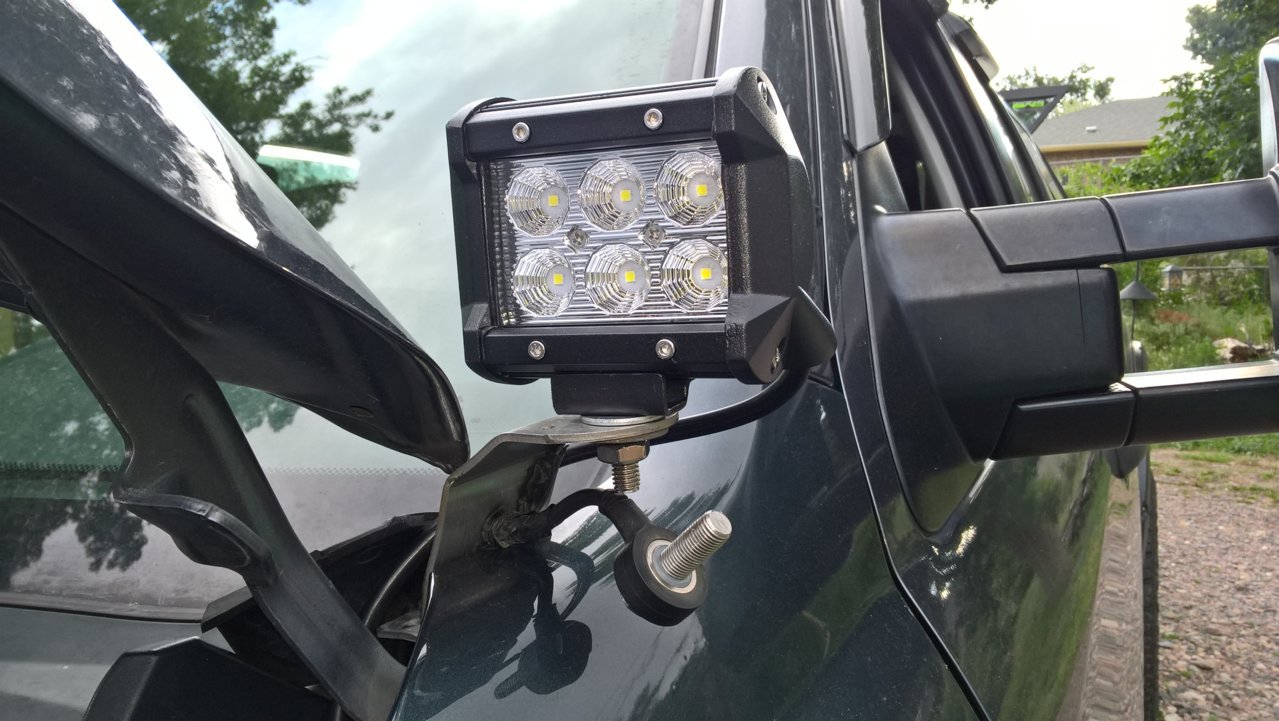

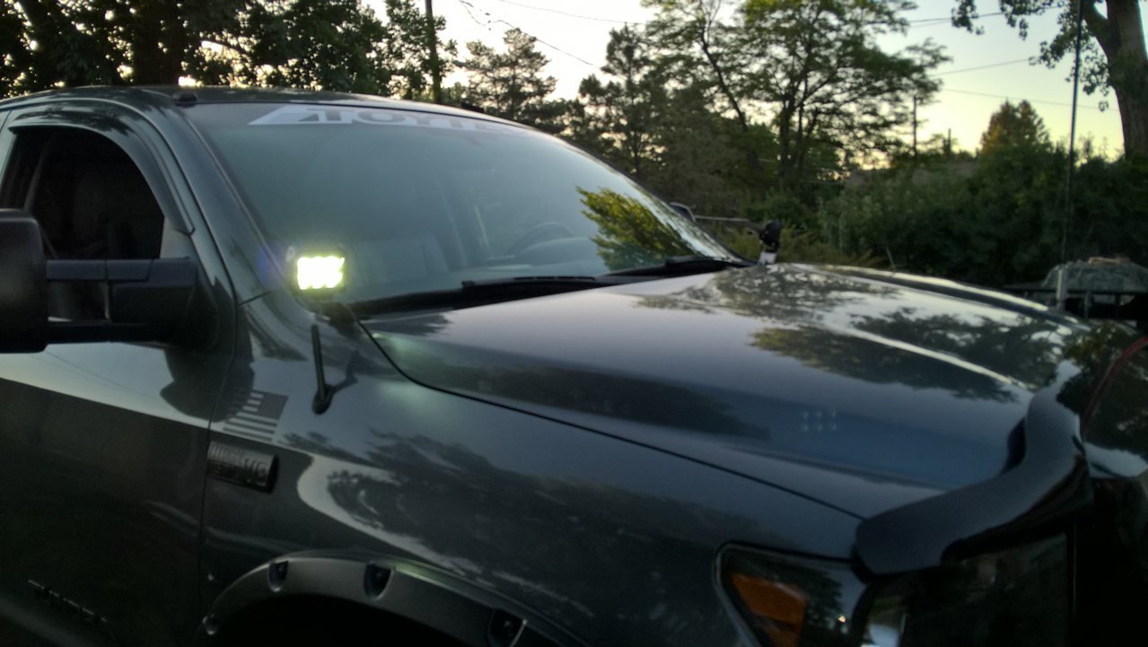

  22. Jun 2, 2018 at 1:03 PM
    #1582
    43,186

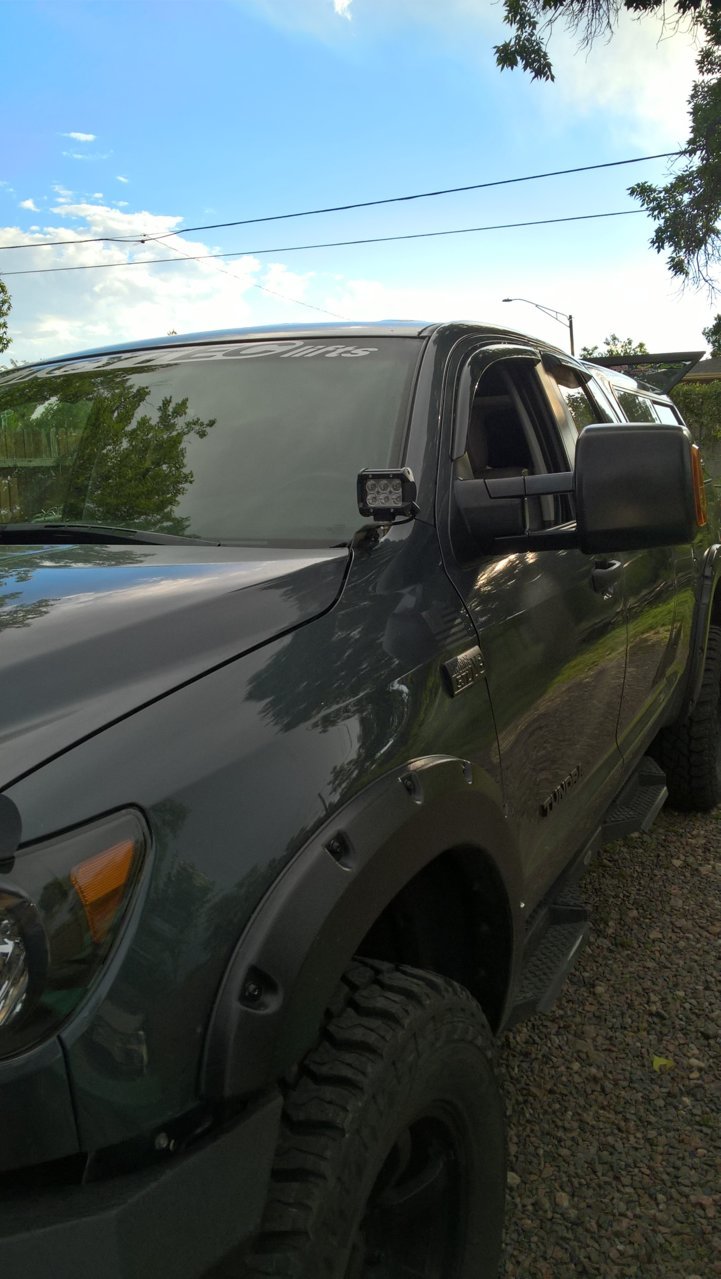

    Got one on..........
    Coolhardy and zcarpenter92 like this.
  23. Jun 2, 2018 at 1:42 PM
    #1583
    43,186
    Done for now. Just need to wire them up later today. The easy part. The $50 I saved will shave off $50 towards my RCI gas tank skid!

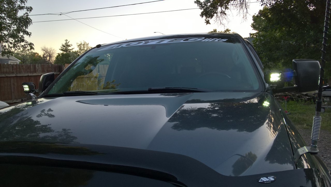

  25. Jun 2, 2018 at 7:25 PM
    #1585
    43,186

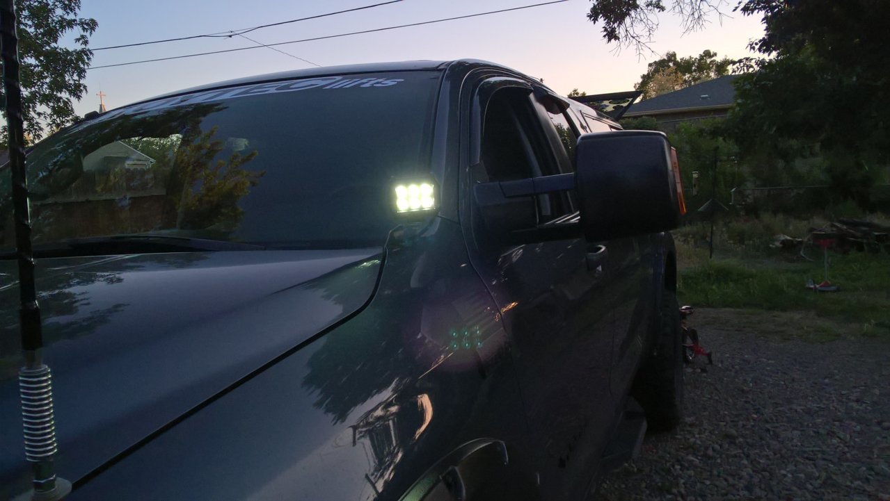

    Wired!!!
