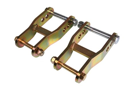

    It must be pretty boring out there in NE CO. Joking of course Zach. I'm going to blatently copy,rip off Brian, (@csuviper). I really liked the new ToyTec shackles that he installed on his RWarrior. They appear to be superior compared to what is out there as far as material/build quality and they are on sale. +Tundras.com discount. My boss was kind enough to let me get off early tomorrow so I can drive up to ToyTec and pick up the new shackles (with lower bushings). I should be able to get them installed (with a "little" help from my son) by tomorrow afternoon. I've had shackles on my "need to get" list. Glad I waited. I need about 3/4" inch to restore some decent rake. A little rake doesn't hurt, especially if you load up your truck/tow occasionally. I really hate the low sag look with only 200lbs in the rear. These shackles will give you a minimum of 1" which is fine. Thanks to Brian...:thumbsup::thumbsup::thumbsup::thumbsup:
    (Oh, It didn't hurt that our calibration services division did quite well "year over year". BONUS!!)
    shack.jpg W/ Grade 8 Hardware.

    Well, I just got back from ToyTec. Thanks to David at ToyTec for all the help and Brian for the inspiration..heh...heh. Got me some swag. Total for Shackles, bushings, and D shackle (including Tundras.com discount) was $174. Not bad at all.

    Matt I'm shocked those are not greaseable ones..
  19. May 20, 2016 at 1:50 PM
    #589
    Black Wolf [OP] Chillin' in Alamosa
    43,313
    I'm not too concerned at all. Not a big deal to me.The bushings are high quality. Hardware is grade 8. Shackles are zinc plated. My OEM shackles aren't greasable either, 9 years old, never squeaked and OEM bushings/fasteners don't really show any wear or rust at all. I could order a greasable bushing set if I really thought I needed them but I don't. Not much humidity or mud bogs at this altitude. Not to mention a few shots of Permatex silicon spray lubricant that I do every so often doesn't hurt. Takes a couple of seconds. I use it on my leafs too with positive results so far. It's all good. I might add the poly bushings ToyTec sells look indentical to the ones supplied with CB's.

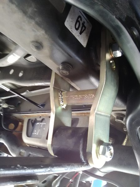

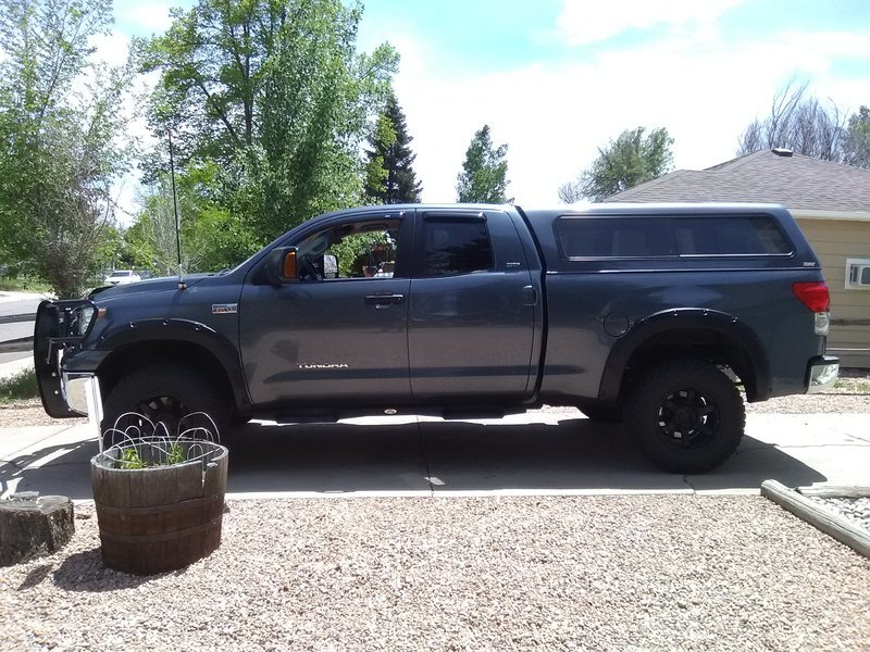

    Shackles installed. 3.5 HRs (I'm old). Main thing is to setup rear on jack stands. Use a floor jack to raise/lower pumpkin to desired level to take tension off shackles. Once the OEM's are off, use floor jack to lower pumpkin to desired spacing for new shackles. Bolt on, torque to 90 ft lbs, drink beer. (notice the total lack of rust, other than some surface rust on back of chrome bumper? 9 yrs old, dry climate)
    Gained 1" inch as advertised at 1" setting. I now have more clearance and restored some rake. Perfect for me. All is good. Test drive was good. All ready for next weekend. Medano Pass. Maybe.

    Good work Matt. Looks good. Took up the sag from the weight of the topper. How was pressing out the bushings?
  30. May 21, 2016 at 9:03 PM
    #600
    43,313
    PB Blaster again. Sprayed both and after about 20 minutes or so I was able to use my ball peen to knock them out. Wasn't too pretty but worked. Don't really care to do it again. Once you start you have to figure out how to complete.. Crazy, but passenger shackle /bushings were fairly easy to remove. The driver side almost gave me a stroke. The passenger side OEM shackle bolts and the top bolt on the drivers side OEM shackle still had the white anti seize on the threads, at 9 yrs. Unfortunately the drivers lower was froze/rusted to the bushing bolt guide (?) . That was another half hour of dicking around getting that resolved.Go figure...:censored: No doubt this would be easier on a new Tundra.
