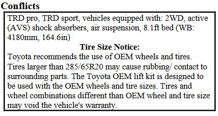

    In the document for the TRD Lift it states tire size under the Conflicts section:

    makes sense to me.

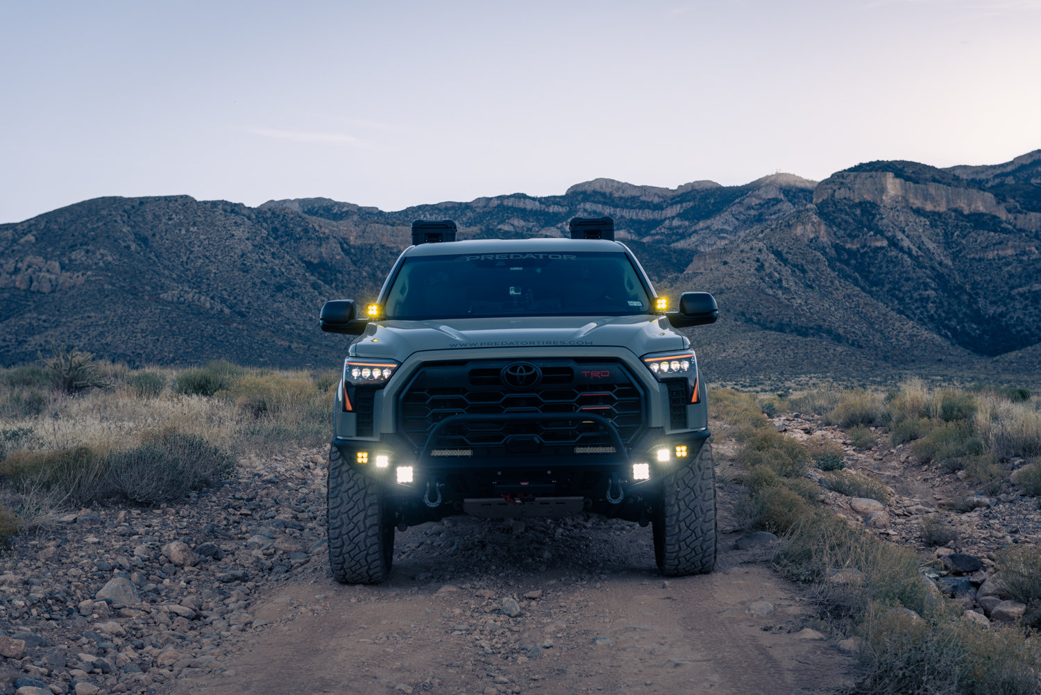

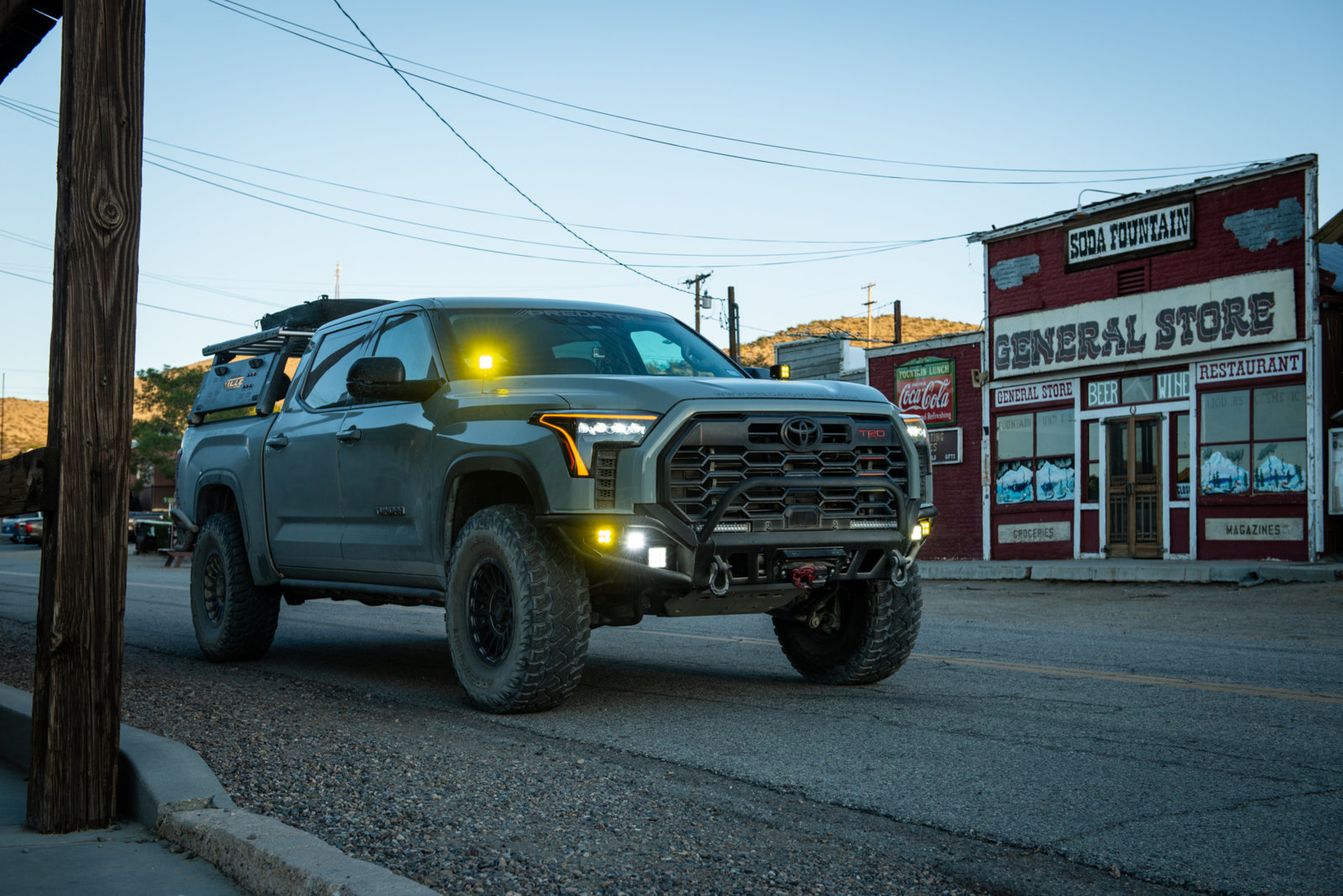

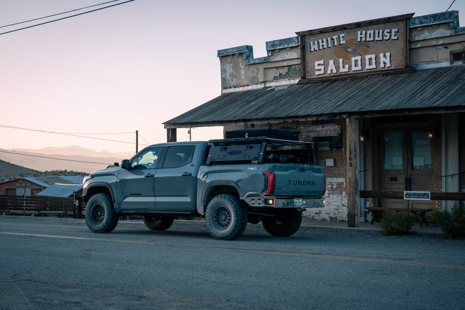

    Currently running 17X8.5 +25 offset wheels wrapped in 37X12.50R17 tires. The truck is lifted using ICON Stage 6 3.5" suspension lift. Zero rubbing whatsoever, even when driving on the trails. Prior to switching my tires and wheels, I was running a set of 20X9 0 offset wheels and it would rub when I'm turning and the front suspension has to articulate. The scrub radius when using a +25 offset wheel eliminated all the rubbing problems I was having. The stance isn't as nice as a 0-offset. The +25 only pokes out about less than a half inch. I do think a slightly more aggressive +12 offset might not cause any rubbing problems, but if you want to play it safe, then go with a +20 or +25.

    Wheel/tire combo looks nice. 1/2" poke at most is perfect IMO.
