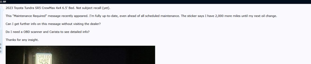

    I'm just looking to read some data from the truck. Is it so wrong to ask how to retrieve some data from vehicle's extensive on-board computer systems? It can be done for a lot of different circumstances. I was only wondering if I could use it to retrieve more information in this circumstance.
    sample answer: no, the OBD2 data will not specify what specifically triggered the "Maintenance Required" message
    sample answer: (from @Florida AF ) go the the service menu and there will be a red indicator next to the condition that triggered it
    sample answer: yest, Carista paired with the OBD2 will give you extended information in this circumstance.
    I quoted you to make it clear that I understand that the message can be dismissed but that you didn't answer the actual question.
    Good luck to you too!

    OP - you answered your own question in the first post. Since you did the maintenance “early” the light wouldn’t have been on when the maintenance was performed. Because the light wasn’t on - it wasn’t reset. It’s now been 5,000 miles since it was reset so it’s on. The truck doesn’t know you are only half way through the life of the oil change. All it knows is after 5,000 miles to turn that light on and repeat once it’s reset. It’s really that simple.

    OP, the simple answer is, there his NO DATA to be retrieved from the maintenance messages. They are simply triggered by mileage from the last reset.
