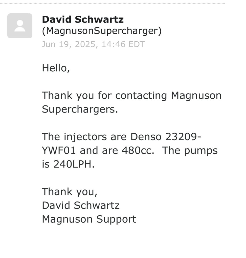

    Pretty old post, but I happened to be reading through it today and it's worth while mentioning that for the 2650 kit, Magnuson is supplying 480cc Denso injectors, not 535cc. Not sure why they chose to donwsize from the original TRD 1900 pump, but kind of annoying that they have been choked down even more!
    This information is coming direct from Magnuson when my current tuner contacted them to get information on my injectors and fuel pump.

    Damn, they really don't want anyone exceeding the stock output. No warranty with bigger pulley. Bare minimum fuel pump. Now bare minimum injectors! Lame. Makes it seem like they don't have faith in their own product lol

    Stock injectors are reported to be 42lbs which equals 440cc. What's the point???

    That's what I was thinking, 535 already wasn't a big step up, 480s are insane, not even a 10% increase? That seems weird, so weird I question what their rep said.

    Agreed but it was through email and he forwarded the response to me. Said Denso 480cc injectors and 240lph pump...

    The more I think about this, the more I'm convinced they gave the wrong information and what concerns me is my tune is being written with this in mind.
    From the 1900 to the 2650, including the 2650 upgrade kit, the tunes are all the same so no way they changed to smaller injectors.
