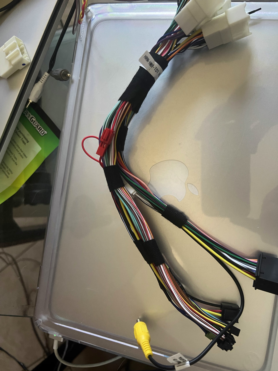

    Got the new harness, don't see a resistor, where is it?

    Follow the red wire from the ODB connector, under the tape, you should see a wire with heat shrink that bridges into the red power wire from the main harness. The resistor is in that bridge wire under the heat shrink.
