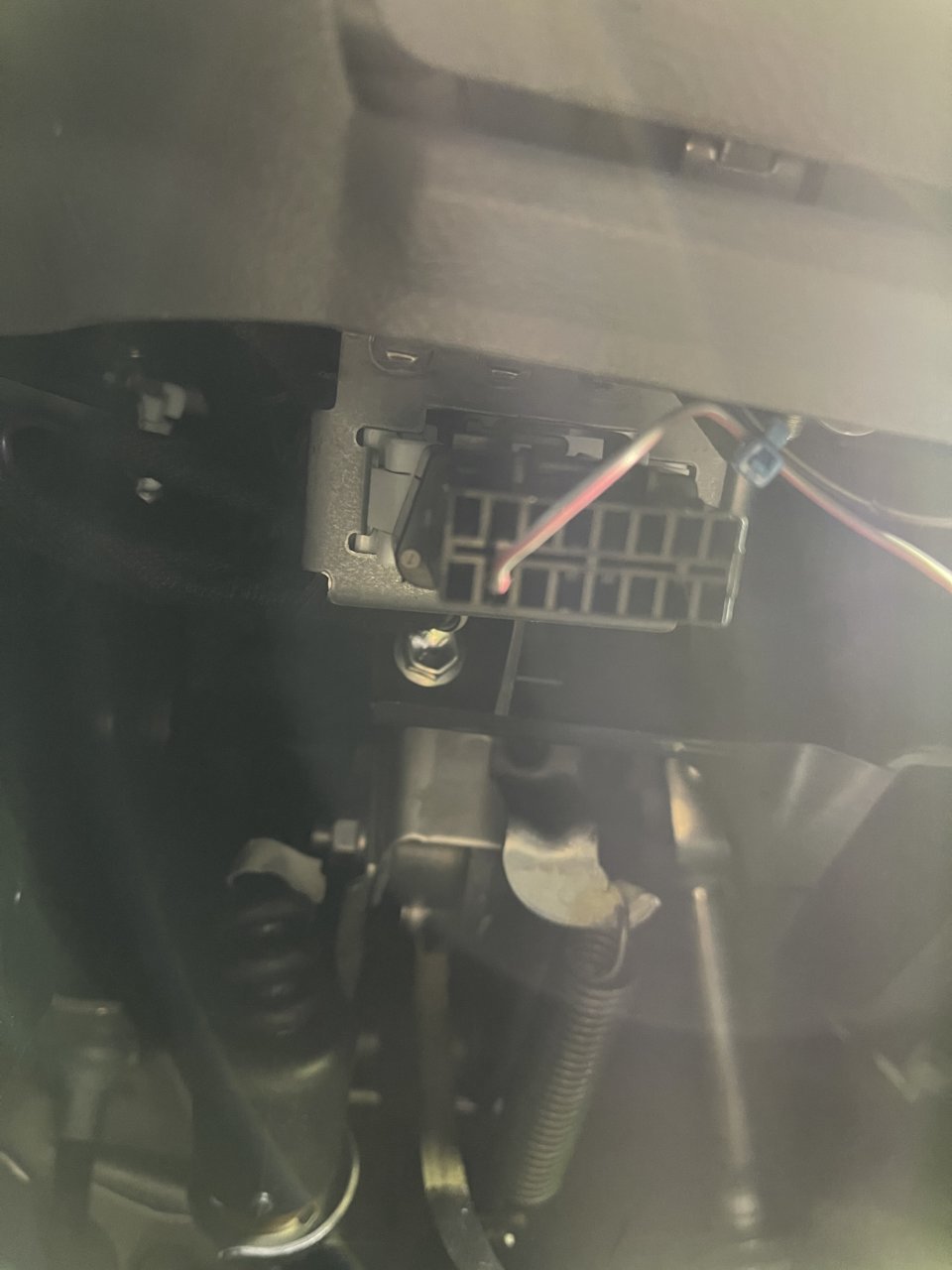

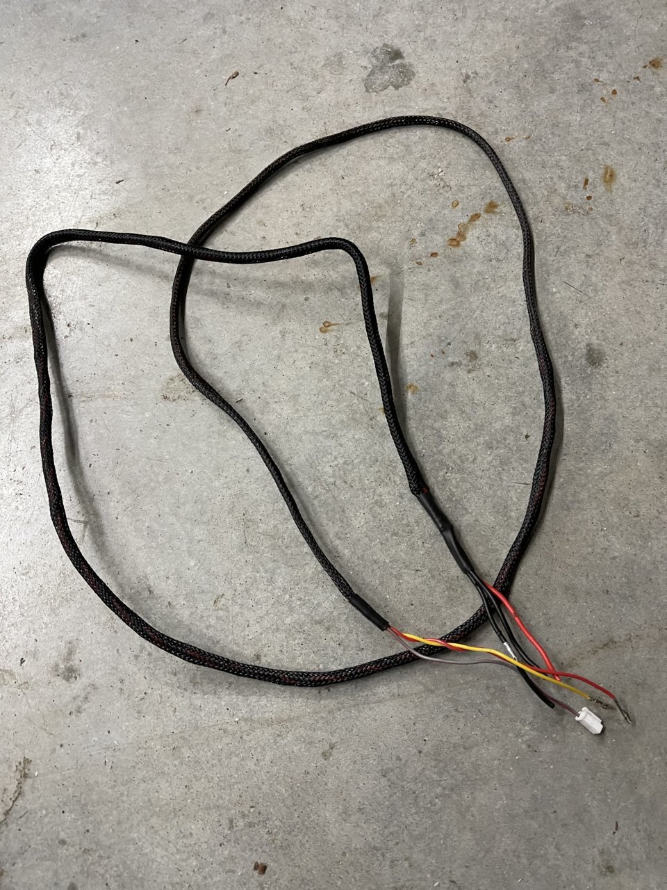

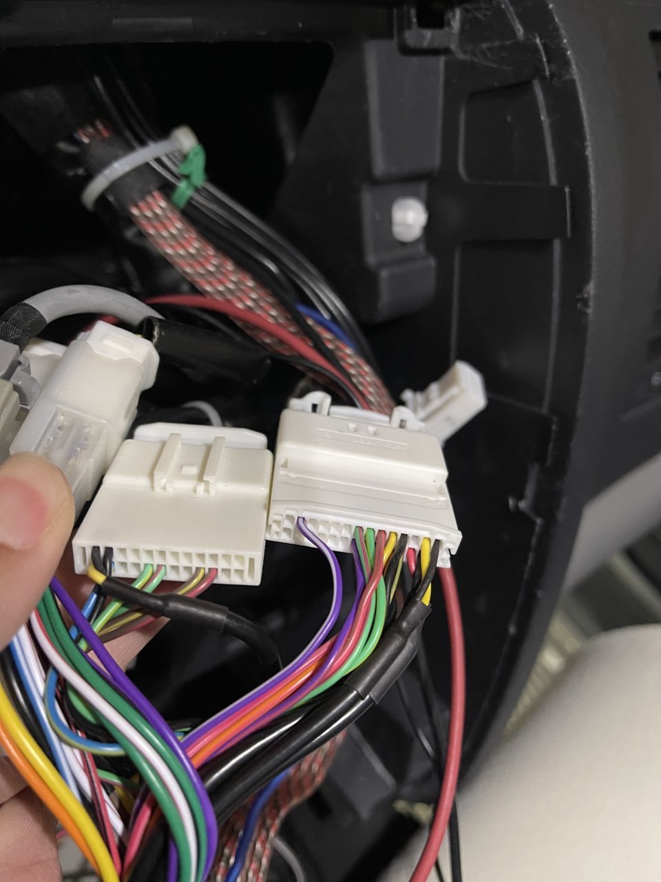

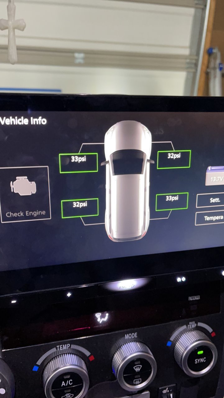

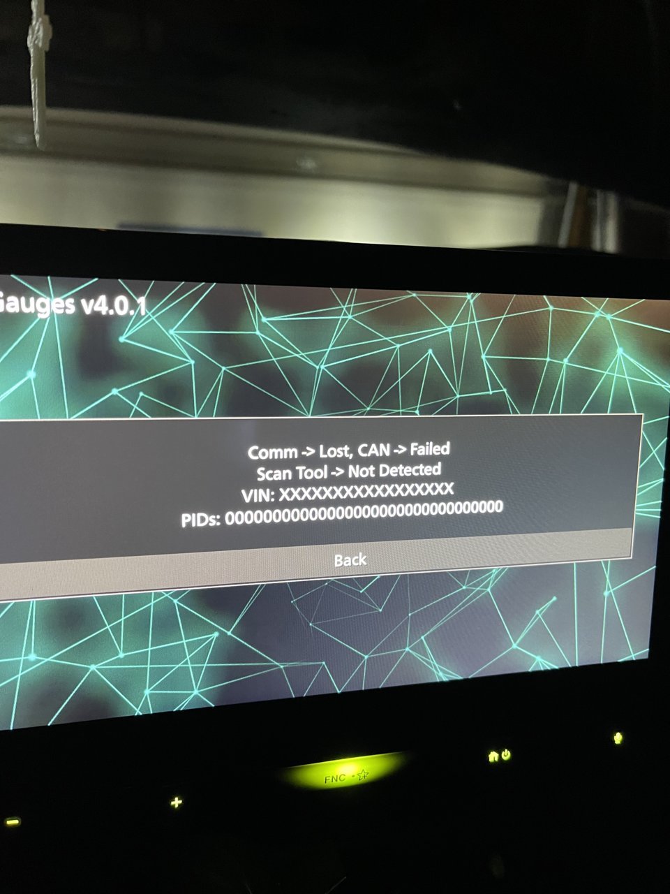

    580FED23-69F6-48A3-B225-7043FC94FFDD.jpg BDAE61A6-F367-49EE-81C8-70D9DE96E9A7.jpg E0CCBDDE-3C3B-4F09-8B39-1D5301B63DCE.jpg
    Any update?
    i have a backward issue on my setup. I have tpms reading but nothing else. Even after i set obd2 communication to Always Enable in the maestro menu.
    Not sure what’s going on here.
  5. Jan 6, 2022 at 12:06 PM
    #35
    BrandonL812
    BrandonL812 New Member
    Aug 5, 2018
    #17783
    1,508
    Brandon
    2021 Tundra Platinum
    DD ss3 max led fogs. interior and exterior leds swapTRD Shift knob.
    Update:
    i figured it out. Got everything working now.
    Had to run 2 extra wires from the 28pins of the TO2 harness to the factory obd2 port.
    on the 28pins of the TO2 harness, there is a Solid Red with brown and Solid Yellow with Brown. These are the CAN High and CAN low data. On the factory obd2 plug it is Pin 6 and Pin 14.
    The Red/brown from TO2 harness will need to tap into Pin 6 of the obd2 plug.
    The Yellow/brow from TO2 harness to Pin 14.
    You should have Pin 7 occupied with the Grey/Red wire from TO2 harness and obd2 plugged in.

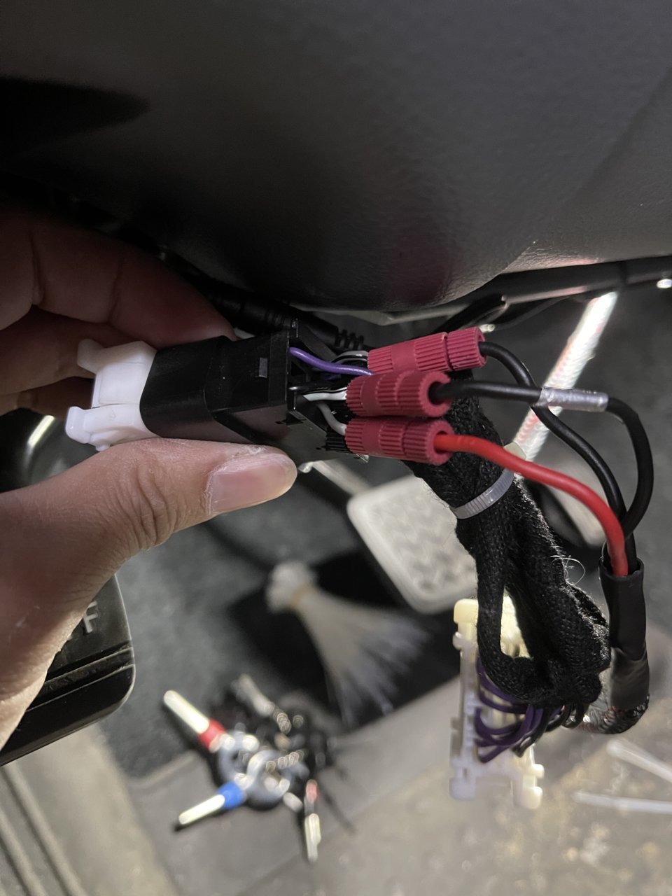

    0AFF3679-F559-4058-8335-B52963AAEE37.jpg 0DAA53E8-DACF-4B41-94F5-802B9CB98F57.jpg C325CF37-7A7D-434F-AF03-41B9974B4A9E.jpg
    This is Pin 7
    Pin 6 is the next one to the right and Pin 14 is directly above pin 6.
