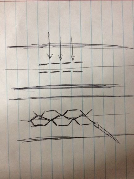

    To your comments abt sewing every stitch, you could go back and do all the ones u skipped, which would give an 'x' crossing pattern. Which is how they are on Mercedes and some Ferrari I've seen. :thumbsup:
    I'll second your comments on the contact cement. Best one IMO is Weldwood.
    I used the dbl sided tape as well, but I also used contact cement all the way around. Def makes a difference in clean/ tight edges and end parts that get tucked in.

    i will probably go back and add the x stiching and the glue...
    did you do that in your thread? the x pattern? it looks different then mine ... better :boink:

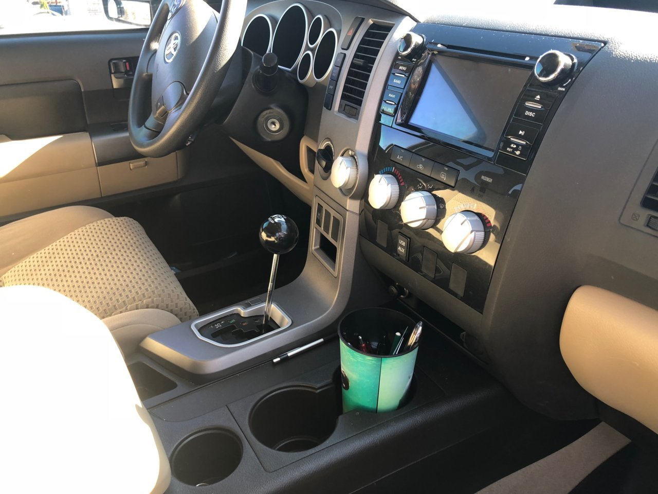

    I like the red shifter ball. Where did you find that and how was that to install?

    posted a link up above...red just matched the interior more...i did the black ball for my brothers tundra

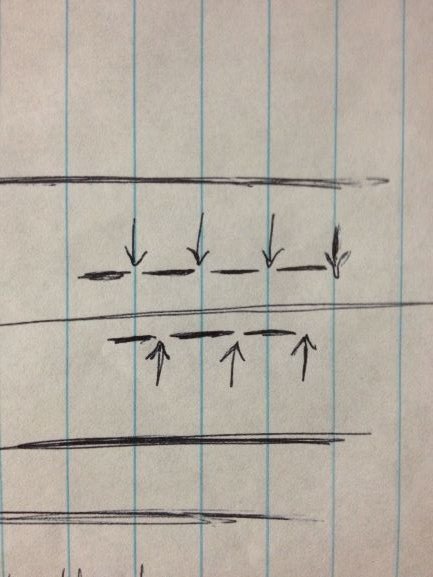

    Yours looks great man! I like that you did every stitch in the tight bends on the '3 and '9 arms. I did not do the 'x' stitching...just the 'every-other' like yours.
    Re the contact cement: Although I did miss some small areas on the back of one of the arms at 3' or 9', I basically tried to put it wherever this was not any double sided tape, and especially at the center line and the ends that get tucked.
    Two things I figured out for the stitch pattern:
    1.) The tighter you pull, the more the 'v' comes toward the center line. I tried to maintain tension every two to three stitches to keep the point of the 'v's to the center line, consistent. Just don't pull too hard and cause the center line to bunch up.
    2.) Most important for the even pattern is to keep the parallel stitches straight across from one another, like this...
    Try to avoid it getting off-set, like this....
