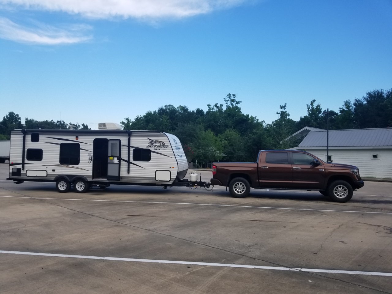

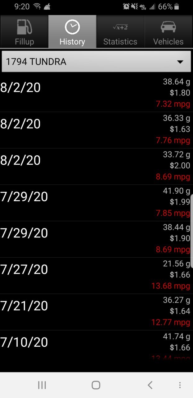

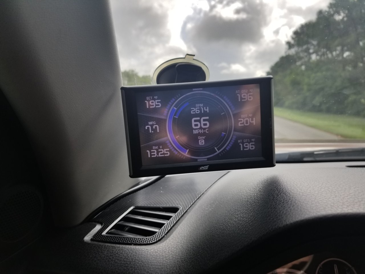

    We just towed our 26 jayco bunkhouse to Pensacola area from San Antonio for a mini vacation.did around 1600 miles round trip. Trailes weight loaded is in the 6000 lb range. I have a 2.5/1 lift, 295/70/18 tires, and regeared with 5.29s. I also have the 46 gallon steel gas tank, rock sliders, full size spare, tonneau cover, and front bumper all adding weight to the truck. Truck pulled easy on the highway, we ran in 5th gear once we got up to speed. In 5th we were running 2800rpm at 70mph, which is the what the rpms were in 4th gear before the regear. We stayed around 70-72mph most of the drive. MPG is normally 13.5 for my daily commute, towing it averaged just under 8. Trans temps stayed around 197 degrees, maybe hit 200 once when we punched it to get around a slow car. I have an equalizer WDH.
    Here is the truck and trailer
    Here is my disply of fluid temps
    Here is my mileage tracking app, the newest 5 are my last fillups, all while towing.

    Cfincke, nice rig, good data. That 2014 with the transmission cooler is running cool below 200f.
    Still curious what the 2019-2020 with no external trany cooler temps are.

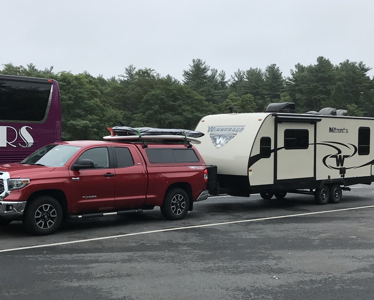

    We have a Winnebago travel trailer that sounds like it’s right around the size you’re looking at. It’s a 2500FL. Weight numbers are pretty much the same. Came out of a 2013 f150 into a 2018 tundra trd offroad. Towing is like night & day between the two. Tundra does it so much better. And the factory brake controller works fine for me. A lot of people 1138E47C-A55A-4F50-9B0B-42CAC4EB72DF.jpg complain about them not working right. Gas mileage is no worse than the ford with the 5.0 was
