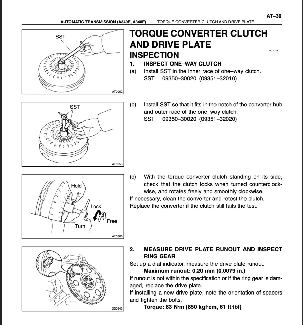

    The idle drop and lurch sound like a sticky torque converter to me. Tranny fluid level and color, good and good?

    Hmmmmm………Sticky torque converter……maybe that’s what was plaguing my truck? (P2757 lockup problems and also the lurch) I still have the old transmission and torque converter in my garage. Is there anyway to inspect the converter easily? Just out of curiosity mostly to see what the problem actually was.

    Look at '(c)'

    Interesting. When I get a chance I’ll do that test. Looks easy enough.
