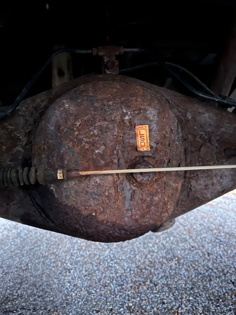

    Happy new owner of a 2005 SR5 access cab. Toyota owners online info doesn't say anything about an LSD in the rear differential. However, there is clearly an LSD sticker on the casing. Who should I believe?

    I believe your diff housing needs to be replaced

    I wouldn't worry about LSD for now, and yes it was available in trucks.
    It looks like you have some rust to address. Hopefully the frame does not look like that.

    If Toyota Owner's Online doesn't list an LSD sometimes the Toyota Vin Decoder will.

    I’d be looking for a whole new reared with an LSD already in it??:) looks pretty rusty crusty!

    I'd believe the rear-end, but also run through a VIN decoder. Toyota Owners site says my truck came with cloth 60/40 or something crazy like that, but I have leather captains chairs, so ... meh.

    Your VIN on my Toyota account will tell you
    Also, drain it and peek inside and you will also know

    I suppose there is no harm in putting in LSD specific gear oil (90w?) vs. the 75w90 that a non LSD diff would use?

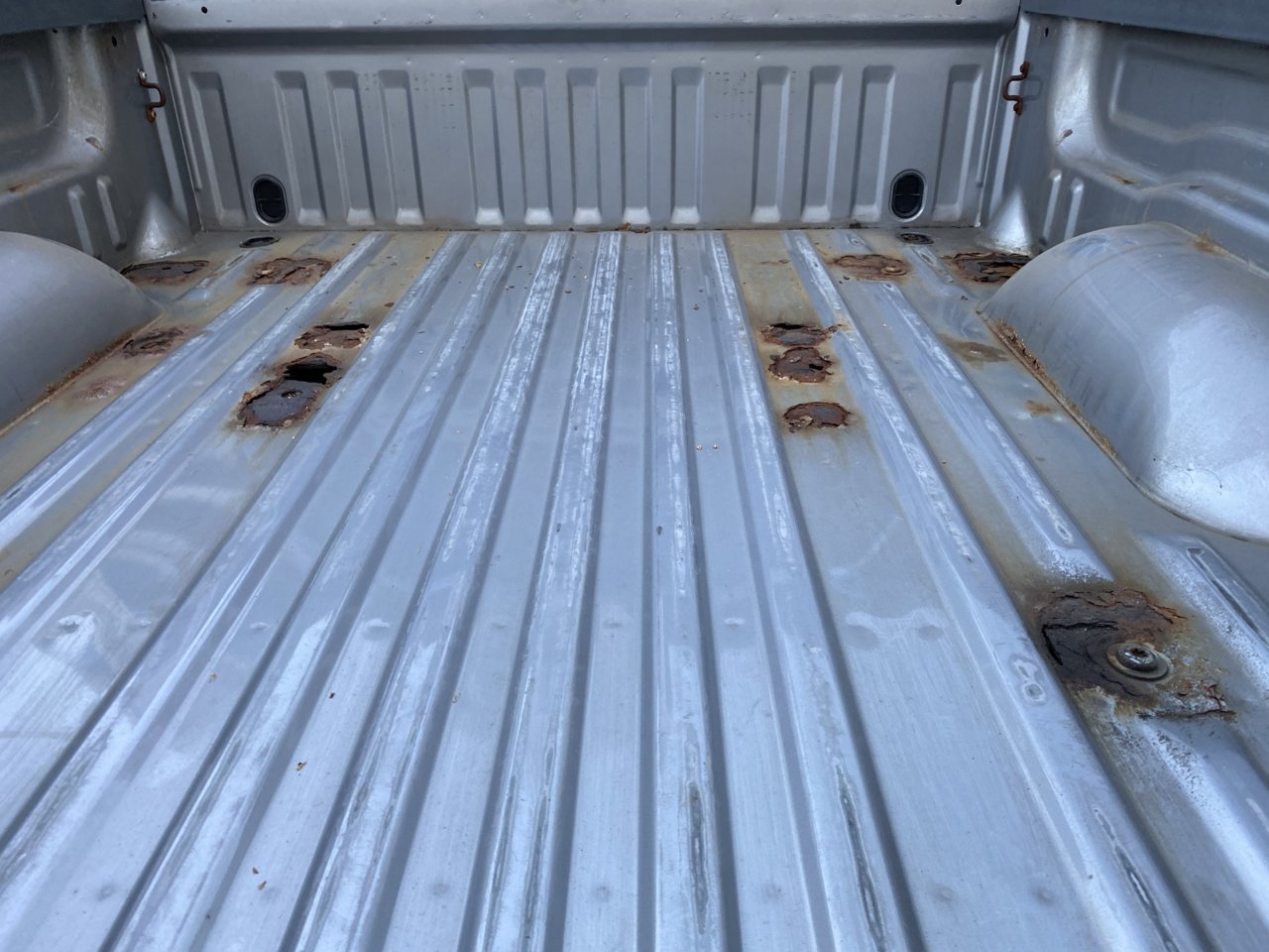

    Bed and body seem to be great. There is a bubble under the paint on the back cab corner- driver's side. Otherwise, it's as rust free as you could hope for in the Northeast.
    Except for what might be happening under the bedliner... I'm in no hurry to pull that up. Is it worth it to keep the plastic bedliners in? Or do they simply trap the water and contribute to rust?
    It looks like Shifty has it right on the fluid- I just checked Amsoil and they recommend the same fluid for both LSD and no LSD. Thanks! I'm sorting everything out for the typical first service of a new (used) vehicle.

    You may be in for a big surprise when you lift that bedliner. These trucks have a flaw in the supports underneath that trap water and salt and rust through from under the bed. This is mine as an example.

    Jack up the back wheels, in neutral, if your brakes arent dragging, do both wheels rotate the same direction?

    Looking more closely, is it just me or does the bottom left portion of the diff look like it has oily residue from a leak? That sucker may be pretty thin steel at this point. I’d make sure it’s not low on gear oil.

    Yup, it's already saturated. Not much OP can do on that one other than find a new housing and/or replacement rear axle assembly from a matching-cab/similar year truck.
