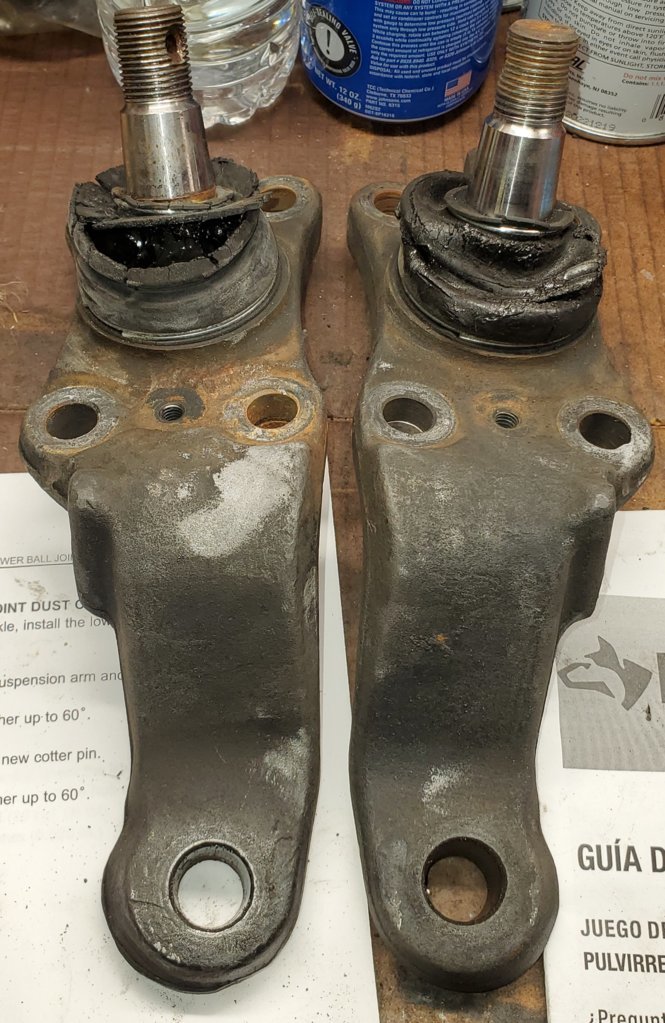

    20231017_001800.jpg Well they certainly dong make this sh*t intuitive PN wise. In case this helps anyone, the toyota recall website would only show my frame recall...so I called Toyota at:
    1-(800)-331-4331
    And the yound lady verified my 02 received LBJ recall kit in December of 2005. They show zero play. I am about to due more front end work and now im confused bc I ordered new LBJ from McGeorge...due I need to source 4 of the slightly longer recall bolts?
    I dont want to replace current lbj that still seam tight with stock more prone to issue lbj as routine maintenance, id rather track down 4 or the upgraded bolts. 20231017_001258.jpg

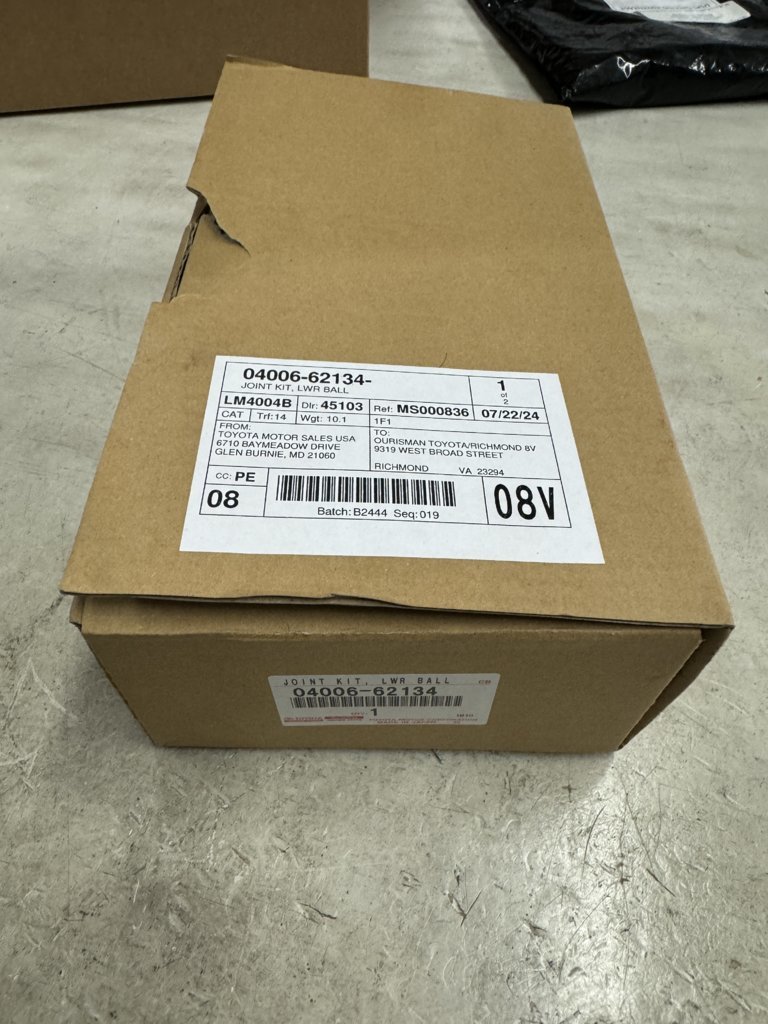

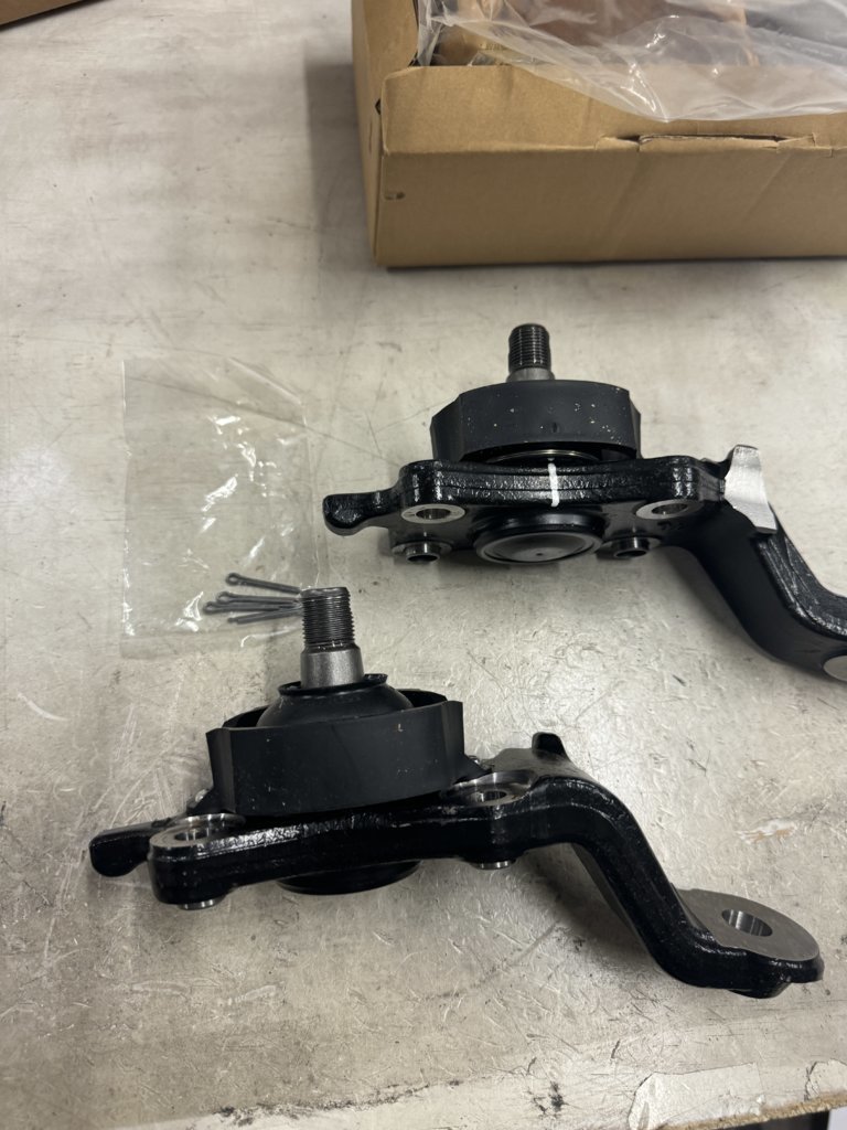

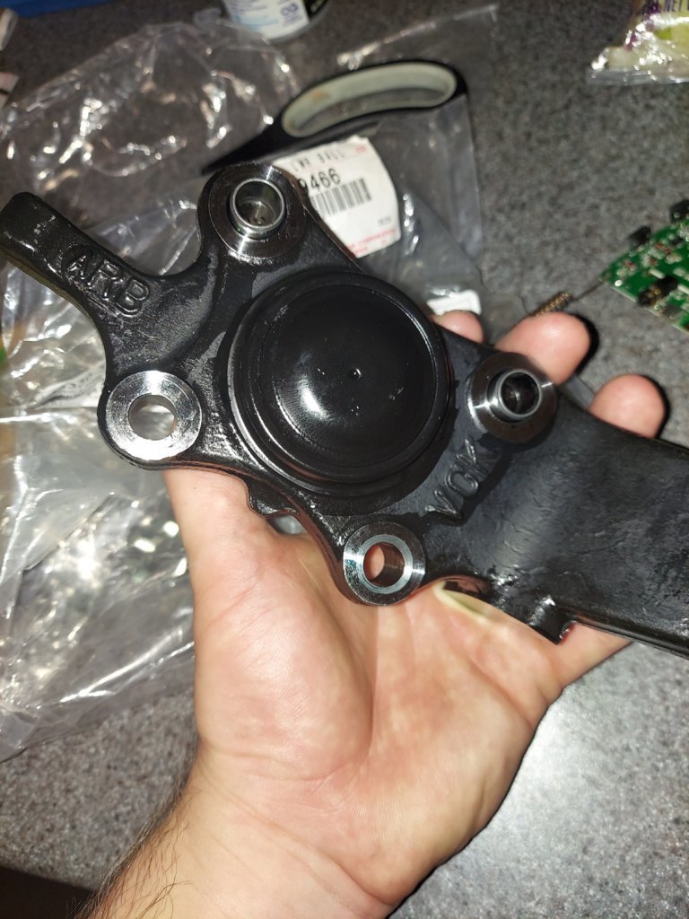

    Can confirm my parts fr/NormReevesToyota for my 06 AC V8 2WD:
    04006-62134 Joint Kit Lower Ball $190.13 1 $190.13
    90105-12316 Bolt Flange $1.83 8 $14.64
    Pics in my last post show the items [2 LBJs w/boots attached, bag of 8 bolts [separate item]]; 'whats included', yeah I guess does depend on source. Hope thats not confusing anyone [any further].

    That's fine if you want to get two bare LBJ and all 8 bolts. If you need the castle nut and cotter, you won't get them with that order. LBJ kit is just the ball joints, and potentially the rubber protector (not sure)

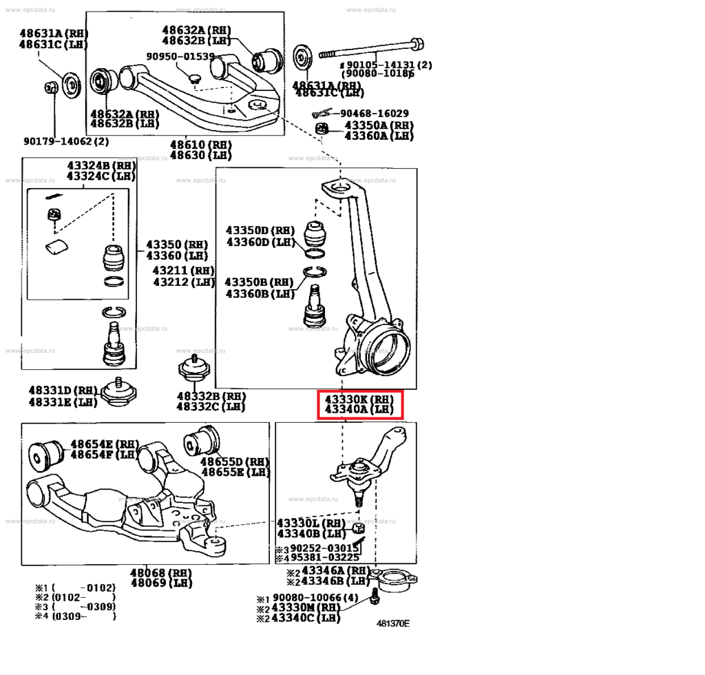

    So... I've read through this whole string several times and I'm still confused as to which part number is correct for the Left and Right LBJ for my 2005, AC, 4x4, V8, VIN 5TBBT44135S463029
    I believe the kit is 04006-62134, and the bolts I believe are 90105-12316, but what I am looking for is the individual LBJs.
    In this string for Left I see 43340-39595 or 43340-39175.
    For the Right I see 43330-39825 or 43330-39825
    I have been ordering my parts from Toyota San Diego Parts Online and their website shows the -39175 and -39825 at about $140 each and it looks like these come with a new castle nut and cotter pin.
    Can anyone confirm that these are the correct parts?

    The right-hand part numbers you gave are identical to my eyes, and the correct p/n. I dunno where that -39175 number came from, when I looked it up, it tied back to earlier model T4R and Tundra. I dunno where the heck @Rich L. got those #s.

    I do all of my parts lookups after entering my VIN into the search here: https://toyota-usa.epc-data.com/tundra/
    After plugging my VIN into the search and searching.
    I click on Transmission and Chassis link.
    Then next to the 2nd image in that section, I click on "48-02 - FRONT AXLE ARM & STEERING KNUCKLE".
    Because the image is small, I click on "Open Full Size Scheme".
    From there, I click on each one of these links for RH (right hand) and LH (for left hand) to get it to spit out the part number for the assembly inside that black box below it.
    What part numbers do you get when you do your parts lookup my way?

    Okay, just talked to the parts guy again... He won't sell me the "kit" with both. And confirmed my numbers are wrong in his system and that your numbers are correct. He guesses the '07 designation in there is probably because the warranty replacement started in '07. Uhg, he'll take my erroneous order back and refund. Then I can reorder.
    So I'm going to edit my above posts and remove my bad numbers. Thanks Guys.

    Just got my parts, new lbj recall kit in. Not shown but I also bought new bolts
    Ordered from - Ourisman Toyota of Richmond Online

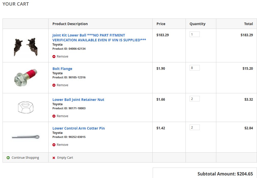

    Does this list look complete for 06 Tundra AC 2WD?

    Looks right to me, that's exactly what I have in my cart (except the cotter pin, good call). Just haven't clicked the go button yet.

    That recall kit and those fasteners are correct for 2006 in all flavors. Crossover happened in December 2005, but you're safe with those on your 2006.
    That's a very good price if you're getting free shipping and no tax. I was around $275 shipped on mine buying the individual joints (which come with nut and cotter), and the 8 bolts. But I don't think I ordered during a sale period, so I probably could've gotten it down to $220-230 shipped if I'd tried.
