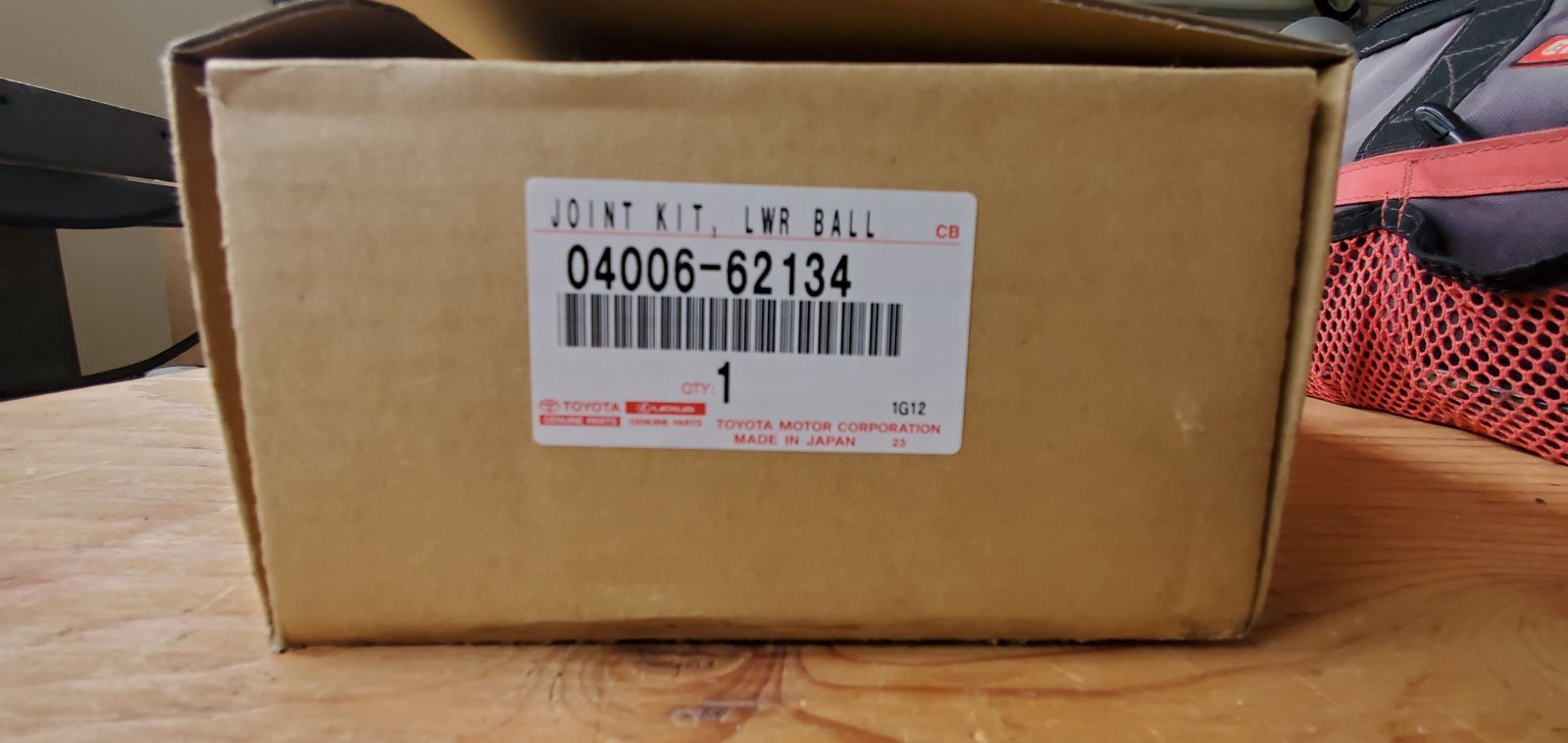

    Look into getting/Buy the recall kit it’s like $40 cheaper
    part number 4006-62134

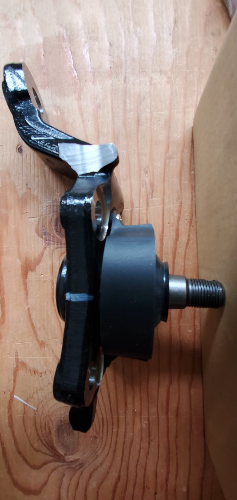

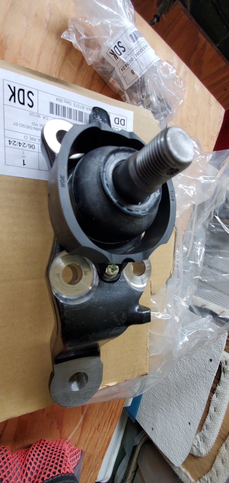

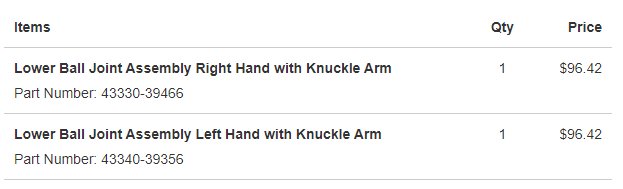

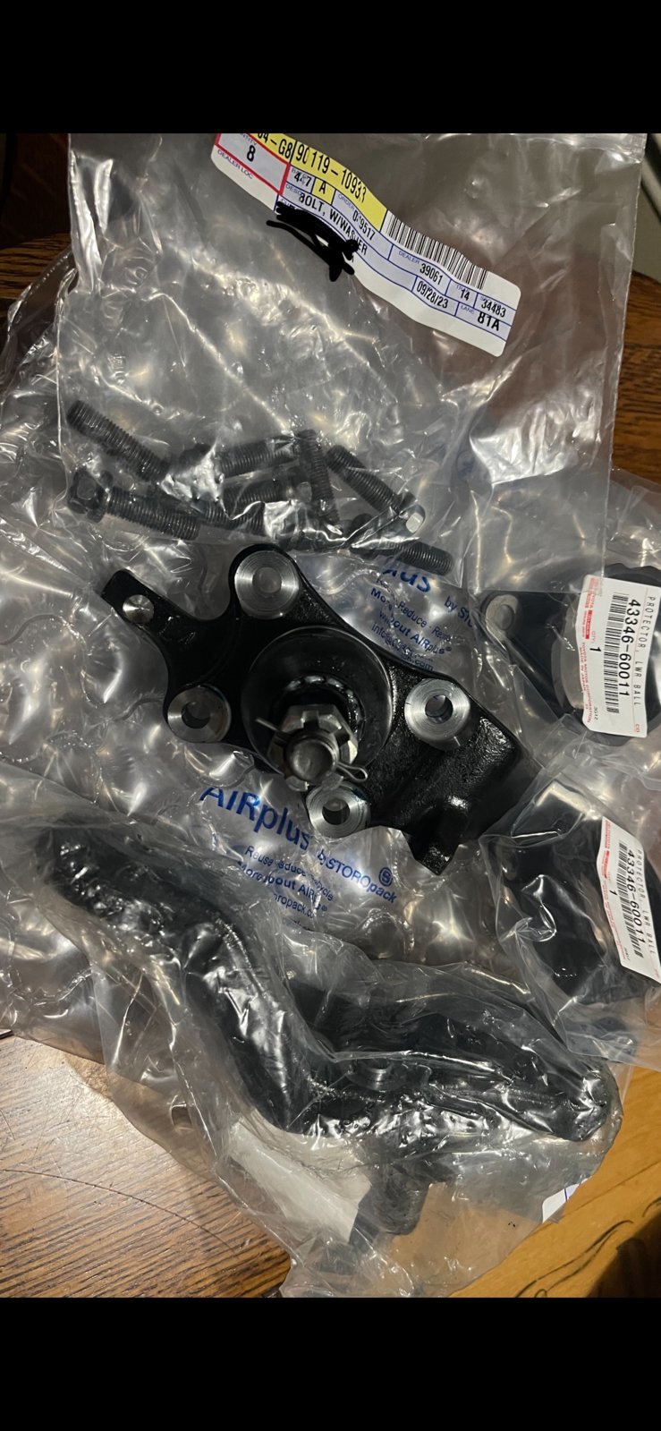

    for clarity sake on what I posted above and in case anyone else is curious or shopping OEM LBJs , according to Toyota by VIN for 2006 AC 2WD:
    A few pics of what I purchased in SanDiego [normreevestoyota]
    Lt & Rt LBJs in box, with boots installed and 4 cotter pins in a sealed bag [nothing more]; $205 per set [no castle nuts]. 8 mount bolts, extra$.
    part #s [and bag of 8 mount bolts]
    BTW Mods: If I attach thumbnail size, can they still be opened to ful size, and if so, does this make a more efficient use of website space?

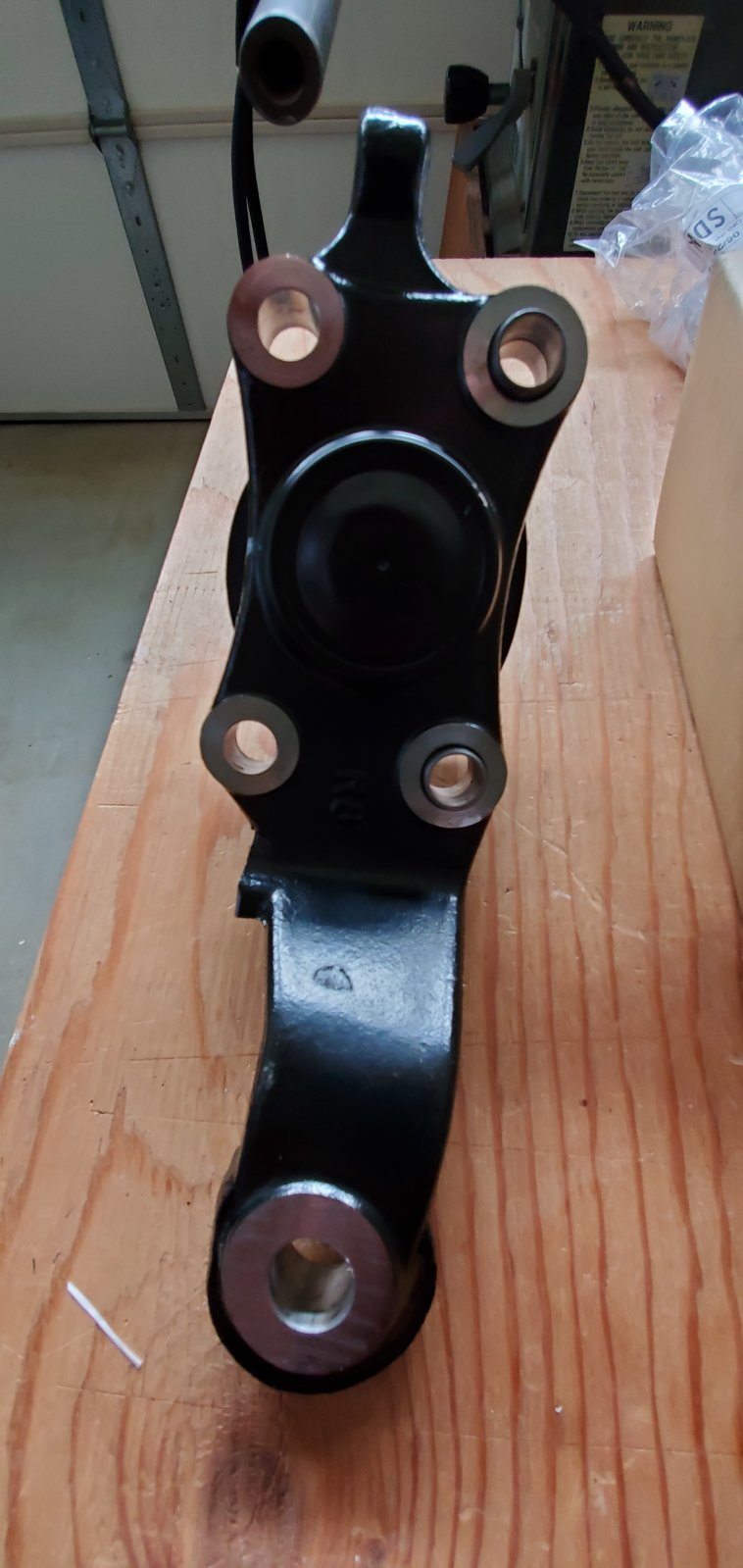

    Trying to get some things in order here in this thread as it's kinda all over the place.
    What ball joint part numbers did you order? I think at this point I'm really trying to determine if the ball joints with the protectors on them are any different than the regular early ball joints. Do they all have screw holes to add the protector? Need to hear from some of the 02-03 guys that have messed with this. @Mr.bee
    I'll tag @Jack McCarthy but it looks like you didn't have protectors on your old ones so maybe you won't apply here. As well as FirstGenVol as quoted above.
    Edit: Thought I read through everything but I found some more info, from what I gather all the 02-04 with protectors just get held on with the bolts that hold the joint in so it really seems like they should run the same joints, just different length bolts.
    I know there are ball joint recall kits but I was hoping to lay out the individual part numbers for each type of ball joint and what truck they fit, and maybe get it up near the beginning of this thread or maybe in a new one. Thanks all!

    No separate screw holes; you use the existing bolt holes on two of the bolts.

    Yeah that's what I mean, you run the black bolts in all 4 holes but two of them go up through the protector. Alright, just want to be sure that each individual ball joint part number is the same for 00-August04 then September04-06 is the big ball style

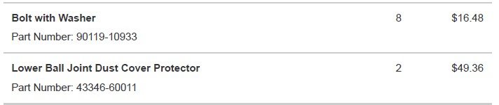

    15,150
    Arkansas
    I ordered 8 bolts individually, 1 left LBJ, 1 right LBJ and 2 protectors.

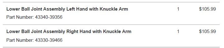

    Left 4334039356
    Right 4333039466
    Protector 43346-60011
    Sound right?

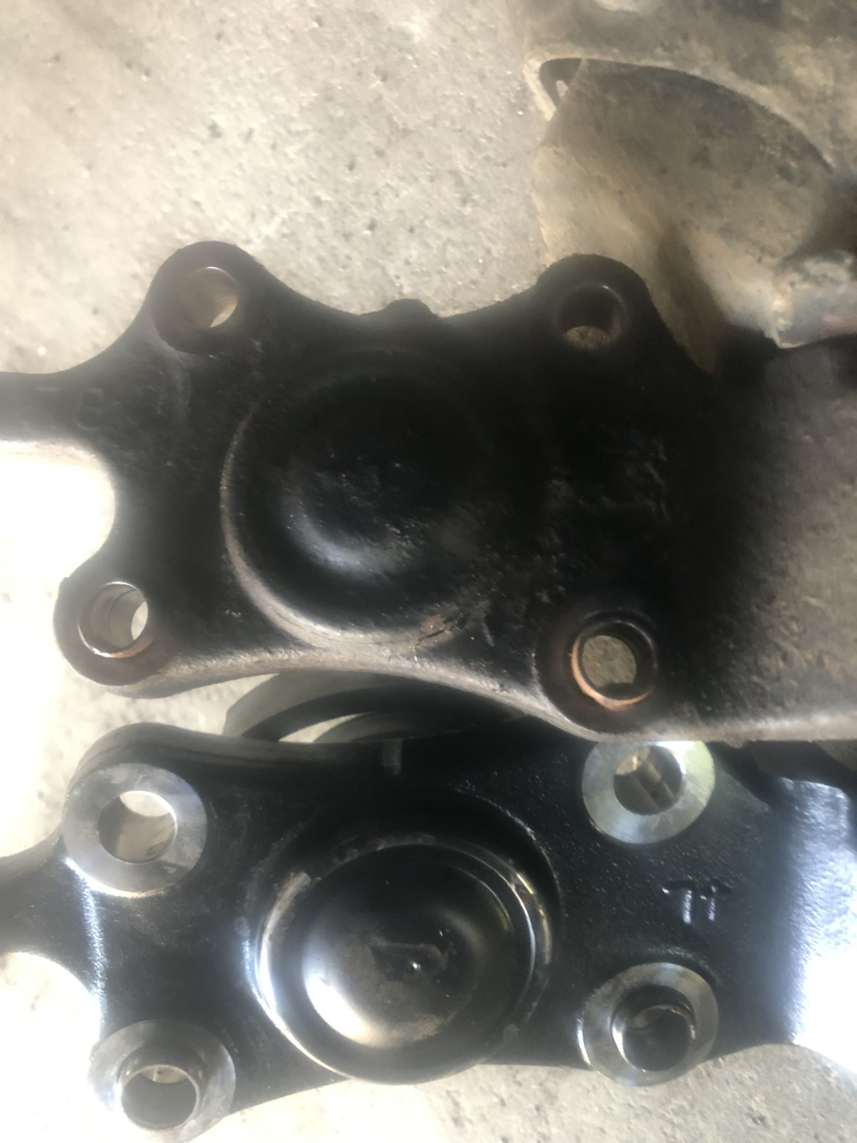

    74554741708__763A46C8-B255-40B8-B39F-6C257A1B2F6E.jpg I have a Frankenstein tundra apparently. New LBJ kit is correct for my year (proper 05) but PO installed a different year OEM lbj on one side. Did the spindles also change because it doesn’t want to play nice

    This totally messed this install up, so I either need to get a new “pre mid 04” style LBJ and 4 “pre 04” bolts to get it working again with drivers side sporting 04 spindle and passenger side 05-06. Or get a new spindle and wheel bearing and use my 05 LBJ and bolts. Shit.
    how do I tell what year lbj/spindle my frankentruck is sporting?? 01-02 or 02-03??

    Look at the picture in this past post that shows the way the boot protector attaches. Does your joint have two screw holes in the top to attach the protector? LINK

    Do your new 04+ bolts thread into the spindle you believe is suspect, or are the threads on the spindle too narrow for the bolts?
    00-03 Little LBJs and spindles should have M10 bolts (14mm socket)
    04-06 Big LBJs and spindles should have M12 bolts (17mm socket)
    You can also use a digital caliper and measure the bolt holes on both the LBJs and spindles to see if they are 10mm or 12mm.

    Ball joint and bolt part numbers all years
    2000-2003 (small ball joint before September 2003) Left joint: 4334039356 Right joint: 4333039466
    There are a couple bolt options depending on your use/budget:
    9008010066 Torque to 59ft-lbs (SINGLE USE BOLT ONLY) or ARP bolt 663-1004 (more expensive but can be reused)
    If you want to run the boot protector or already have it (it will fit all 2000-2003 small ball trucks) it is part number 43346-60011 and you will need the longer black bolts for it which are part number
    9011910933 and torqued to 37ft-lbs.
    2003(big ball joint after September 2003)-2006
    Left joint: 43340-39595 Right joint: 43330-39825 Bolts:9010512316 torqued to 59 ft-lbs
    I'm sure there is an ARP equivalent to these bolts but I couldn't tell you what they are off hand.
    I went off of info on this thread and a couple others. Trying to have one single post to go to for individual ball joint part numbers.
