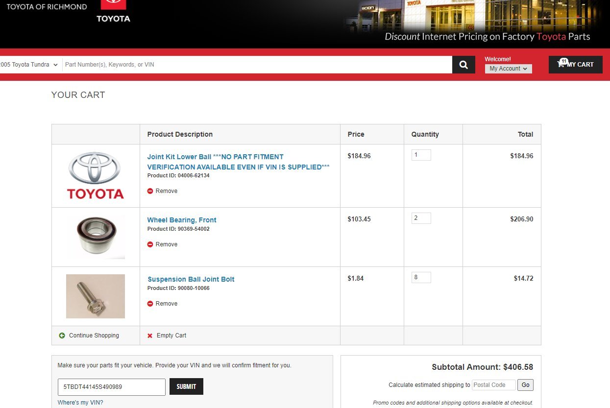

    I ordered and received the 04006-62134 ball joint recall kit and 90105-12316 bolts from Ourisman a few weeks ago for my late '04 DC. Turn around time and packaging was about the same as it was with McGeroge.

    I complained to Ourisman about the shipping charge, and they told me they would match the shipping of any other authorized internet parts dealer. I found that by shopping around I could not only find lower shipping, but lower prices as well. Parts is parts, but dollars is dollars.

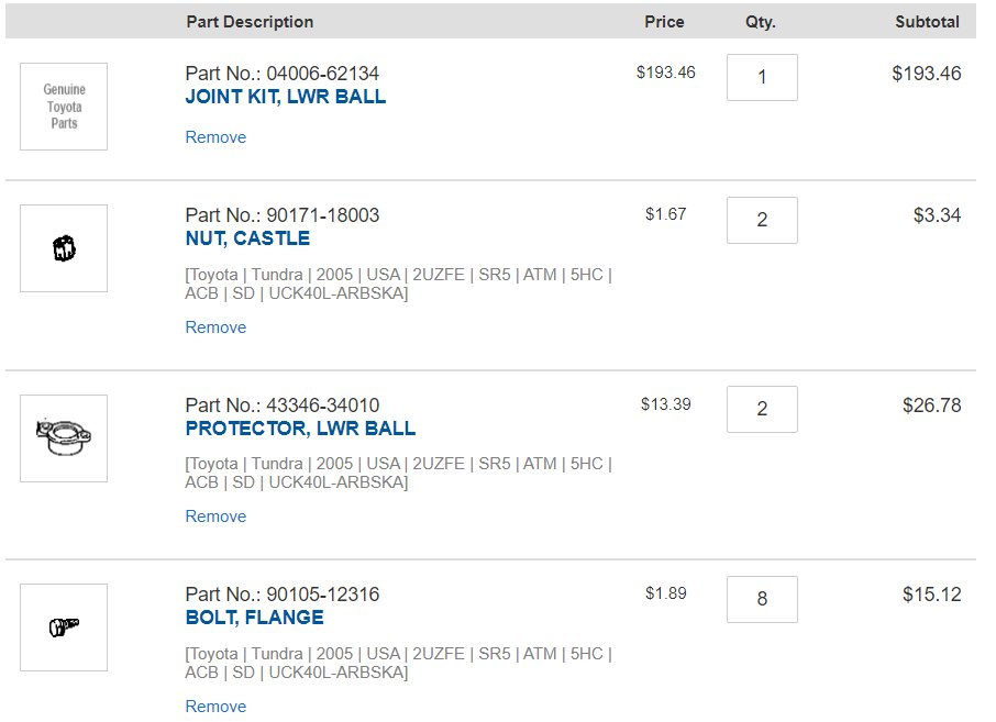

    2005 AC 4x4 UCK40L-ARBSKA, I have such a hard time figuring out what parts I need for some reason. Here is what I have so far for my LBJ. Is the Castle nut correct? What is this bolt #90105-12284 and do I need it, it was only produced 03-04 and I have an 05 but I see no other options?
    Besides my LBJs I am replacing my UCA with SPC kit. What parts should I get for that that are not included? bushings and bolts?
    New 6112s up front also and I need bump stops and rear leafs and so much more but I will leave all that until after have a complete front suspension parts list and order some of it.
    Thanks in Advance, Garrett

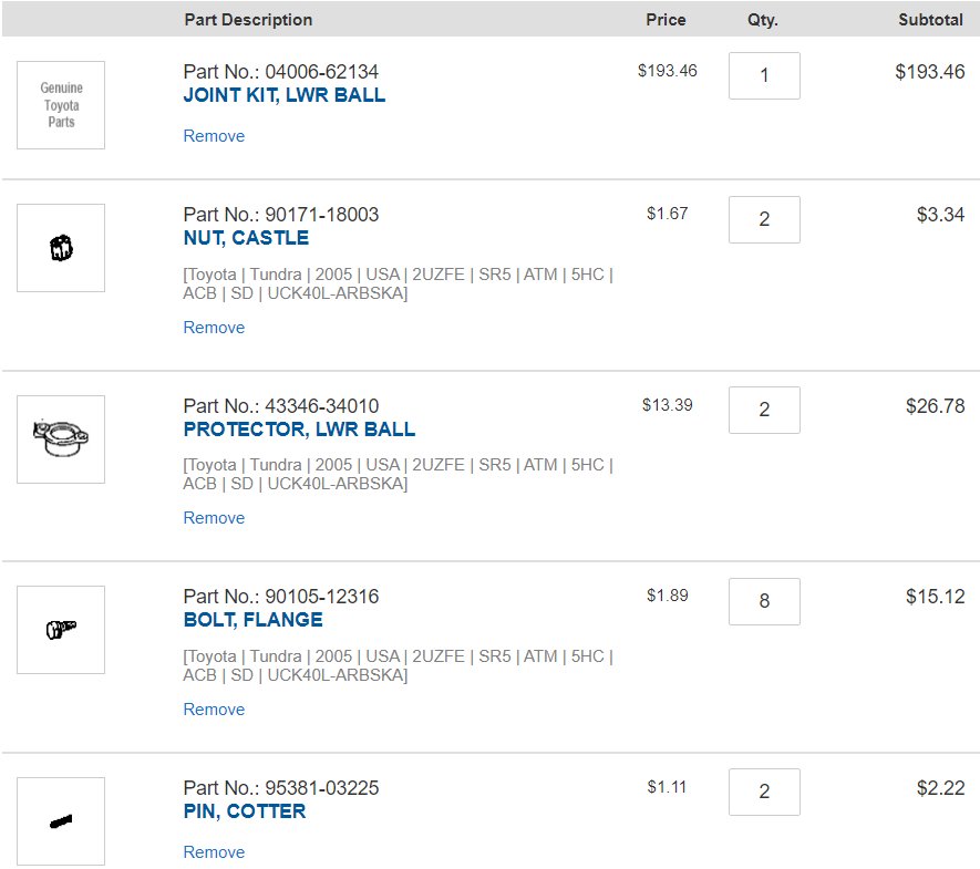

    If you buy the lower ball joint by itself, not in the kit, it comes with a new cotter and castle nut. Truth be told, if you intend to replace everything (mine were in fine shape), you're probably better off buying individual joints.

    Note the kit (04006-62134) doesn't come with a new castle nut, although it may come with a new cotter, so verify your nut is OK before ordering. Confirm your VIN range for that part over here.
    I went with 90105-12316 for my '06 on the LBJ bolt. I'm not sure where you got your part number. 90105-12316 is good for 59lbft, but supposedly can handle up to 80.
