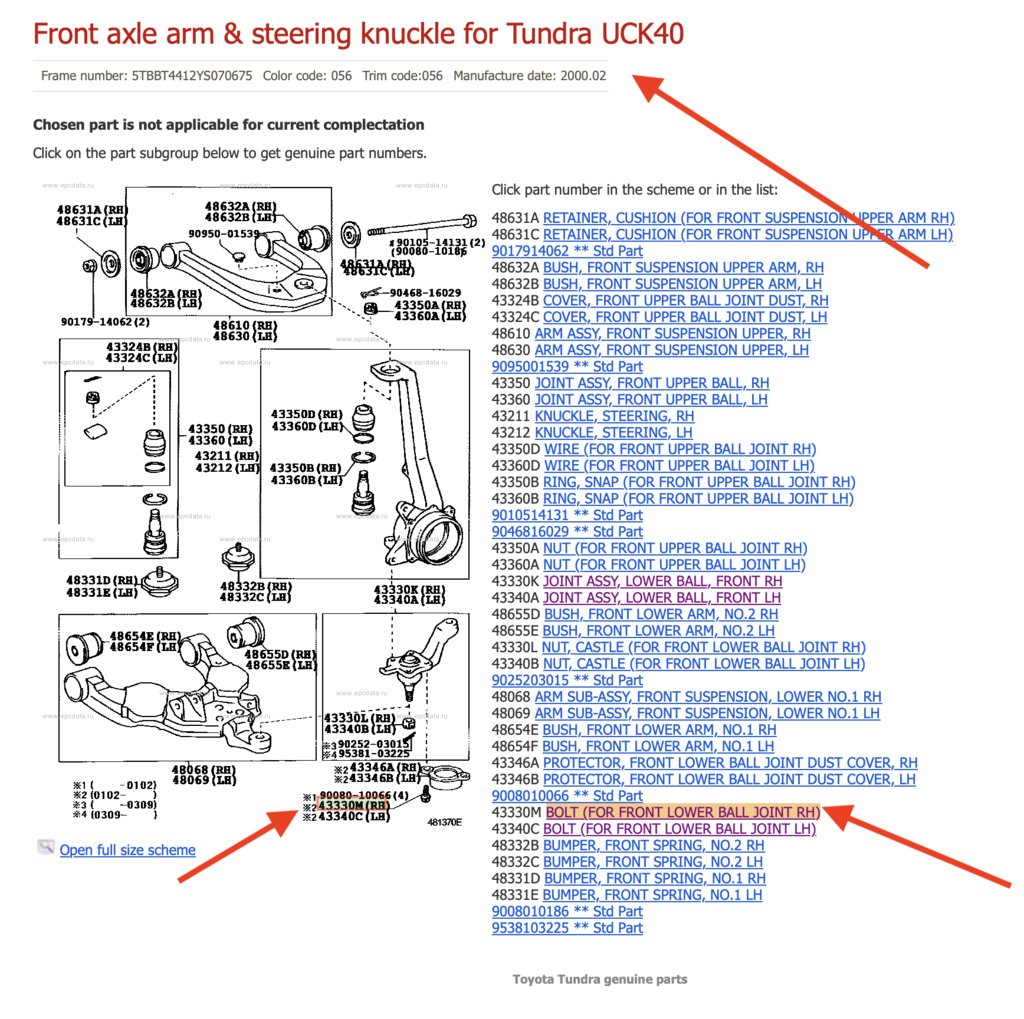

    I'm trying to follow all of this. I have a 2002 access cab 4wd. 158,000 miles and I believe the ball joints have never been replaced. I have watched videos of replacing the lower balljoints. I used the epic parts finder site. If I purchase parts 43330-39466 and 43340-39356 then I wouldn't have to deal with removing the ball joint from the socket? Is that correct? I can't find just the ball joints on the epic site. Here is my Vin so shifty can tell me how right or wrong I am.
    5TBBT48112S308744 (I think I tagged correct here) I also think I would be able to just change the ball joints if I could figure out the part number. Is replacing the entire assembly might be enough easier to make the cost difference worth it?
    Then I would also need the correct 8 new bolts which I also didn't figure out on the epic site. I hate that this question makes me sound like I don't know anything. I maintain/repair 99% of my own stuff. From House to Motorcycles, Automotive, etc. At 63 I've been fixing things for more than 50 years.

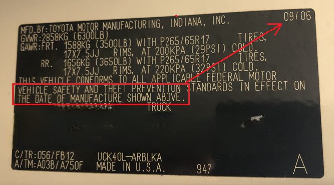

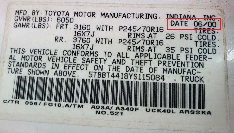

    10/4 @bfunke. We're on the same page. Turns out the shop I went to was NOT replacing the ball joints (thank the heavens) and it was just some loose bushings. ball joints are solid, still OEM, with no play currently. Still need to replace though. What's the best way to figure out which 2003 part #'s to go with? I guess it depends on month of manufacture?

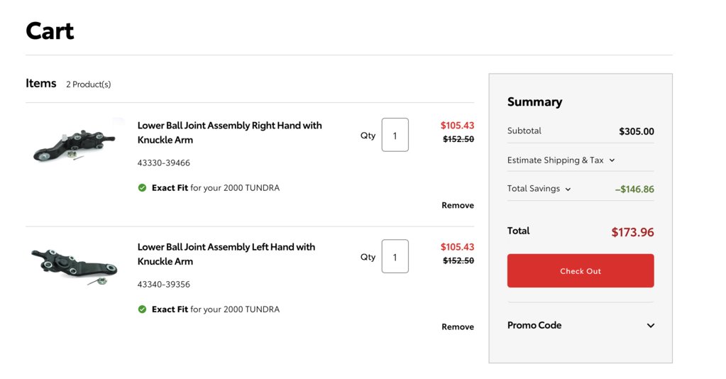

  15. Sep 15, 2025 at 6:44 AM
    #465
    shifty`
    Jun 20, 2020
    #48239
    31,524
    ATL
    '06 AC Limited V8/4WD

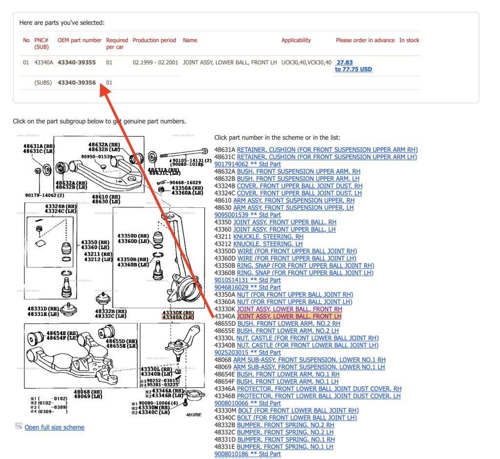

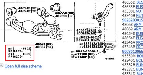

    Yes. I think it was @des2mtn who shared Toyota's spec tolerance is 0.2mm of play. Yes, there are tools out there which can detect that. I'm highly skeptical any human would be able to detect that by hand, or with a jiggle test. You definitely won't be able to detect that with the load it's under. Numerous anecdotal reports from members on here (me included) that their LBJ only showed signs of play after removing it from the truck. YMMV always applies, but in my world, "better safe and reasonable than sorry" is king.
    I've been away working on our new house in midcoast Maine for the past week+, so just now seeing this and trying to work back thru posts.
    I ran your VIN thru the EPC, and it spit out the following for OEM joints, but note, as you'll see in the EPC, there are different bolt part numbers for your specific year. I'd see earlier in the thread for your bolt choices as posted by @NickB_01TRD

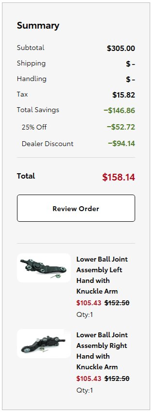

    There's a 25% off sale going on at the dealer I linked and if you're not an Alabama resident, they'll do no tax to go along with the typical free shipping and major discount. Note the full discount won't show until you get to the Checkout page, as seen here, this should be your price to your door if you order within the next 6-7 days from them while the sale is happening (basically ~50% off MSRP, not bad!):
    NickB_01TRD likes this.
