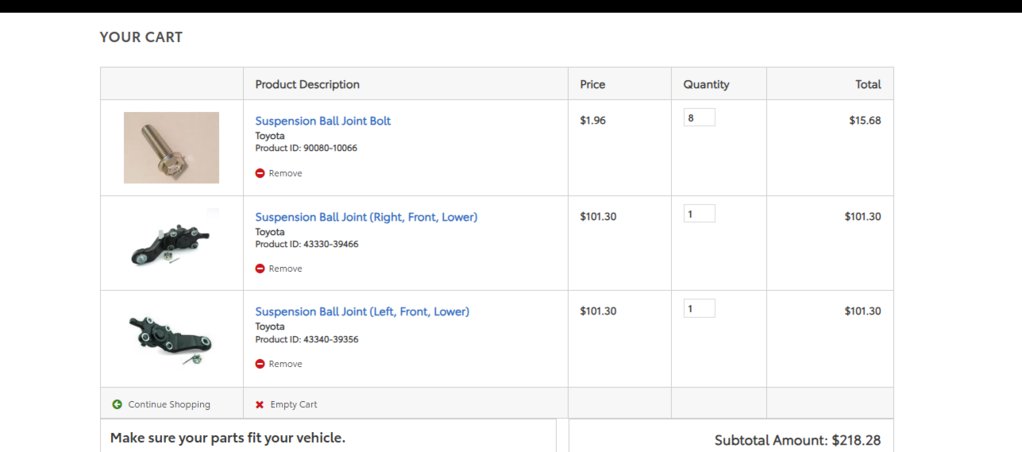

    So if I understand correctly, my truck has the same ball joints as the 04 since its an early 05?
  5. Mar 25, 2025 at 11:54 AM
    #395
    shifty`
    Jun 20, 2020
    #48239
    31,413
    ATL
    '06 AC Limited V8/4WD
    That's what I'm thinking. I'd need to run an '04 truck's VIN thru EPC to say with 110% certainy, "yep!"

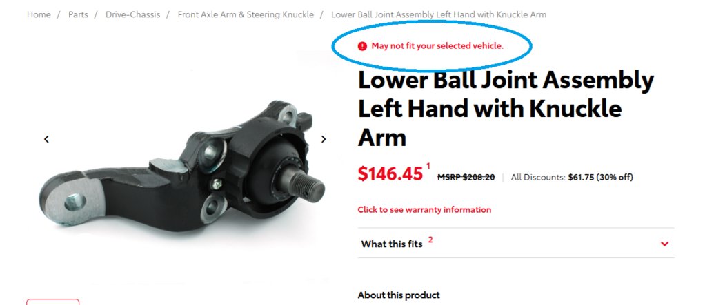

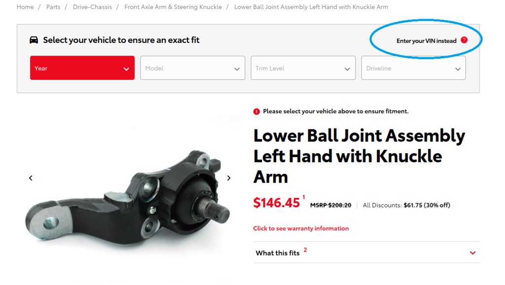

    I cant seem to find the part numbers you sent, I wonder if these are what Im looking for, LH 43340-39595 & RH 43330-39825 ?
    When you look up the part numbers I just mentioned on autoparts.toyota.com the other part numbers are listed as previous versions.
    what are your thoughts?

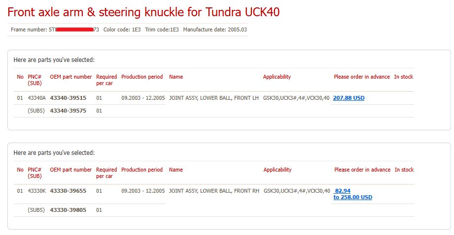

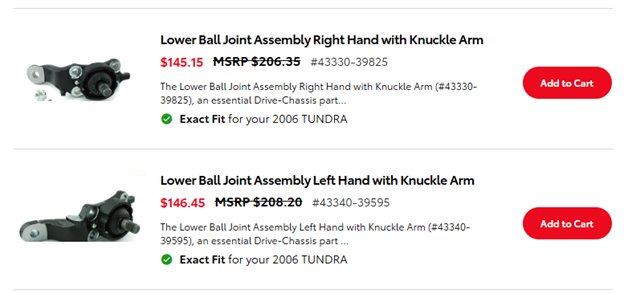

    The part numbers in the picture you quoted, those are what the EPC-DATA site gives me when directly inputting your specific VIN, 2005 AC in V8/4WD.
    But the parts Bubba is showing pics of, those are identical to what I ordered for my '06 AC in V8/4WD.
    Which is correct, the one EPC data gives for your truck, or what Bubba ordered for his '04 and I ordered for my '06? Not sure, but you can always check compatibility in the Toyota Parts system by giving your VIN and noting what Toyota says is compatible. Unfortunately ... see the result of that below.
    I would find it VERY strange Toyota would list a recall kit for '04-'06 truck year range specifically, but somehow have different LBJ part numbers for the three of our trucks... Just sayin'.
    But really. You have four part numbers - the ones Bubba and I used, and the ones EPC spit out for your VIN - use the links in this reply to load up one of the part numbers Bubba and I used, then click the "ENTER YOUR VIN" to check compatibility. Is it compatible with your VIN in their system?
    When I did it using your VIN, this is what I saw...
    (But I saw the same with the EPC part numbers too!!! It makes no sense!) :rofl:

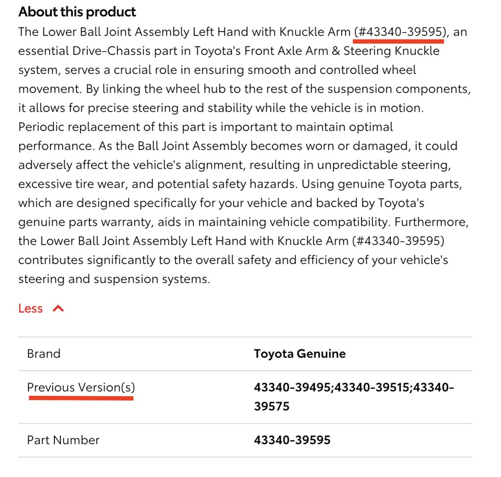

    This is what I was referring to though
    The parts I was searching for are listed as previous versions under this part. But when I put in my VIN it also says may not fit, although Im not sure how accurate that is.

    That's typical. Toyota changes part numbers, i.e. supercessions (or whatever they call it). But I don't see our '06 part numbers in the supercession list.

    The part number at the top is the one bubba used (39595) and the previous versions list the ones you picked out with my vin 39515, 39575
    might be the correct part still not sure though…

    Yeah, this solves the riddle. I didn't look at the supercessions to realize they were the same part, but one is a future revision. Looks like they were jumping up by 20s on the last three digits of part numbers
    i.e. 495 + 20 = 515, 515 +20 +20 +20 = 575, 575 + 20 = 595.

    So in conclusion we thinking LH 43340-39595, RH 43330-39825, Bolt 90080-10066 are the correct ones?

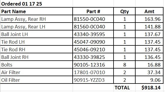

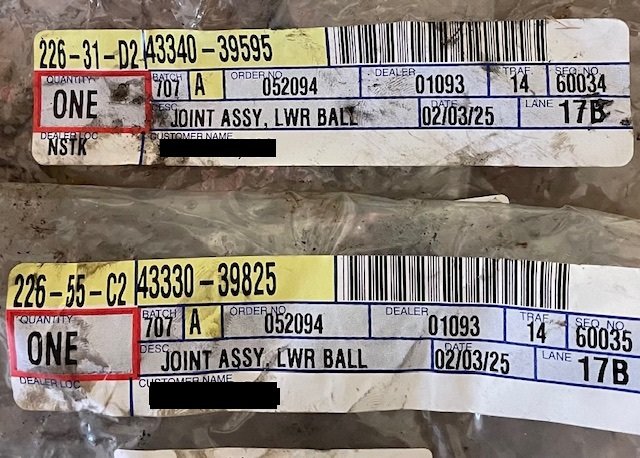

    Our Used Car Manager has an 06 DC. He just came to me and said, "What were those things under my truck that you said I should replace?" I made him a parts list.
    Left Lower Ball Joint Assembly: 43340-39595 x1
    Right Lower Ball Joint Assembly: 43340-39825 x1
    Flange Bolts: 90105-12316 x8

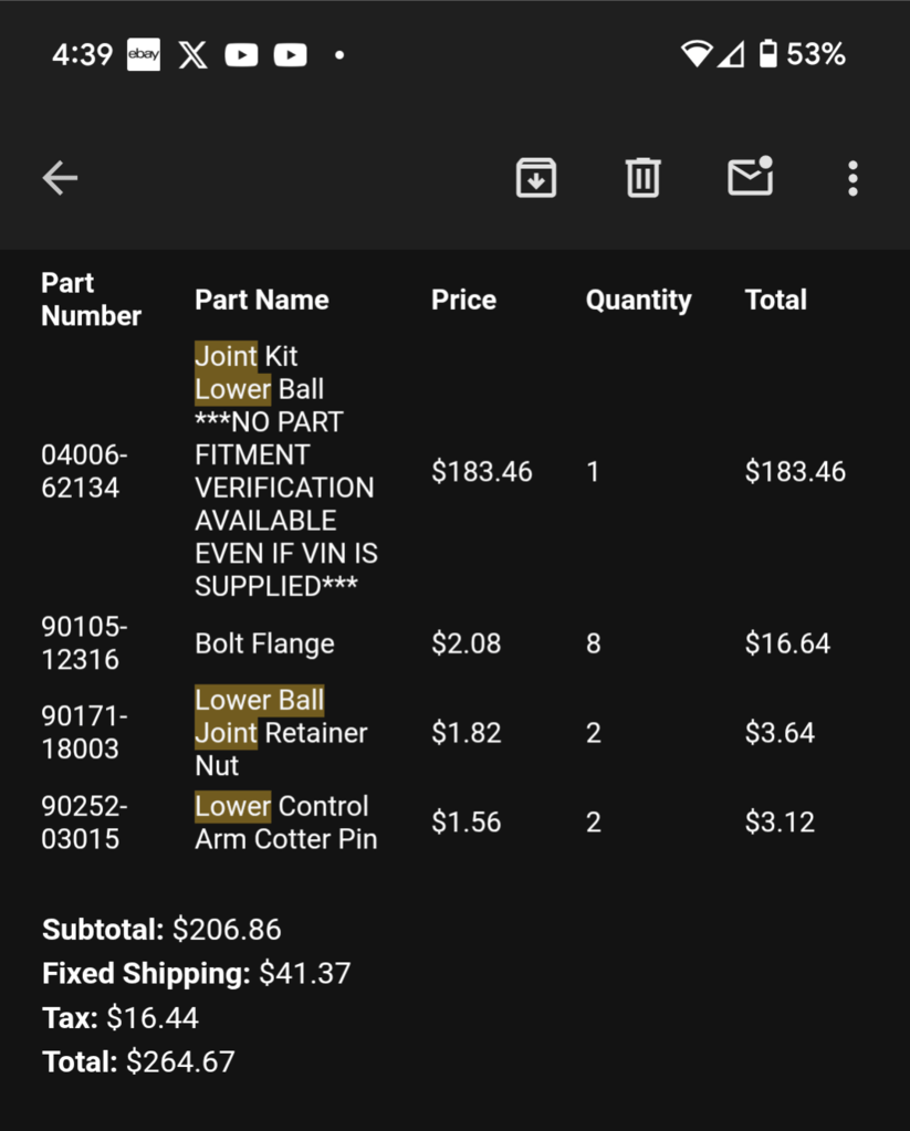

    I just did my lower ball joints. I've got a late 2004 AC.
    I bought the kit part no. 04006-62134 (kit came with 2 castle nuts and 4 cotter pins)
    And the bolts part no. 90105-12316
    Everything was an exact match.
    Make sure you have a torch nearby when you do them because mine were seized together.
