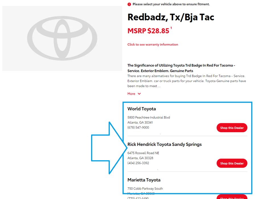

    Just for shits and giggles, humor me for a sec.
    Click this link to hit the national Toyota parts site for a random part.
    Ignore what the part is, it's the TRD badge I used for my recent grille overhaul, we're not interested in that. What I want to know is this. When you load that page, at the national site, do you see your local dealership in the "shop this dealer" list? If yes, you can usually order online at MSRP or cheaper (click "Shop This Dealer" and compare the price to the MSRP shown to see if there's a discount), then go pick it up in person if you want to drive 6hrs, or potentially have them ship to you, sometimes the free shipping code, FREESHIP, works on orders placed thru the national site. EVEN IF they are asking MSRP, with the 25% off at that national parts site, it should be markedly cheaper than what you quoted, but the discounts don't apply until you hit the checkout page (you can see them before you actually hand over any cash).
    AresEsMaLo likes this.
  12. Oct 25, 2024 at 8:41 AM
    #312
    vjmarsh
    vjmarsh New Member
    Aug 7, 2024
    #120978
    11
    V
    06 Double Cab SR5
    Thanks for the info, that’s actually super helpful and something I’ll probably use when I’m in the lower 48. Unfortunately the closest participating dealer is Juneau which is over 600mi as the crow flies. But because Juneau isn’t on the road system it’s an almost 24 hour drive including a trip through Canada and a ferry.
