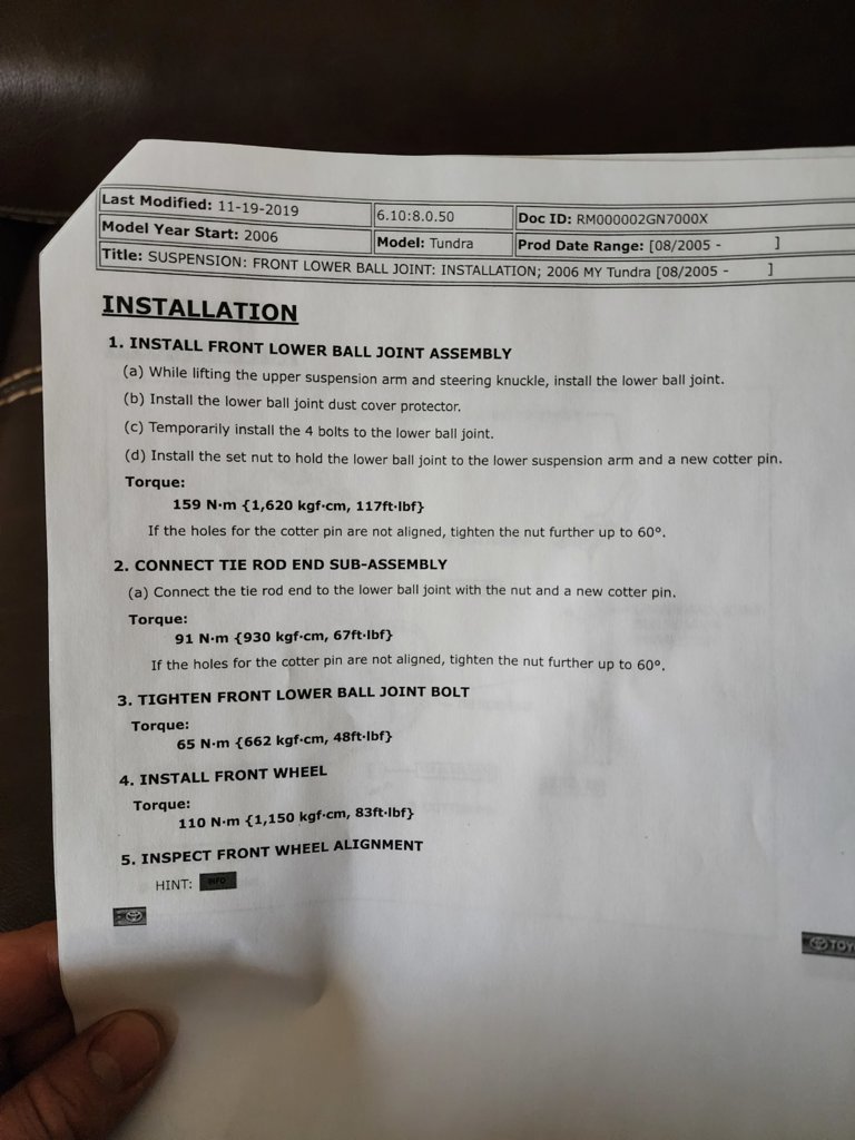

    Heres the torque specs for 2005+.
    I had printed this out for when I install mine.
    G_unit3000 likes this.
