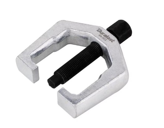

    I was lucky, I guess. Mine broke free without issue. I regularly try to save money, but...with a lot of these kind of tools, the difference between cheap crap and high quality is...not enough to justify going cheap. I just looked and the Duralast front end kit is $100. OTC is $160. Not like we're talking $100 for cheap, $400 for quality.
    I guess I can see people thinking they'll only do the job once and not wanting to spend more than the minimum. But I bought my OTC front end kit in 2015 (just checked, for $100 back then), and I used it twice on my Tacoma LBJs, twice on my Tundra LBJs (once to replace them, once to do suspension work), twice on the UBJs (same thing...once to replace them, another time for suspension work) and many more times on tie rods and other front end parts. So far. I'll use it plenty more times. If you do your own work and own older vehicles, a decent front end kit is very cheap for how often you'll use it. I've seen no visible bending, warping or cracking on any of the pullers.
