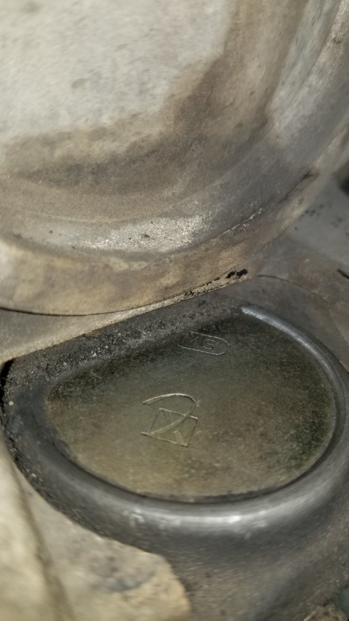

    I made this video of the ball joint, shock mounts and wheel play etc. As of now I cannot get the clunking sound to come back. I've been driving (slowly) around the neighborhood and it will not make the noise now, just like in the past.
    https://www.youtube.com/watch?v=UmAPO7lntcM
    At this point I am stumped. I suppose I can start with the lbj and inspect it. But it "seems" ok, at least visibly from a test with the wheel lifted and a crowbar.
    What type of suspension component can lie dormant for weeks then make noise, lie dormant again for weeks/day and make noise over and over again?
    Also, I took a photo of the only area I could to see on the lbj for any identification to see if it was part of the MOOG recall. All I can see is an MS in the middle of an oval and some sort of pattern on it. I don't know if its a MOOG or not.
    Thanks for everyone's input.

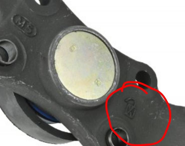

    I found that logo on a Mevotech Supreme lower balljoint over on Rockauto.
    tvpierce and FirstGenVol like this.

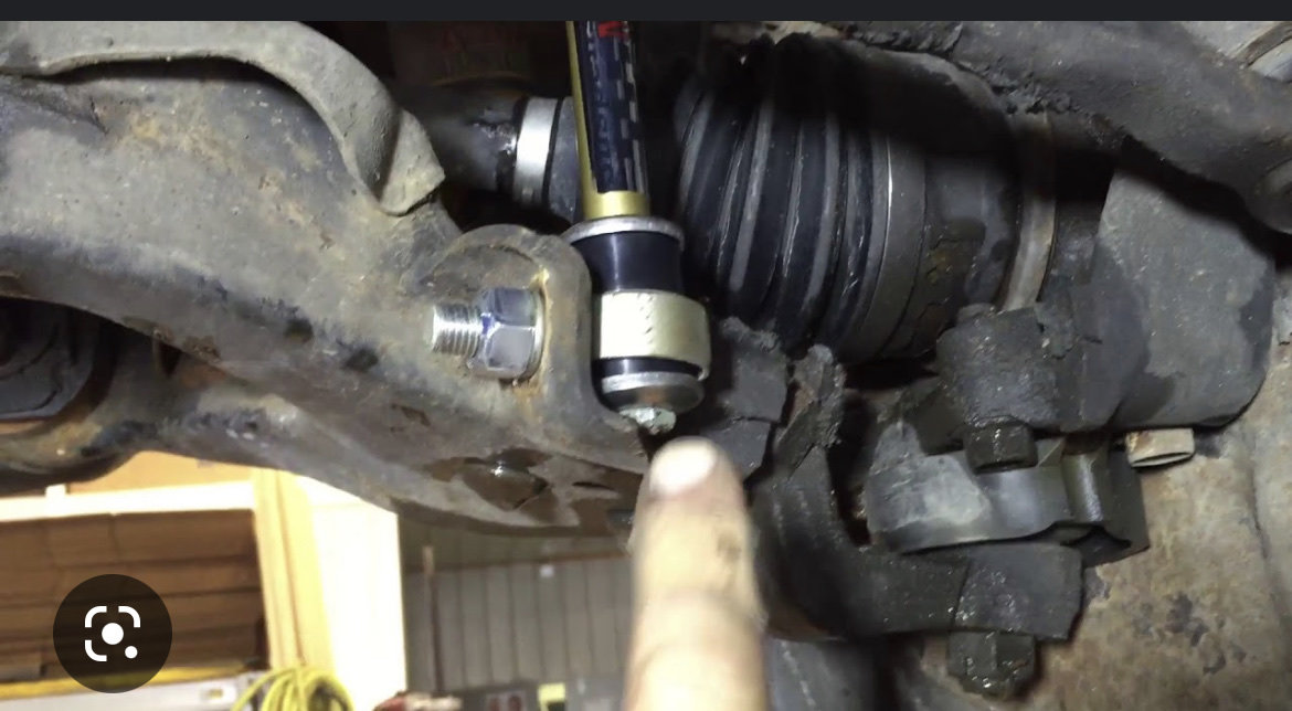

    I know I sound like a broken record, but you can easily check your sway bar link to see if it is loose. I have Moog sway bar links (cause they are cheap and easy to replace) every time I would bomb down desert wash board they loosen up and make a god awful racket. I thought my suspension was coming apart.
    The bolt is undersized for the hole and can make the link pop up and down.
    I put about 150ftlb on her and she’s been good since.
    The nut to the left of where he is pointing.

    I was planning on doing this today.
    So its not a MOOG which means it won't be eligible for a replacement due to the LBJ recall. Thanks for that info!
    Thanks for the pic. I'll double check the tightness of that bolt.

    Yes. artsr2002 identified it as Mevotech Supreme LBJ.
