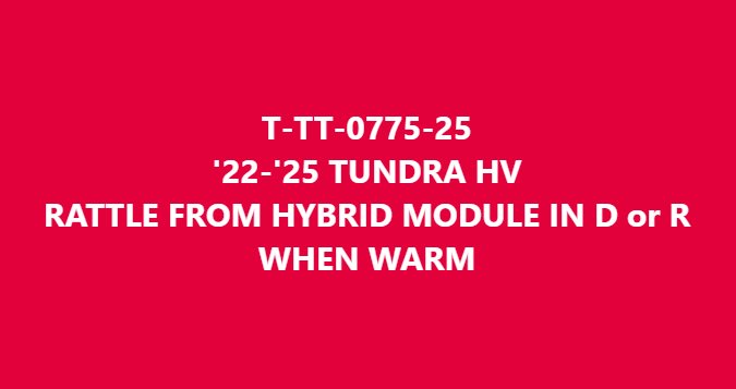

    #54
    jctmundra
    jctmundra New Member
    Jan 27, 2023
    #90987
    568
    Northern VT
    '23 1794 Hybrid Stunning Mesquite/Cream

  28. Jul 1, 2025 at 7:49 AM
    #58
    N1ck
    N1ck New Member
    Jun 2, 2024
    #117842
    6
    TSB did fix mine for a time period. It’s back after a couple of months. 31K total miles on the truck. I will have it back in and master tech agreed to speak to me about it.
  29. Jul 1, 2025 at 8:33 AM
    #59
    MikroT
    MikroT New Member
    Mar 25, 2025
    #132476
    38
    Dom
    2024 Tundra Hybrid
    Okay so any clarification on what the actual TSB is?
