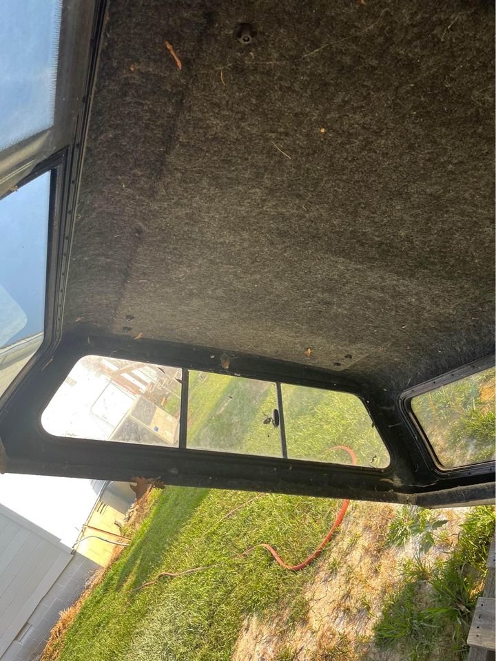

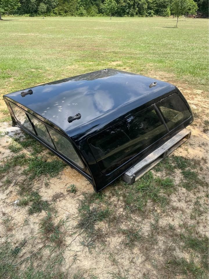

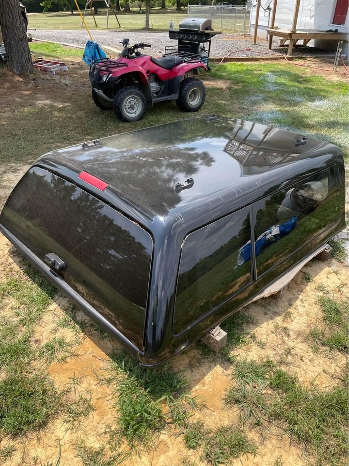

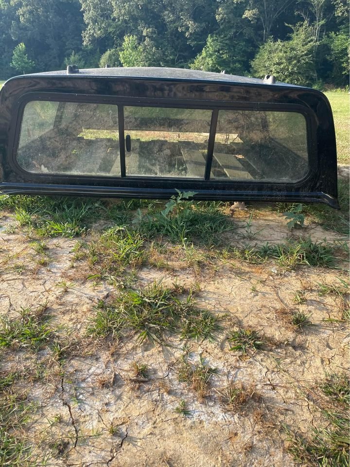

    Today was a home run. I found an ARE camper shell/bed cap for $250 on marketplace.
    It's in decent shape, with no cracks in the fiberglass and all the windows are there. The cap only has a few problems. I spent some time tonight addressing some of them. I glued down the lower trims that were coming off, as well as one of the window trims. I also spent some time vacuuming out some debris and spider webs. There appears to be mold on the roof carpet, so I'm probably going to take the cap to the detailer and have him detail clean the cap inside and out, including the bed.
