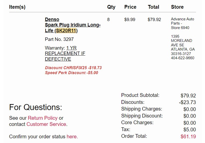

    Loosely fits the symptoms too - given the age on the plugs based on appearance, and misfires appearing on two different cylinders (2, 8), it's possible the old plugs are wearing out one by one. Given they appear to need replacement anyway... may as well knock out this routine maintenance.
    I managed to get a pretty solid deal, around $7/ea for my Toyota-recommended NGKs. @OP, the OEM suggested NGK plugs are these.
    $11/ea isn't exactly cheap, but I walked out the door ordering online from Advance Auto Parts for free store pickup, and got them down to $7/ea using a coupon. Advance always has 10-25% off coupons floating around - you can get 15% off today using coupon RMN15AAP and it appears the CHRISFIX25 coupon still works but only gives 15%, not 25%.

    Sound like a good price, checked with AA 15 per cent off internet order free shipping, that would help, we have a AutoZone and O'Rielly fairly close we'll check the prices
