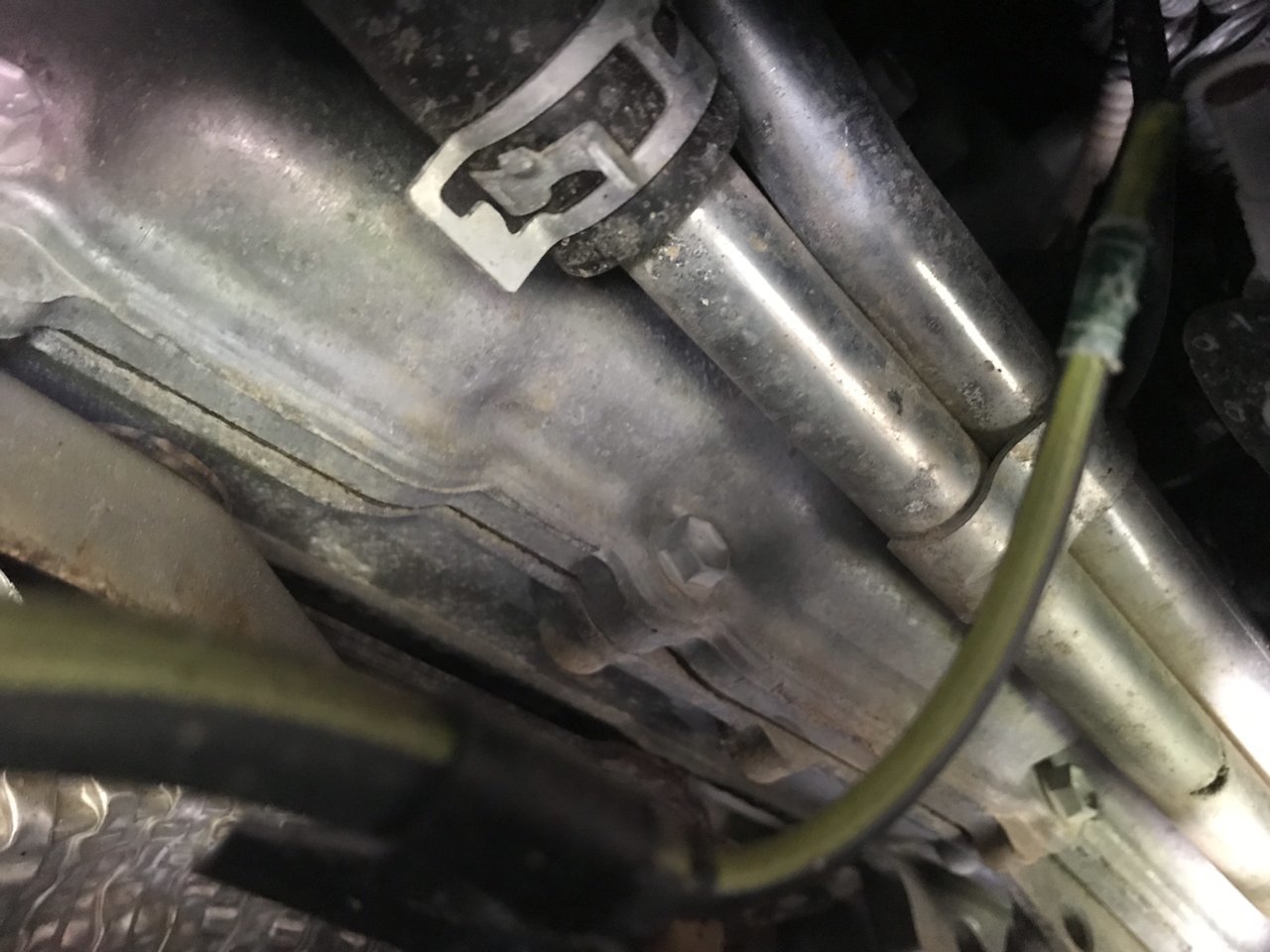

    It’ll look like a valve cover leak but it’s actually more expensive by several thousand. Look at the edges of the valve cover area for oil leaks. Under the valve cover is the system that holds the overhead cams known as the cam tower. You can see it from the wheel well area easier than just under hood.

    View for leaks from the wheelhouse or front wheel liner area.
