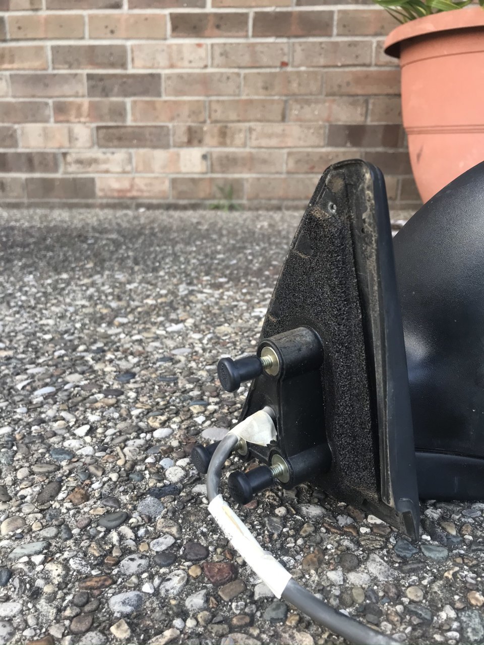

    I’m not sure about the Taco but I should have the info on the Tundra. Give me a bit and I’ll check my FSM.

    Lmao. My page updated after I wrote my last message. I’ll be looking forward to some pictures. Also, could you take measurements along all three sides of the base for reference. I’m curious to see how they compare to the ‘04 AC.

    Ah yes. I spaced about that. Will do. You mean the outside of the whole triangle or the little one that makes up the 3 studs?

    Both if possible but don’t pull them off if they’re already installed.

    Here are the new mirror base measurements.

    So. Mirrors are wired correctly and as good as they are gonna get form wise. Still need to road test them tomorrow. Bummed I can’t get the top to suck in more but it appears they bow out a bit which kinda sucks so I may have to revisit these later. Wish the blind spot mirrors were able to move independently but these mirrors offer so much more of a view over the stock ones

    Honestly until you posted the zoomed in shot I didn't notice that part sticking out. You could always try to use a heat gun to form them back down, or maybe try to Fuze them.

    Heat gun. Good idea. I’ll try that after I clamp them and use some fuze. Only worried about water getting in there and going into my door would be the main issue. Haven’t taken a test drive yet but hoping they don’t make any noise with wind at speed.
