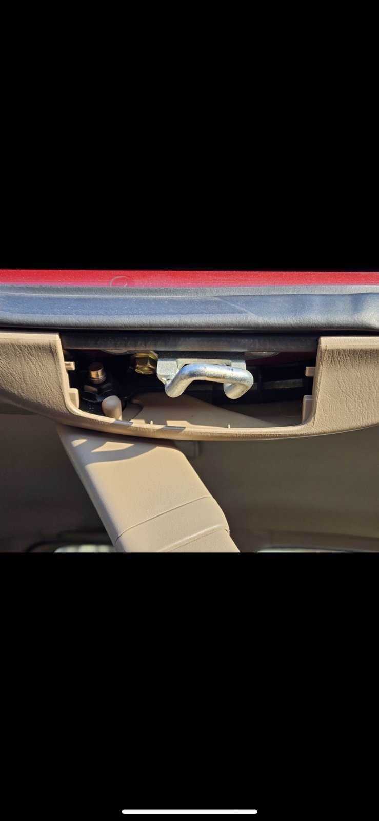

    Hello yall we’re a glass company that did a back glass on a 2003 Toyota tundra, we took apart the driver and passenger side panels that connect to the back glass and with removing the panels we needed to take out a screw that was connected to the seat belt on the roof, when putting back together we couldn’t find the clip that clips over where the screw is placed and need to replace it for a customer, can you guys help me find what this part is called and where to get it from!

    Is it a Dual Cab or a CrewMax? Hard to see what that bracket is for, too close of a pic

    it a crew max yeah i relize it is not such a good picture the bracket is attached to the drivers seat belt if that helps.

    @Mr.bee is right, junkyard is your best bet, you can find vehicles near you for that year and cab config easily at www.car-part.com and that looks like it's an Access Cab, there is no "crew max" for this generation, only the "double cab", and that's definitely not a double cab.
    If you want to look up the OEM part, and pay a fortune for it, use the info in the bullet points here: https://www.tundras.com/threads/howto-use-the-toyota-parts-system-to-find-order-parts.113808/
    You'll specifically use that website, go into the 'body' section, then search the page for 'rear door', I think it will be there, but you may find it in the 'trim' section of body also.
    Good luck!
    Looks like where the rear suicide door latches. Notice there's no B-pillar. Can't be a double cab.

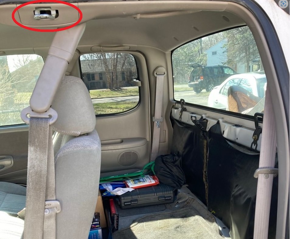

    Given Toyota refers to our 1st Gen Cab types as RC-regular cab/AC-access cab/DC-double cab and not "Dual Cab or a CrewMax", your search needs to be confined to Access Cab.
    Is the below circled piece what you're looking for ?
    If so....62476-0C010-E0(approx $20 non-dealer) should be the part your looking for if it's the driver side but caution to check with dealer via the trucks VIN # or Model Code. The E0 signifies what Toyota calls Oak interior which is what the color in your picture looks like to me ??....62476-C010E0 if passenger side.
    2000-2004 Toyota Tundra Front RH Upper Trim Interior Cap New Oak 624760C010E0 | Factory OEM Parts
