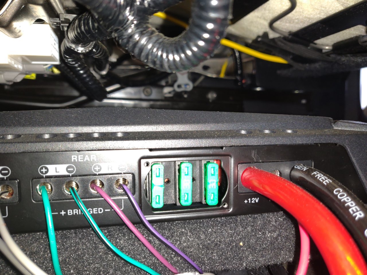

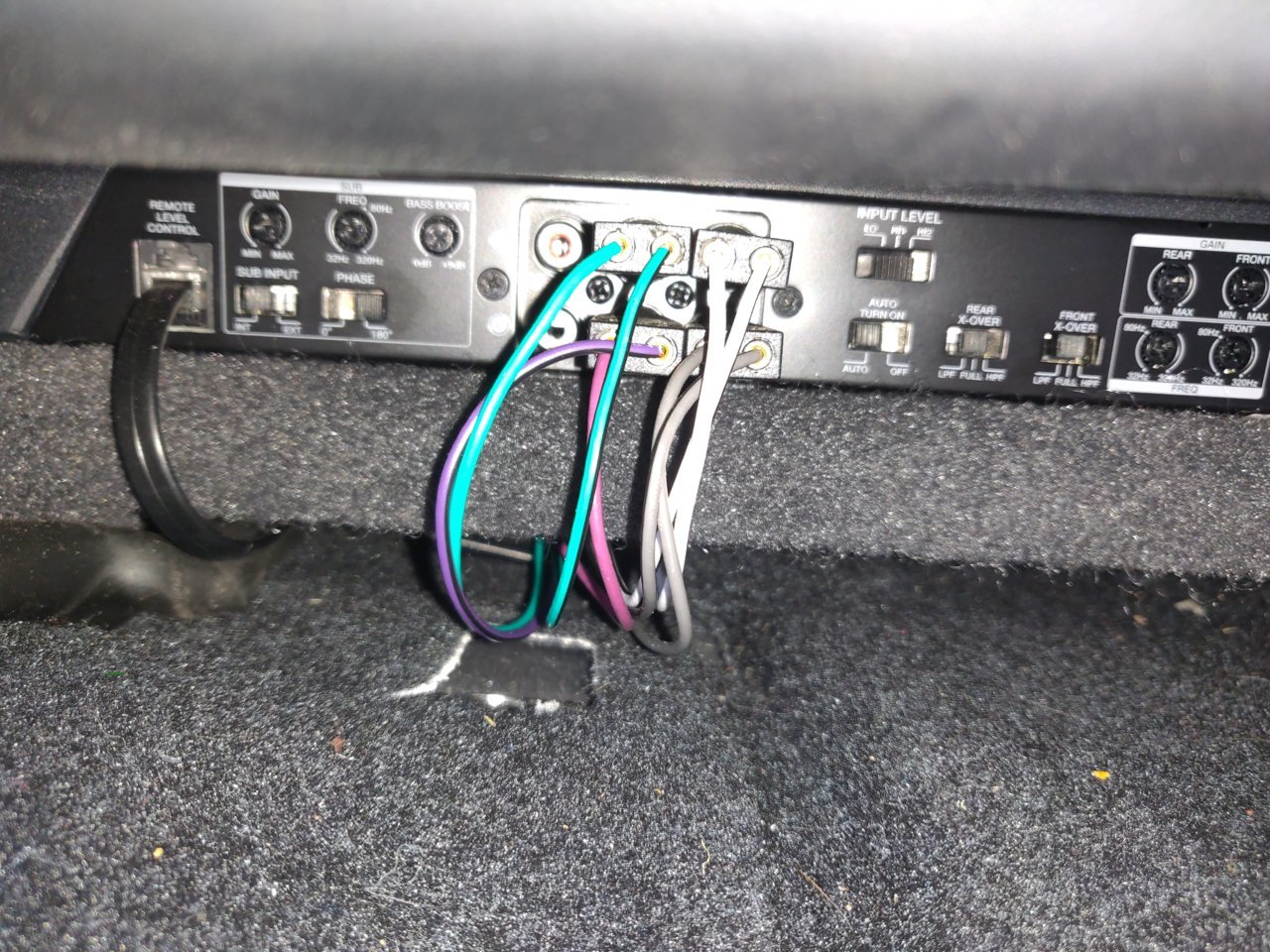

    Hi,
    I’m hoping someone can help me with wiring my amp. This is back to the basics. :(
    I appreciate the patience for anyone responding. I’ve looked at a ton of threads with wiring diagrams, but I’m just confused where the wires plug into the amp. ********* has some great videos, but their systems are more complicated than just an amp.
    I purchased my kit from tech12volt. The kit includes 2 wiring harnesses. Below is a pic of the pins that are included. I also included pictures of both sides of the amp.
    • I’m guessing the J145 harness connects to the amp picture labeled side 1, but not certain.
    • I do have RCA adapters, so I’m guessing I need to convert some wires to an RCA wire.
    • Pins 7 and 9 of the J144 harness has pins with no wires. Any wires I need to connect?
    • Any step by step help is greatly appreciated!
    Thanks :)

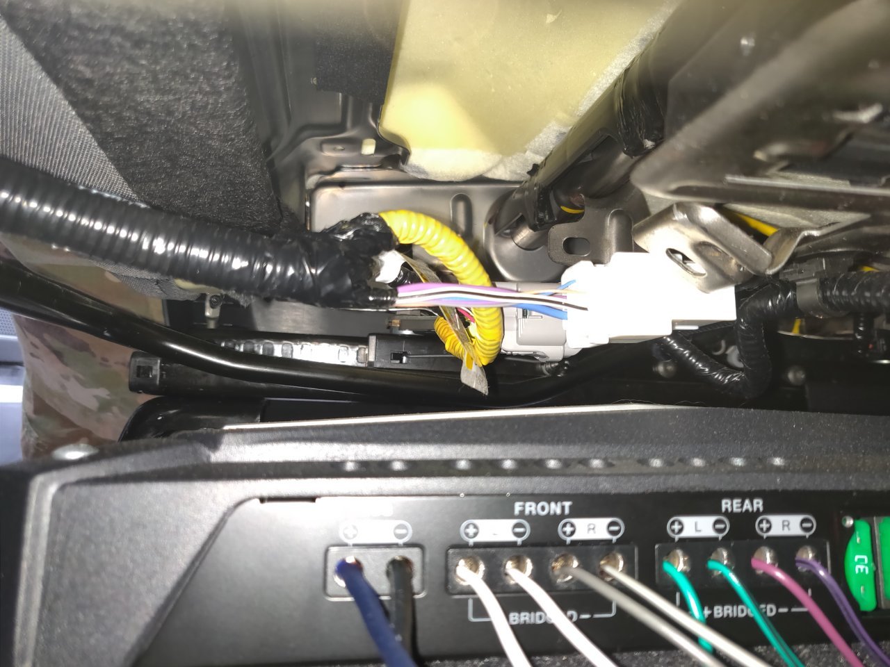

    So those are all of the connections. That with the instructions should help you out.

    i sent you two plugs that will plug into factory amp plugs.
    From the plugs sent use the following wires
    yellow wire no use
    red will go to remote turn on is
    on the two plugs I sent you will see a white and grey set of wires on the small plug. those are front door speakers . connect two sets of speaker wires to channel 1 and 2 black stripe is negative
    . The are rear door speakers are purple and green on big plug. these go to channel 3 and 4 black stripe is negative .
    The white pair, gray pair, green pair, and purple pair left over with rcas are go into the amp inputs .
    white and white black to inout 1
    gray and gray and black to input 2
    purple and purple black to 3
    green and green and black to 4 .
