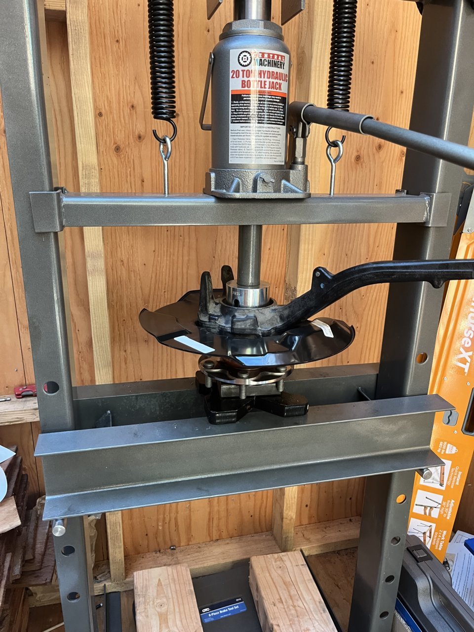

    IMG_4387.jpg Pressing it back together. I ended up trimming a shield for the smaller calipers. Only minimal trimming needed.
