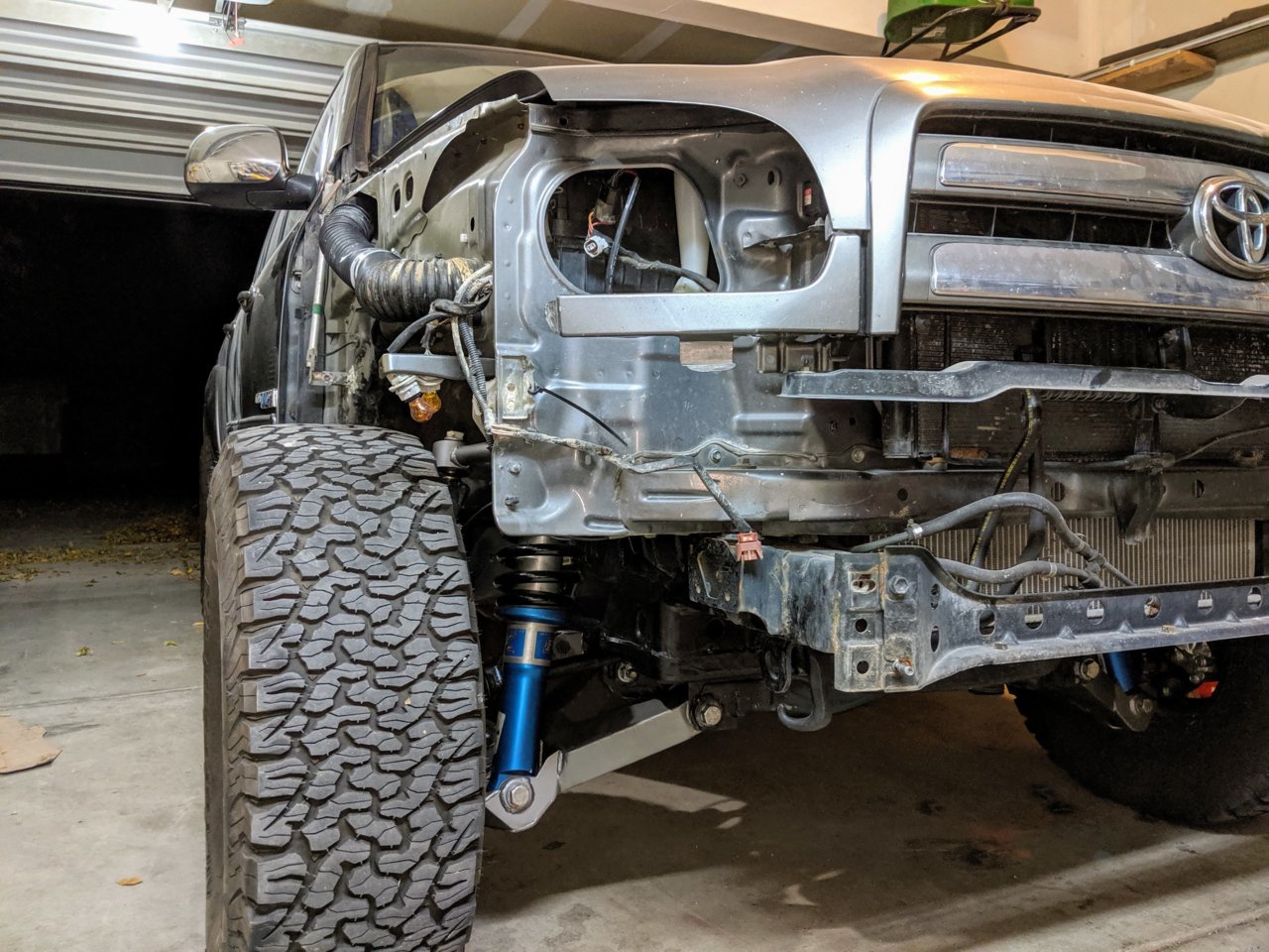

    Are you running ethanol free gas? Mine downshifts less with pure gas.
    Another option is to do the undercover snorkel. I can't say mine did a whole lot, but I think it helped some on the freeway. The intake noise is increased though. Sound deadening on the front floor and firewall really helps that. It's a cheap/ fairly easy upgrade. You can see the snorkel in the picture. It just routes your intake to the cowl. It requires the piping be modified and you cut a whole into the side of your cowl. I still need to replace my ribbed intake tube for a pvc pipe. One of these days.
    I'm running an aem dry filter and I noticed nothing from it alone. Putting a straight through muffler on my truck might have helped a tiny bit though.
