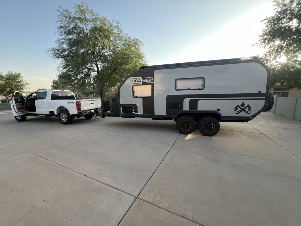

    Yep old man loves the F-350. Hauled the offroad trailer the following week of purchase from AZ to Tennessee. Said it towed like nothing was there power trains awesome and the 10speed is magic

    What gear ratio is he running?

    3.73s

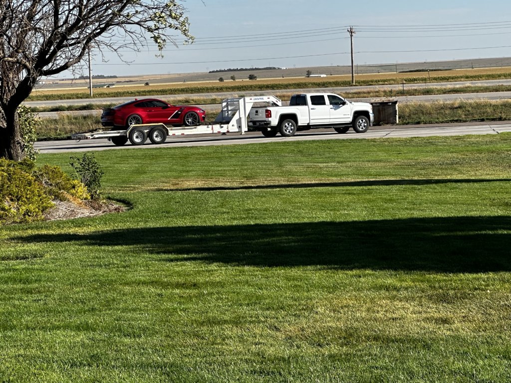

    41,303
    Don't be afraid to grab a flight or travel. It can save you thousands.
    This trip to another state saved me around 12-13k.

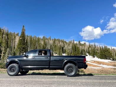

    Bought my Ram 3500 new in 2020 from Dave Smith motors in Idaho. I flew out from San Diego with my bil and we drove it back. Just to turn around and move three families cross country puling a 28 foot car hauler back to back to back. Since that time we have racked up 120k miles driven coast to coast 15 plus times pulling a 17 foot open trailer as well as running naked. including stops from Atlanta to Jacksonville to Deep South Texas to San Diego and back several times. I primarily cross using the southern route I-10/20 and I-8.
    I'm on my third set of tires. I have had recall work done from cp4-cp3 wheel studs and tailgate lock. I stay up on maintenance and so far to it's been a solid truck. It's not cheap, she rides like an Abrahams especially in Louisiana and Texas. I do try to map out all my trips from buc'ees to buc'ees (they just opened one in Mississippi on the 10) If it were a shit show i'd speak up too. I'm gonna do the intake and pedal commander by banks. A Carlie suspension upgrade with the torsion front axel and a fast fuel kit. Big Red has been good to me. I know it's not the case with many Ram's but mines been solid. I'm interested in the new 8 speed and if they hook up cummins to the Allison I wouldn't cry either. Happy shopping. Chris you always get the good inside baseball brother.
