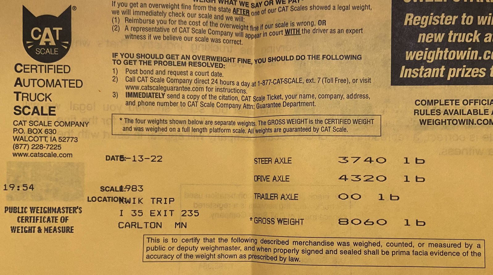

    My current rig (1 ton van) has no problems with the weight. My main reason for wanting a truck is due to my use and loads changing, especially now with a travel trailer, I would like a truck bed for items like gas cans and generator.
    Two of my trailers have aluminum frames and do not allow using a WDH, but even with a WDH the 1/2 tons just don't have enough payload capacity. My empty van is over 8,000 lbs, by empty I mean the gear that is always with me is in it, but before any load is added. I also prefer the larger brakes and rear leaf springs in the HD trucks for towing.
    The last time I weighed my van "empty" it was 8,060 lbs. That was a couple years ago and I've added some "have to have it with me" gear since then so would be a bit heavier now.
