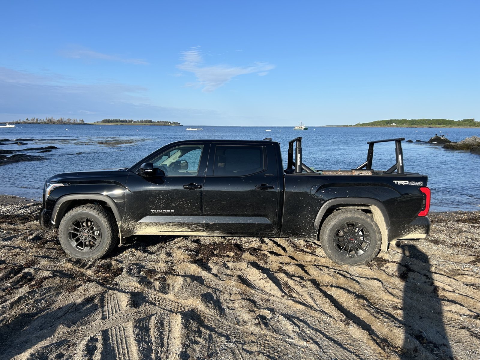

    285/65/20… 34.6”. No rub.

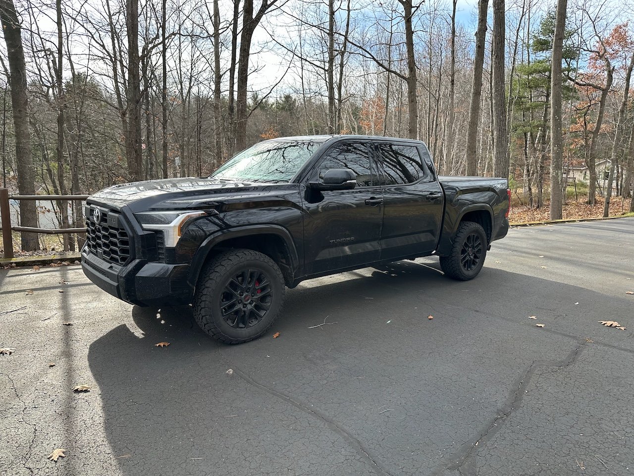

    Here is 285/60/20 General Grabber ATX on a TRD sport with 2" front 1" back lift.
    I did the lift after the tires... when it's time for new ones I'll probably go a bit bigger.

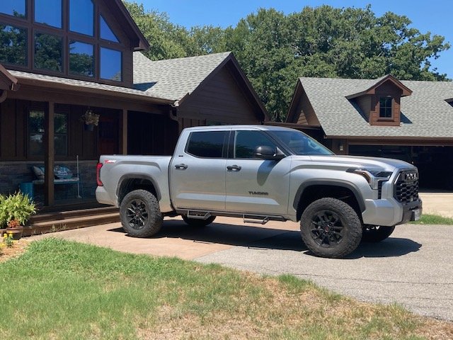

    295/65R20 with TRD Lift.

    I did spacers -- Readylift on the front and Cornfed on the back. Saw no degradation in ride or any type of function.
    I absolutely hated the rake and 2/1 did a pretty good job of taking care of it without looking too out of balance when I pull the boat.
    Grabbers have been top notch in Northern WI snow.

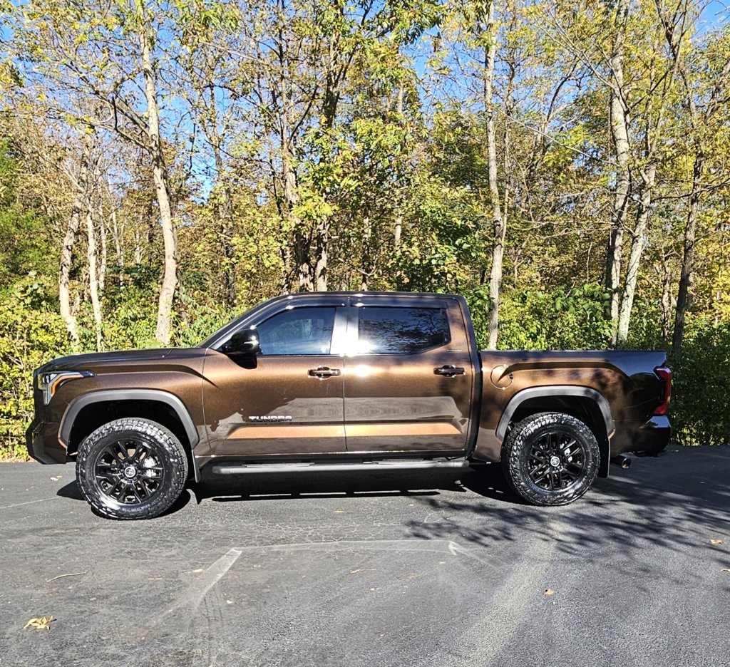

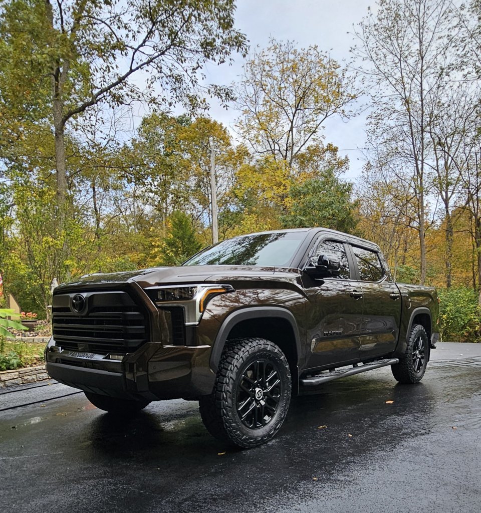

    285/65R20 Nitto recon grapplers. 1.75" Rough Country level in front, nothing in rear. 20241015_113607.jpg 20241011_155426.jpg

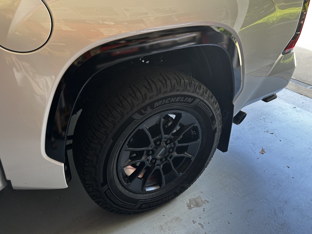

    295/65/20 Michelin Defender Platinums
