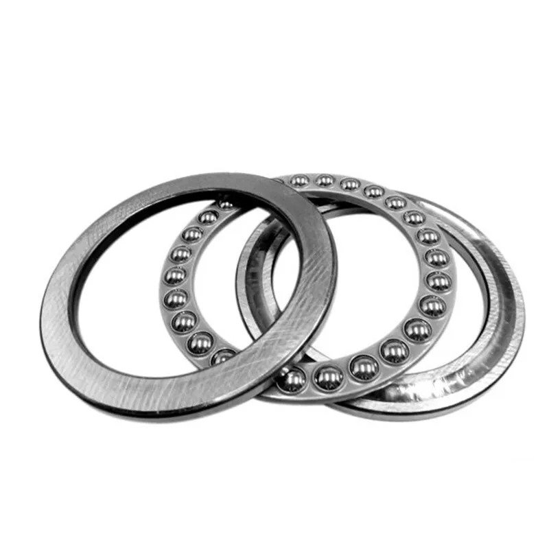

    Maybe a thrust roller bearing with a 13mm inner diameter and a small enough outer diameter and a spacer will make front stud install easier. One manufacturer lists their 51101 thrust bearing as having 13mm ID and 26mm OD.
    You can see the OD for the Lisle tool is about 39.5mm wide.

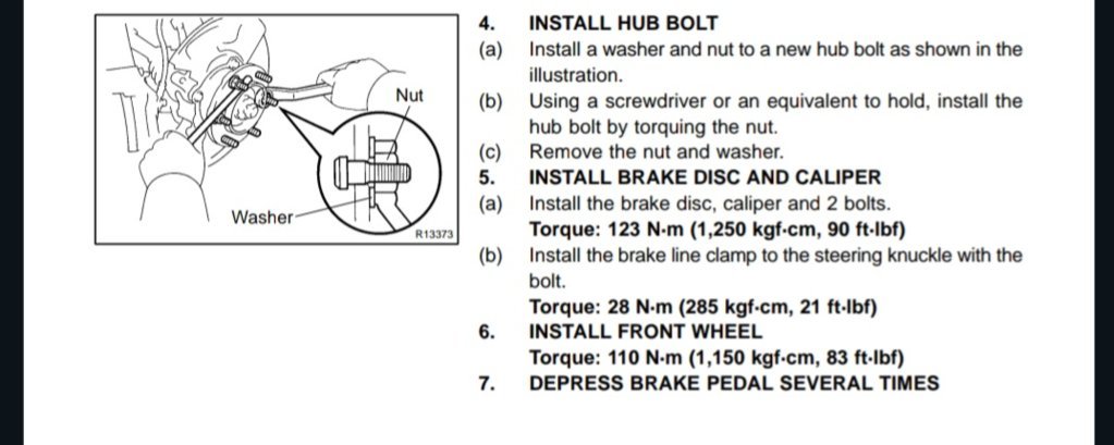

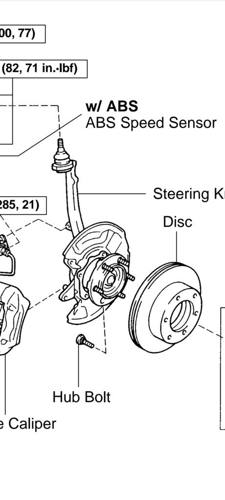

    Looking at the FSM you may just be able to get away with the thrust bearing and the open ended lug nut to install front studs.
    FSM calls for just using a washer. Again, the rolling motion of the Lisle 22800 makes installation smoother as your torque wrench isn't fighting the sliding friction of the lug nut and spacer across the hub face.

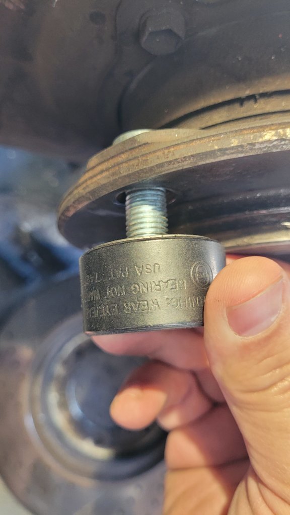

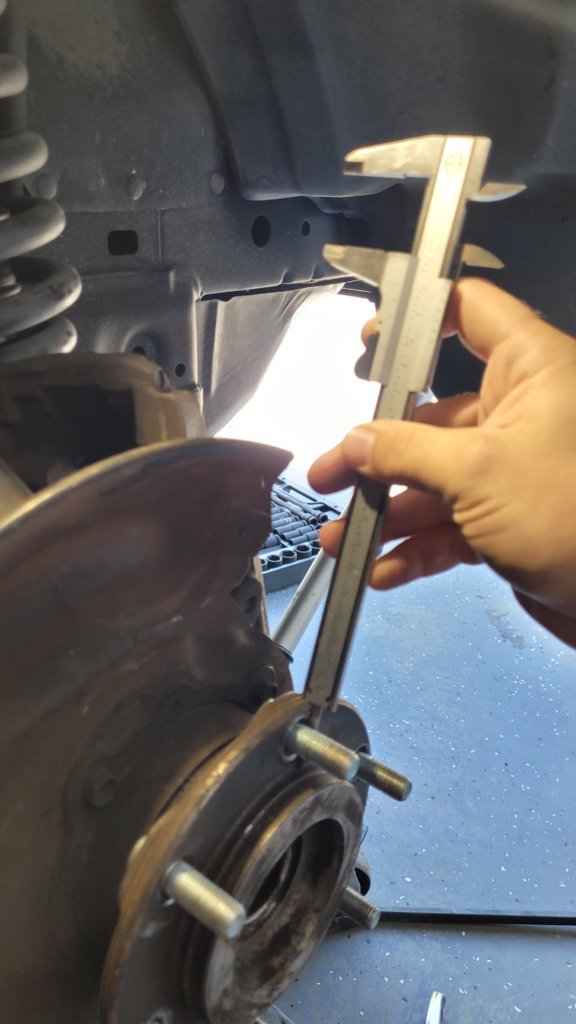

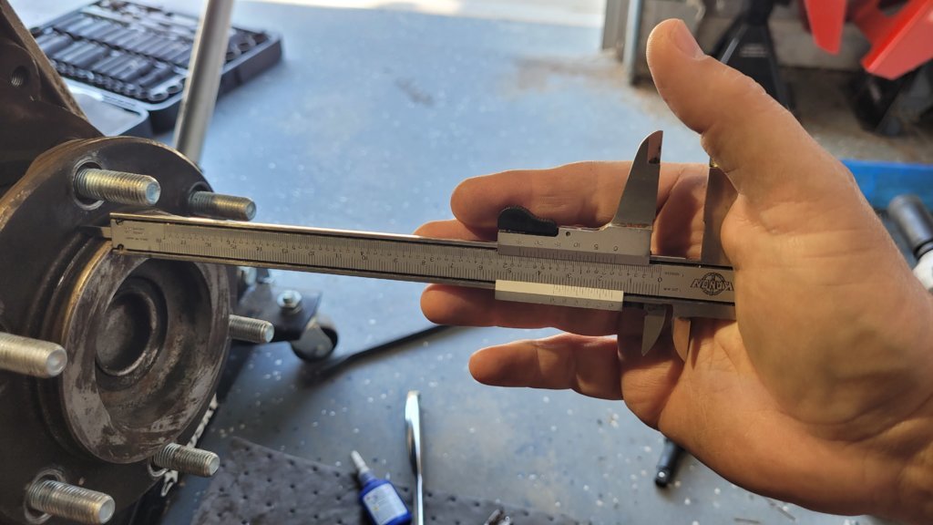

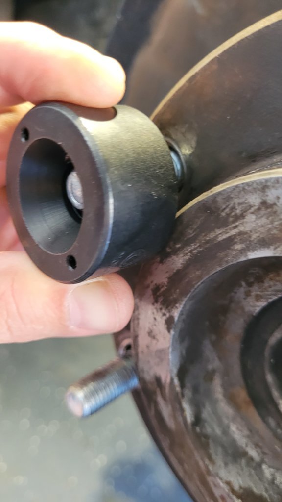

    Ok, luckily for posterity a stick-on wheel weight fell off and lodged itself between my rotor and dust shield. Gave me the chance to post pictures of what I'm talking about.
    The Lisle tool is 39.5mm wide so it collides with the raised center of the hub when centered on the stud.
    From flange to hub center is 15mm high.
    Flange width is 30mm.

    Deep socket and a c-clamp would work in this case.

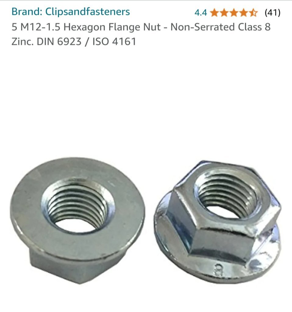

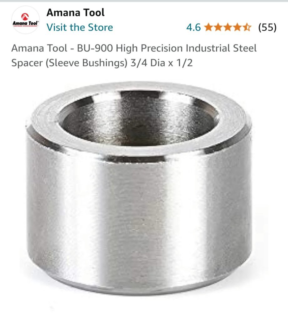

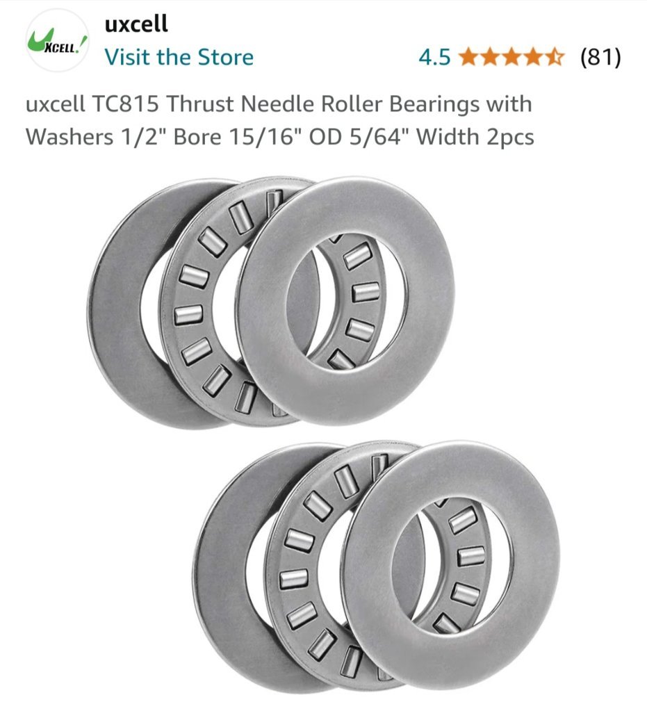

    Again, to overcomplicate things I ordered stuff from Scamazon to replicate the Lisle tool.
    This will allow someone to use a torque wrench to tighten the studs to the FSM prescribed 90ft-lbs.

    Why are you adding thrush bearings? There's no need to rotate -- you should be pulling straight out. You're just going to crush the rollers.

    Just because that's what the Lisle tool uses. The twisting motion alleviates the friction of the spacer against the hub face allowing the nut to turn with less effort drawing in the splined stud.
    The bearing is 1/2 ID with 15/16 OD, spacer is 1/2 ID with 3/4 OD, and using a flanged M12 x 1.5 nut. This should distribute the force over a majority of the surface of the roller bearing.
    It's the whole reason people recommend the Lisle tool to begin with. It makes installing studs easier.

    I'd be very hesitant to use those standard height grade 8 nuts. I'd look for an extended length nut so that you have more thread length grip.
