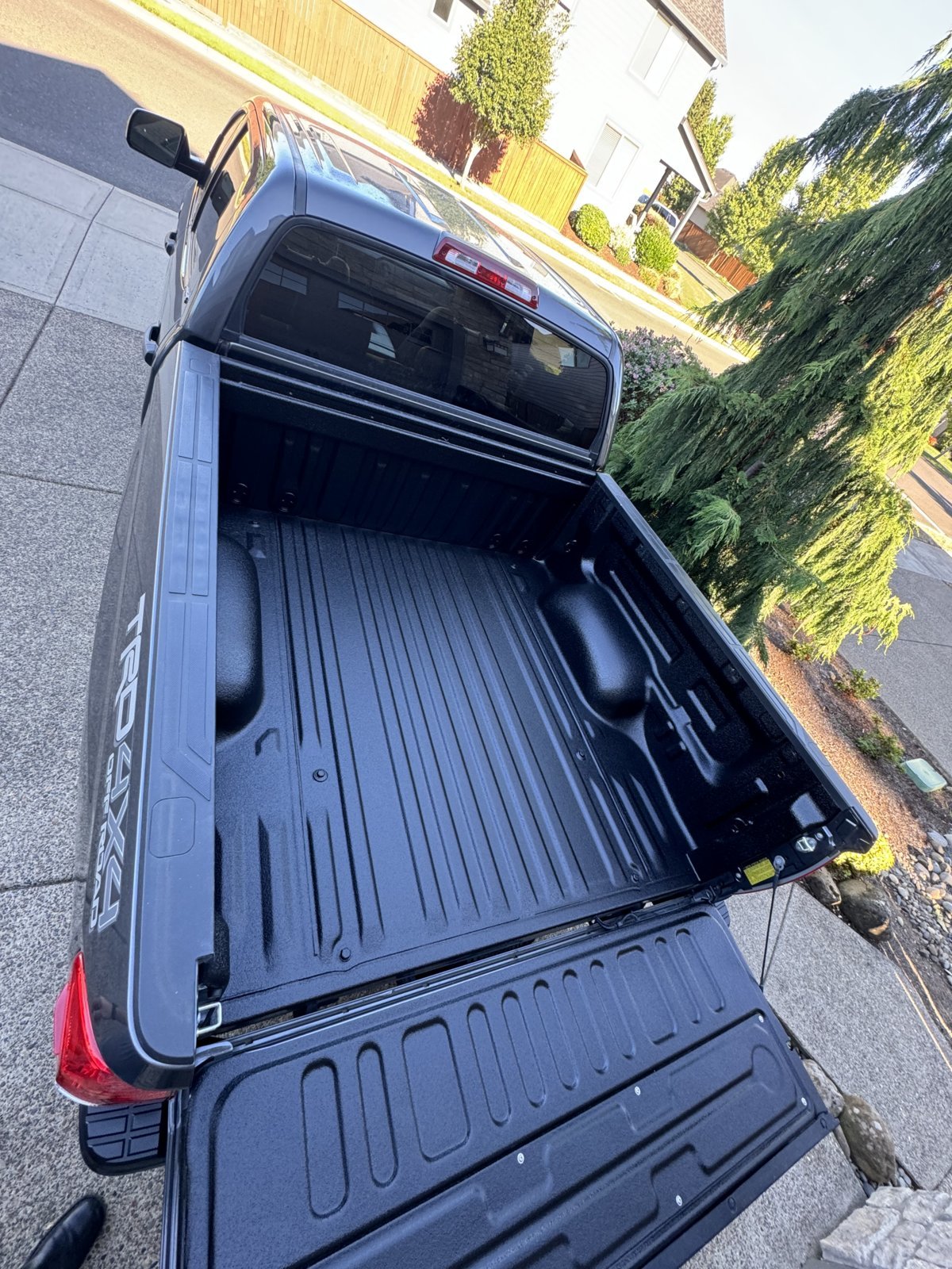

    Most all places will stop the coating at the flat of the back of the bed and the sides, same for the tailgate. I specifically asked to coat the "crotch" of the bed and tailgate, as well as the corner "crotch" of the bed and tailgate. This area is where any and all shit that you might load into the bed will hit or fall. The guy questioned me when I asked, but then realized that it makes sense! This way if you ever take your tailgate off, the vertical surface of your bed down to the bumper is coated as well as inside of the tail lights. So if you're pushing anything big into the bed, nothing will hit paint. A pic of mine for reference:
    It only needs a thin coat but it's nice to have those areas protected.

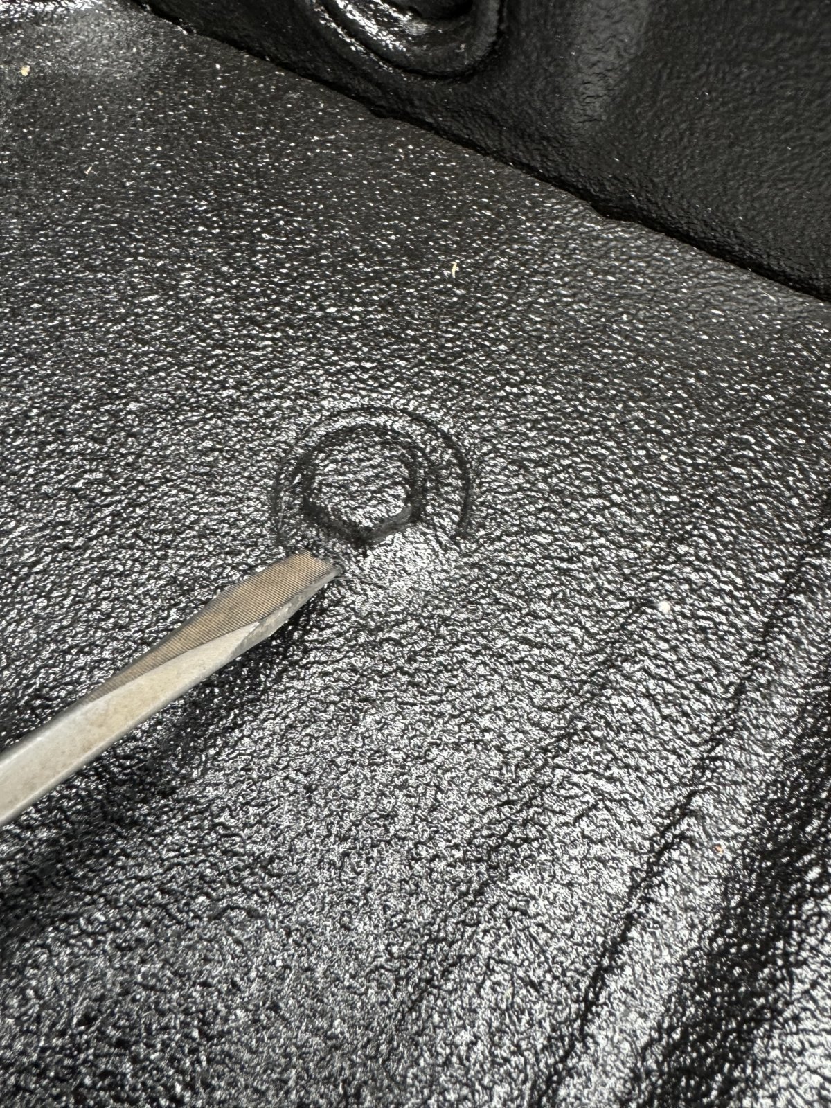

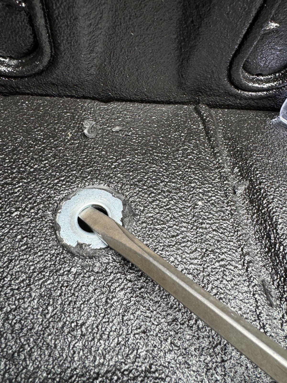

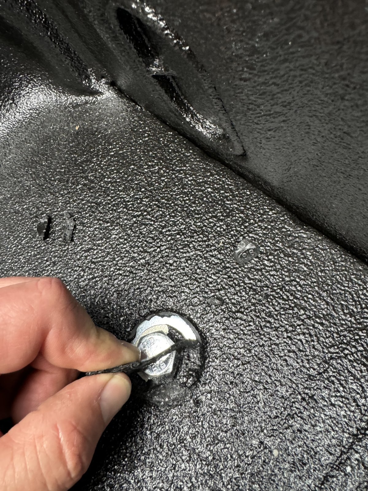

    I'm back! I got the quote for the premium and it's about what I expected $700-ish.
    However, when I asked if they would remove all of the hardware, they said they would remove everything, but not the bed bolts.
    I thought most people left the bed to frame bolts uncoated?
    Anyone?

    Yeah that’s unusual, my two tundras that were linexd had the bolts removed. It’s actually just a big T55 bit I think and they can just unbolt with a ratchet. 700$ for premium is a good deal, mine wasn’t much less in 2021.

    When mine got coated, they didn't remove the bed bolts either. When the bed needed to be removed for collision repair, I had to cut around the bolts for the bed to come out. When put back, it didn't look as nice. So I'd ask them to take off the bed bolts before lining in the future.

    Take out bed bolts yourself on site??

    That's what I'm thinking.

    Same thing here, bolts were removed, and it still looks good after almost 4 years! I think it's probably the "standard" line x vs the premium because I talked the stealership into paying for it if when I bought the truck.

    Mine have never been removed in the three trucks I’ve had it done in. Never had an issue with it either. Not like I need to remove the bed often. And if so, a wire wheel makes easy work of stripping it.
