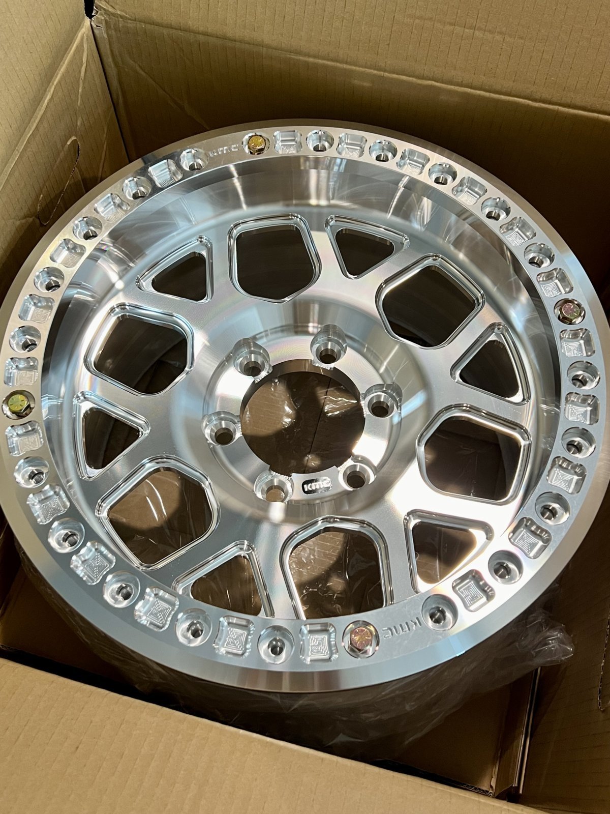

    90% of us would find any cast wheel plenty strong for it's application. More important, is buying from a reputable company with good manufacturing processes and QC. You can learn a lot about a company by researching and/or talking to them.
    For me, I chose KMC Mesa Forged Beadlocks for my Tundra. 26 lbs per wheel makes it one of the lightest and proven beadlocks you'll find. Most beadlocks, forged or not, scale at 30+ lbs. Innov8 wheels, which are also pretty coveted, weigh 35 lbs for an equivalent size G600 and G400. I do like the anodized gold color though.

    Here's my KMC Mesa Forged Beadlock "Blank" load rate 3700lbs at 29lbs per wheel. KMC don't offer them for 2nd Gen Tundra I had it drilled and bored

    Awesome! Nice that you were able to get them drilled for the Tundra hubs. The only thing for me was the 108mm bore vs the 3rd gen's 95mm but I've never had any issues using good hub rings. Maybe it'll be hub centric if/when I upgrade to some Camburg hubs.
