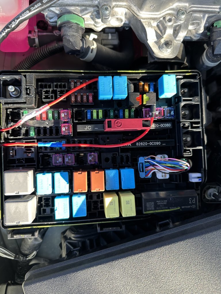

    What do you think caused the post to come loose? Now im worried. Was on a previous wiring thread with you, i tried the post but because it was always hot I decided on the pictured approach instead. You think toyota would ever try and blame me for this pass side fuse setup? Top wire is raptor lights (includes existing bottom fuse), bottom is going light bar (unused fuse). Both only turn on with ignition

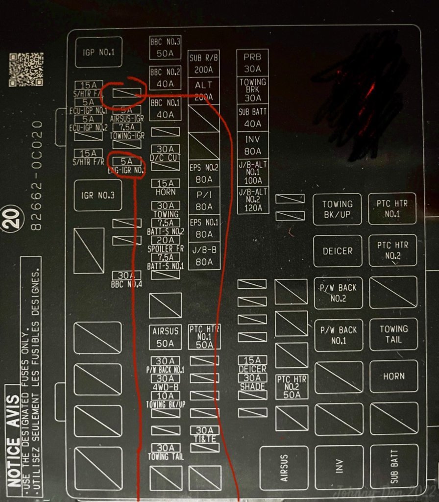

    I tapped into an underhood fuse, one that was not being used for anything according to the schematic. I made sure that only one fuse was installed and it was for what I was powering only, no need to install the second fuse since there was nothing stock being powered. https://www.tundras.com/threads/1794-le-mod-diary.150206/

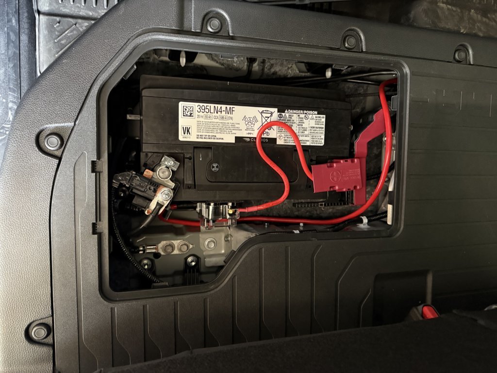

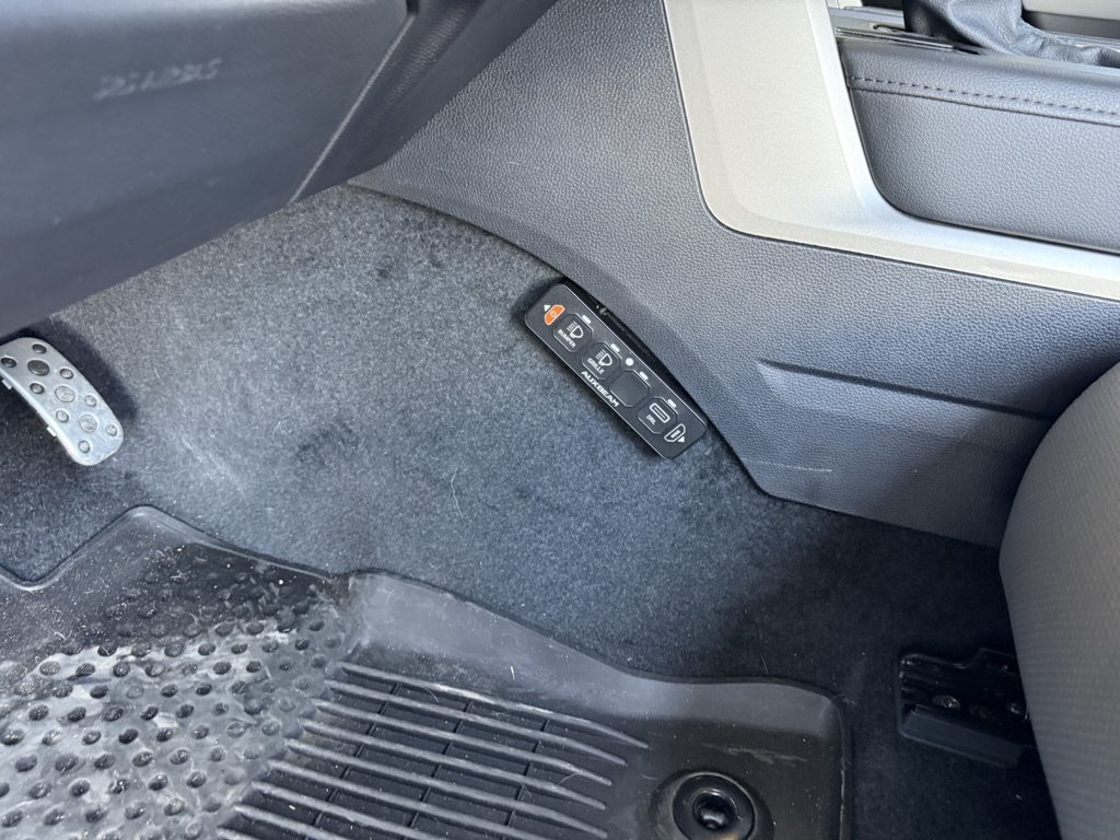

    After careful consideration and research, I've decided I am going to mount the original included lightbar relay under the rear seat in the battery box. This way, I can connect 12V+ power and ground from the relay directly to the battery with short leads. I can run the three switch wires from the relay under the door sill trim to the dash switch. Then I'll just need to run one 12V+ off the relay through the firewall and out to the lightbar. I will ground the lightbar to the body under the hood.
    Is my logic sound? I'm just trying to avoid running a bunch of wires through the firewall. If I mount the relay under the hood, I'd have to run five wires through the firewall (three for the switch and two for the battery connections). My plan only requires the one wire.
    Only downside I can think of is I may hear the relay clicking when I turn the light on/off.

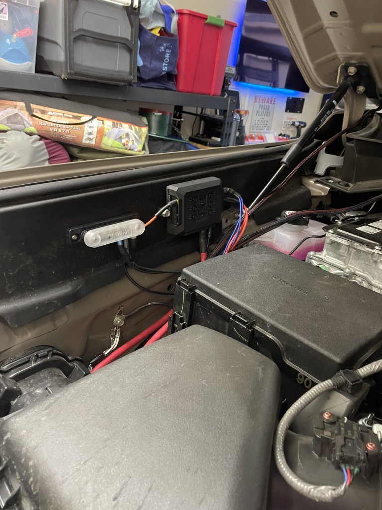

    Well, went ahead and wired up a Garmin PowerSwitch to the fuse box post today. No issues currently, but have only wired up some ditch lights so far.

    Are the add a fuse taps directional? I see you have them led off in opposite directions, thought they had a hot side and then wire lead side so current goes through the fuse?

    Still working well? Where did you mount your PowerSwitch?

    Working fine. Still waiting for my diode dynamics ditch lights to arrive, so just have the rock lights currently. I have it mounted to the plastic fender liner near the fuse box. I’ll post a pic this weekend if I remember.

    I still need to clean up some wiring, but added some ditch lights today. I have the garmin powered from the post and grounded at the factory ground point right there and added a bus bar grounded to the body at an unused bolt hole. I only plan on adding lights to this garmin, so hopefully no issues. Gonna try and run a trigger next weekend from the ignition fuse.

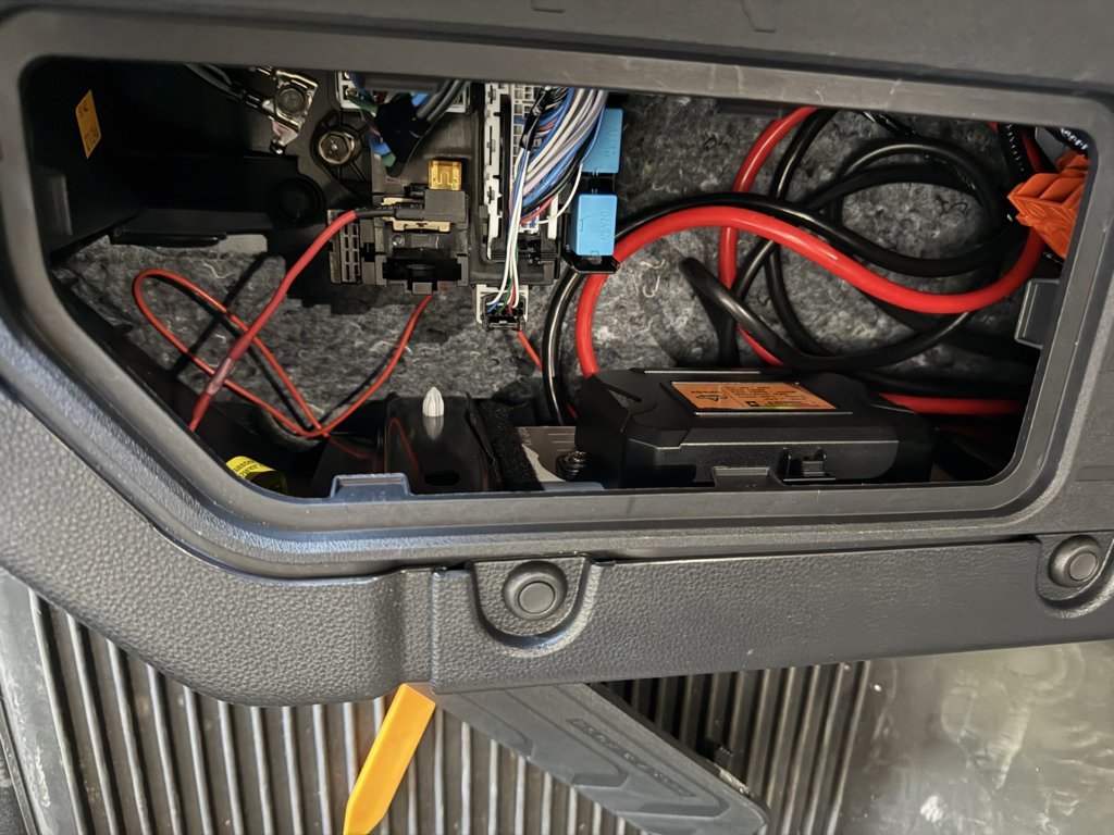

    I ended up getting a roll of 2-12 AWG marine grade wire, and some longer 7 AWG battery cables. Looks clean enough, just need to tie up the slack.IMG_0143.jpg IMG_0144.jpg IMG_0138.jpg IMG_0142.jpg
