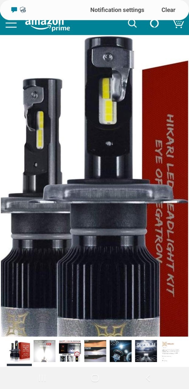

    Thanks SimplyTheTrue for the no thrills straight talk. Would you know by looking at this pic what those metal things are on the tip of the light bulb?

    That is a Reflector Bowl for your High beams! When you hit your High beams, that little Scoop directs the Light upwards towards a different arrangement of Reflectors, creating your High beams! Make sure when installing an H4 bulb that the little Bowl is facing up in the housings, like a Bowl of Cereal! :)

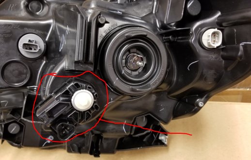

    Ah yes the In-Cab adjustment, such a nice feature! That will work with LEDs as well, so no features lost! There is a little Motor on your Headlight that turns an Adjustment gear in the Headlight, lowering or raising the Headlight bucket to direct your Beam Pattern!

    Yes what @Headlight Revolution said, a reflector, used with high beams. That cup should face upwards when installing/cup on bottom facing upwards.

    I always thought the little shield was used on the low beam and is responsible for the sharp cut off line?
    Cup facing upwards directs the light to the top of the reflector which reflects down on the road. The second led chip that is uncovered gives full light to the reflector housing for high beam.
