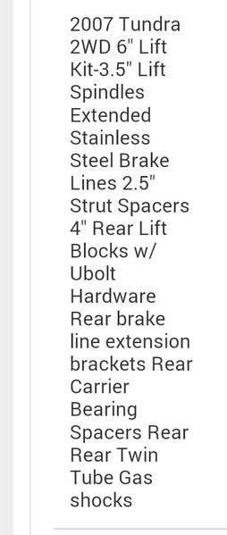

    Question I just got my lift installed about a month ago and its not high enough in the front. Id like it level with the back so can I add a body lift in the front maybe 3 inches or less here is what was done to my truck thanks for the help.

    Sry if I posted the picture twice dident show up on my phone

    Check out coach shackles...that may help.

    You cannot just put a body lift in the front of your truck. A body lift is just pucks that go between the cab and bed mounts and the frame. It lifts the whole truck up off of the frame evenly.
