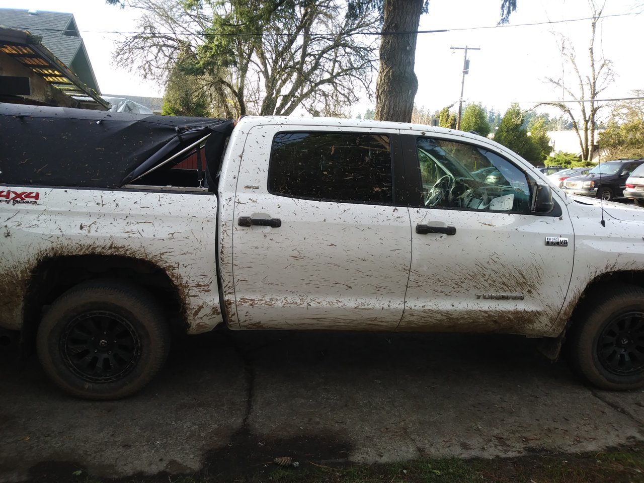

    Brand new here, From Oregon, I have a 2015 Crewmax that I'm trying to finally get lifted! The OME 614s are appealing and in my price range. I'm lost on what to do with the rear though... Shackles? Add a leaf? I'm not super knowledgable with lifts this will be my 1St. Please help me on this one with part #s that I can look up. In all I'm looking for approximately 3". Thanks! 20190101_144135.jpg

    Look at your rear shock options. Most of them max out at 1.5-2 inches of rear lift. Beyond that and you’re looking at custom mounts.
    Go shackles

    For the rear lift I would do shackles. I believe the rear shocks that come with the 614’s complete lift are good up to 3 inches.

    With 3" in front, you're going to want about 1.5" of lift in the rear to keep a decent rake. I'd do shackles from toytec or coachbuilder. @chphilo has 614s on his Gen 2. Do a search for OME 614, there are several threads talking about them

    Welcome. Since it appears you go off-road, do shackles in the rear; no blocks.

    Welcome from CO. OME Dakar leaf pack.

    Save a lil longer and get King coilovers. I don’t regret it (except price)! Unbelievable ride and response.
