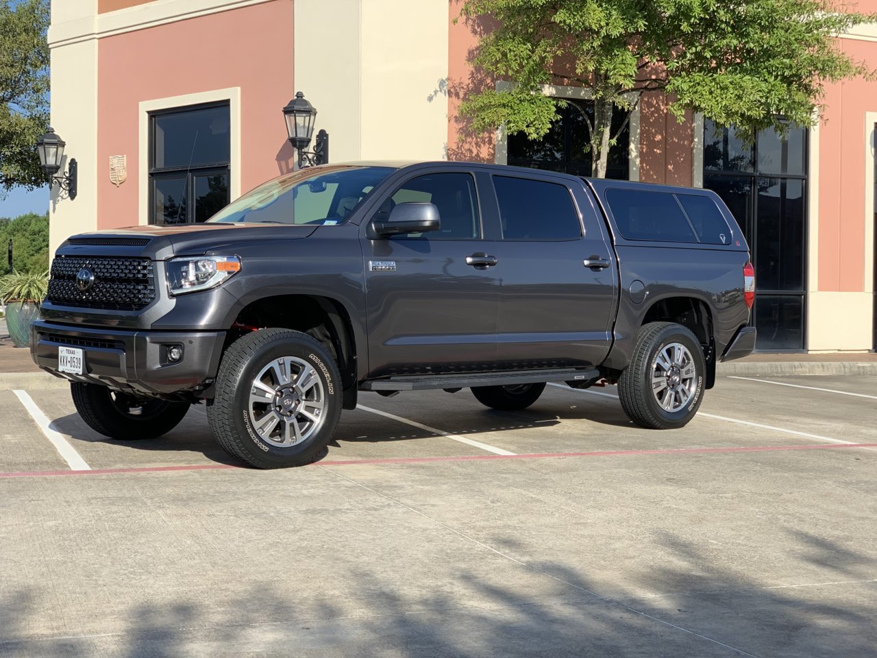

    Leer 100XL, Bedrug, Go Rhino running boards, LED int/ext lighting, Bilstein 6112/5100 1/2”shims up front, Coachbuilder +3 shackles, CB drop, TRD front/rear sway bar, 275/65/20 Michelin LTX M/S 2, sequoia painted mirror cap/door handles, Rago Fab low pro ditch brackets, Baja Designs S2 sports ditch lights. Baja Designs S2 sport rear flush mount pod

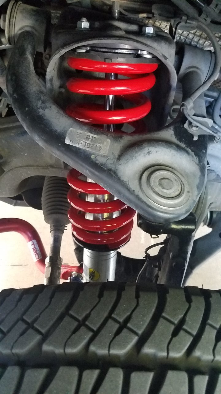

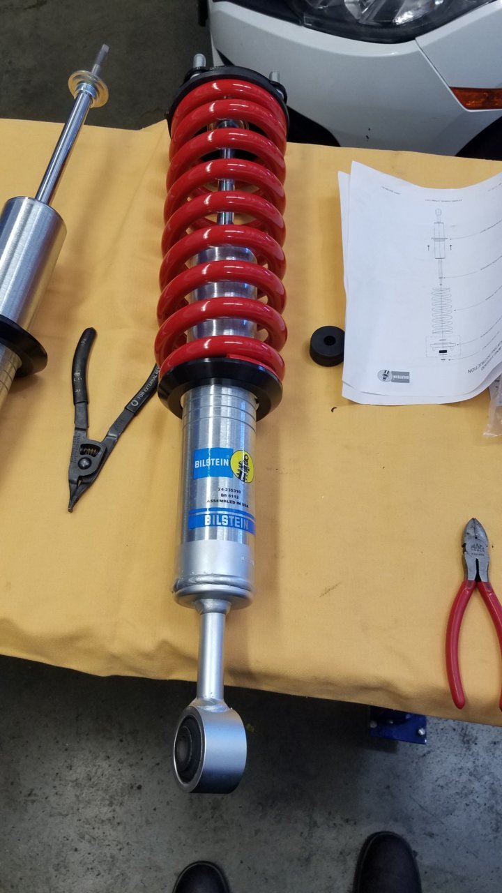

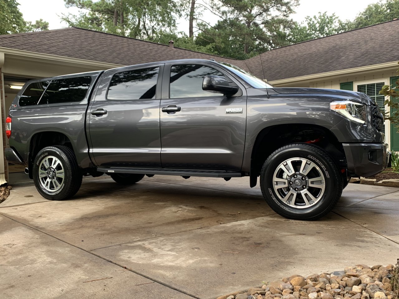

    As for wheels I haven’t much to say since I kept mine stock. However I am running the 6112 at top setting with 2 cb shims on ds and one on pass. The rear is 5100 shocks along with the coach builder +3 shackles. I went ahead and got some JBA HD UCAs for alignment. I gained 3.25 up front and close to 2” out back. You can see my truck sits a touch nose high but since I lifted it seems to have settled a tad but still a tiny bit nose high. So you might be good only running one shim on ds to keep it more level. Good luck and make sure to update us with pictures!E22C9915-C07B-48F3-9A39-DB3174582909.jpgE2340D65-B30C-49D4-904E-4160705B5680.jpgFD94D6CD-3A54-4374-886B-3FE5CA981386.jpg
