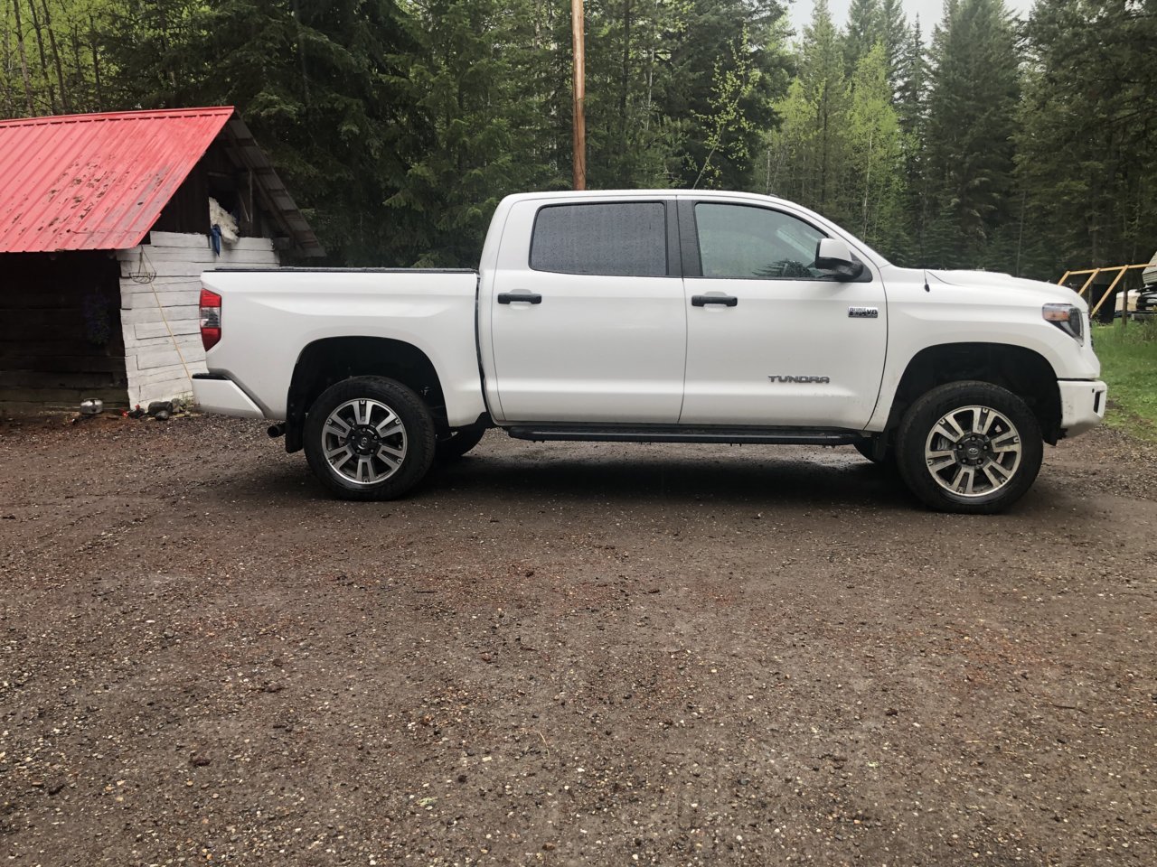

    Looks pretty sweet. I installed the same kit in my 2019 sport and ended up tightening the drivers ring 3 turns and added a 1” rough country spacer in the rear. Alignment is great and sits with slight rake forward so sits level with the trailer hooked up or the Costco haul loaded up. A8EAEF4A-674B-4CE4-8C50-310DC59E00A4.jpg

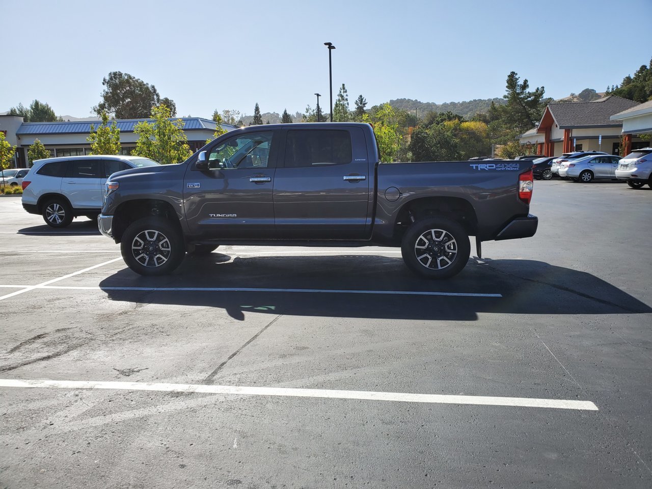

    Hey Dave, they're right, it doesn't settle much. After about a month of driving around, I got used to it. Its been over a year?! now and depending on the angle it looks a bit nose high. I want to replace the real shackle with a 1.25" or 1.5" coahbuilder, but havent gotten to it yet. Here's a pic of the truck 6 months after install. It looks good but if bed is loaded or I'm towing anything, it squats in the rear.20191023_131148.jpg

    Thanks for the reply "T". Your Tundra looks leveled nicely in that picture! I just removed my old struts, shocks and UCA's yesterday out of the bed so hoping that with the weight removed it will help some. I too wondered if the 1.25" coachbuilder shackles would make enough of a difference or not. I'm thinking if I'm going to invest another $300 I might go with the 1.75
