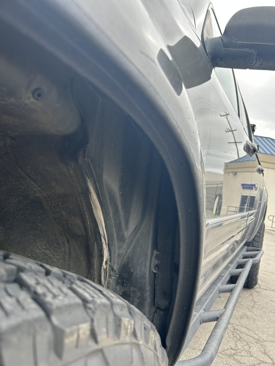

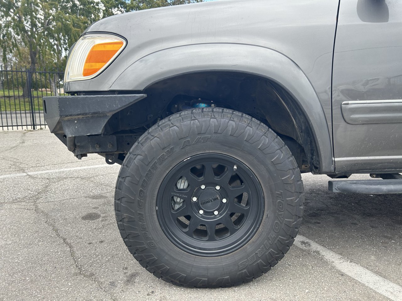

    Pic just for reference, 4.75" backspace with 1.25" spidertrax spacer. no frame rub but rubbed on the pinch weld. @alb1k found the the happy medium with the 3/4" spacer but he is also running a bigger tire.

    Method 305s 17x8.5 4.75" backspace with 285/70/17

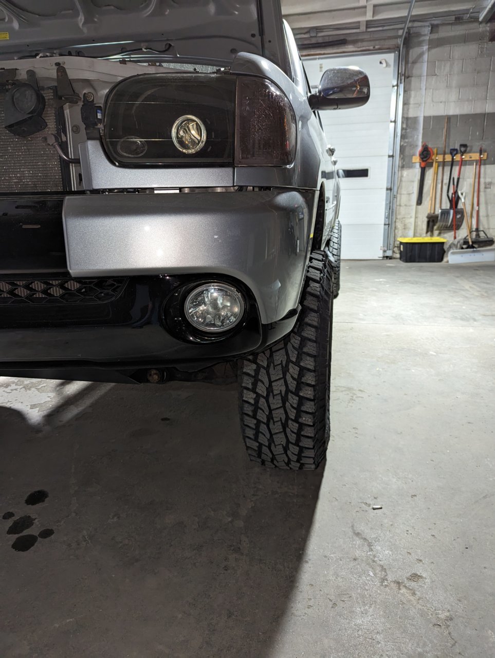

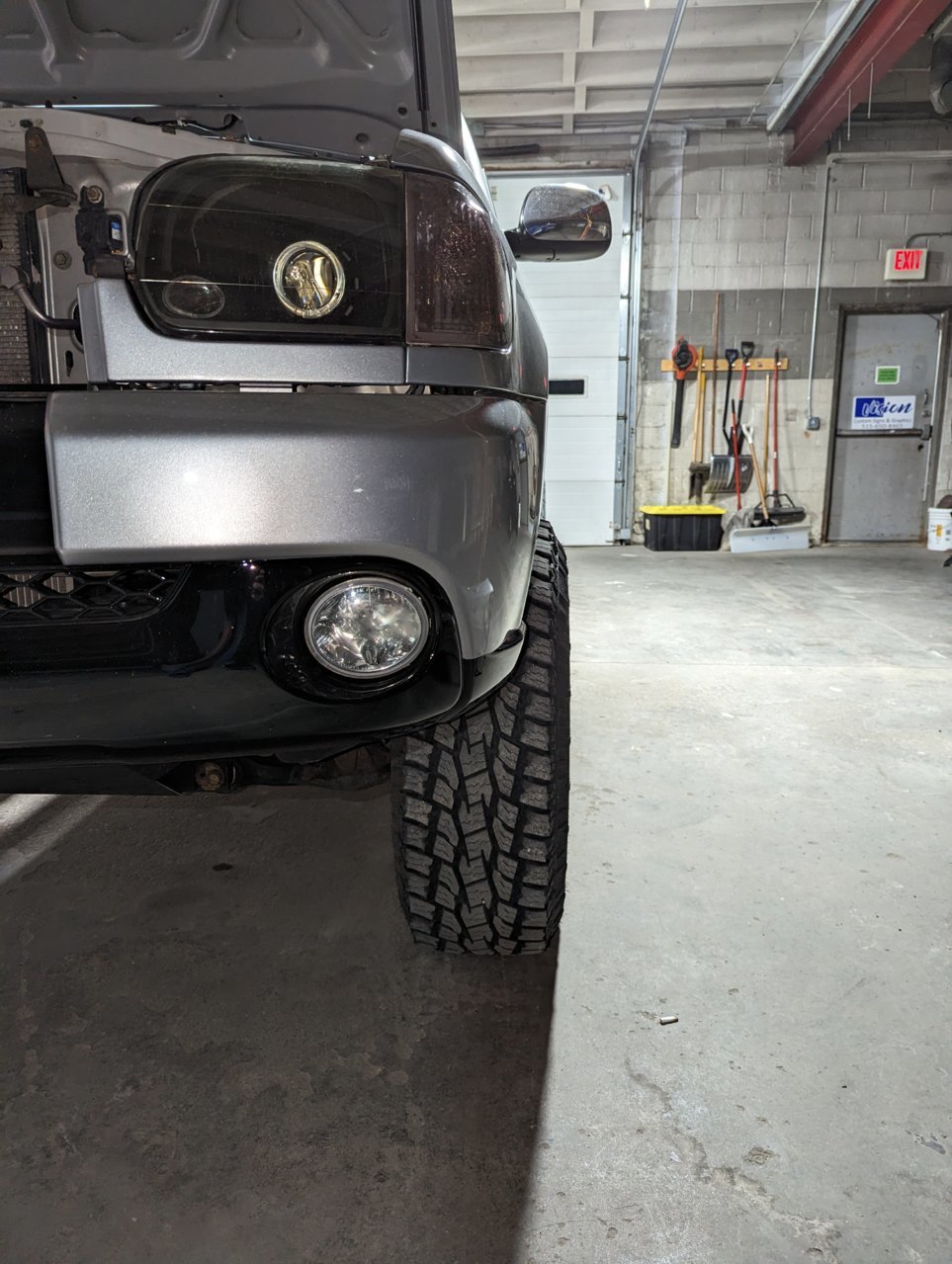

    Pics for more reference....
    285/75/17. 8.5 rim width -6mm offset 4.5" bs

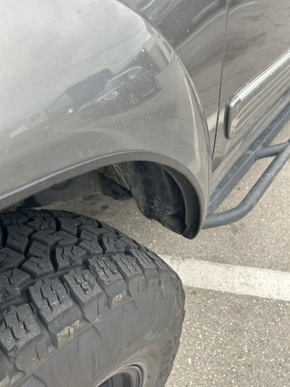

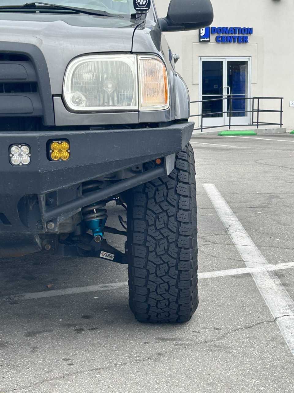

    Moving the wheels forward helps on these trucks, especially if your front bumper is modded and or washer reservoir is relocated. I’m running solo LCAs which move the wheel forward about 1”. Here’s my driver side.
    you can see fender and flare are cut back 1 1/2”, but I still hit the cab in there.
    bumper needs a trim for aesthetics only.

    Here’s the front poke. 15mm + 13mm + 19.5mm =47.5mm = 1.86 inches past OEM.
    Thats for offset, wheel width and 3/4” spacers.

    No spacers, no rub normal driving I don't wheel it so not sure if it would with suspension compressed.
