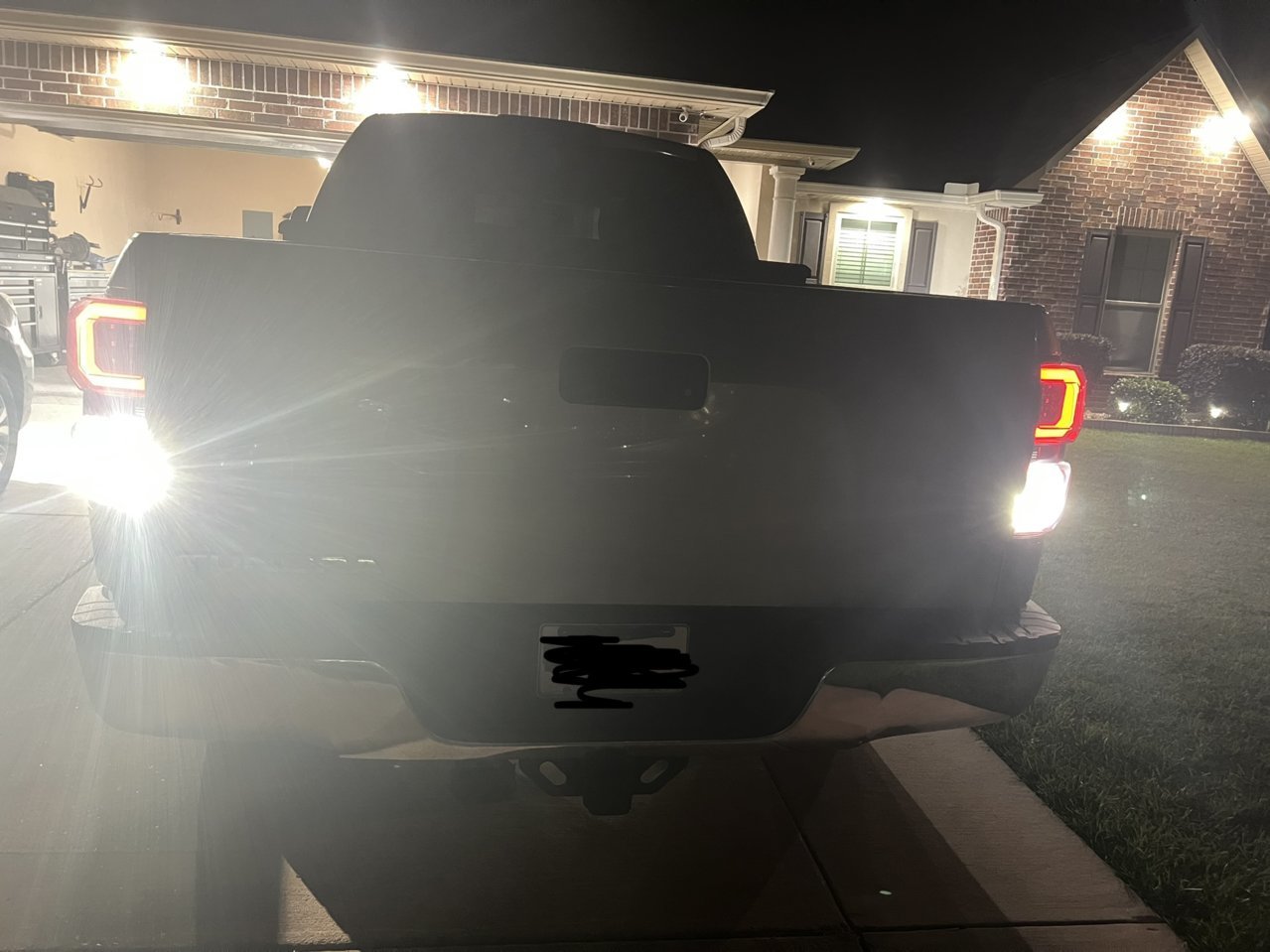

    Great product, great service and shipping, great results. Here are a few pics.

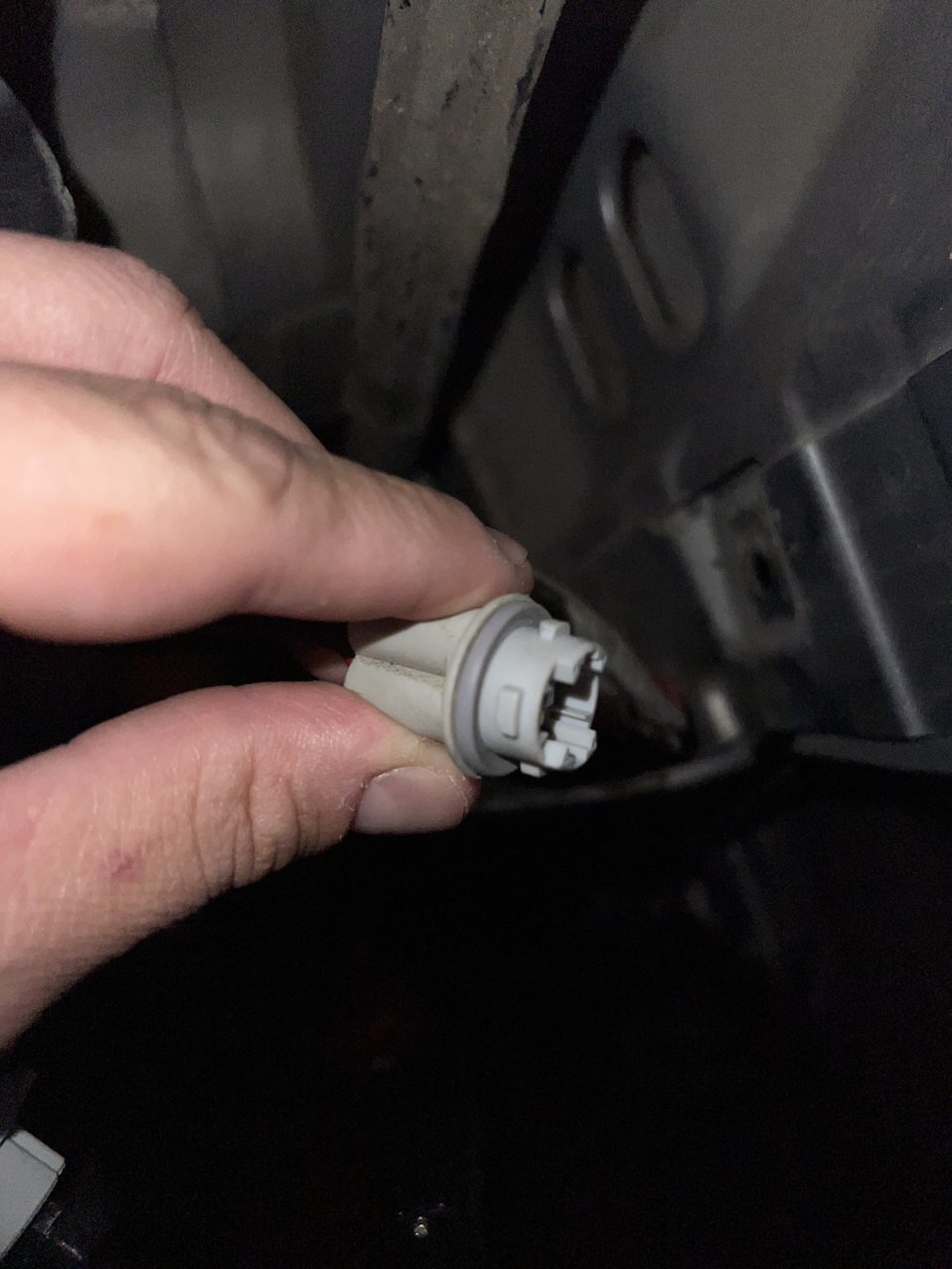

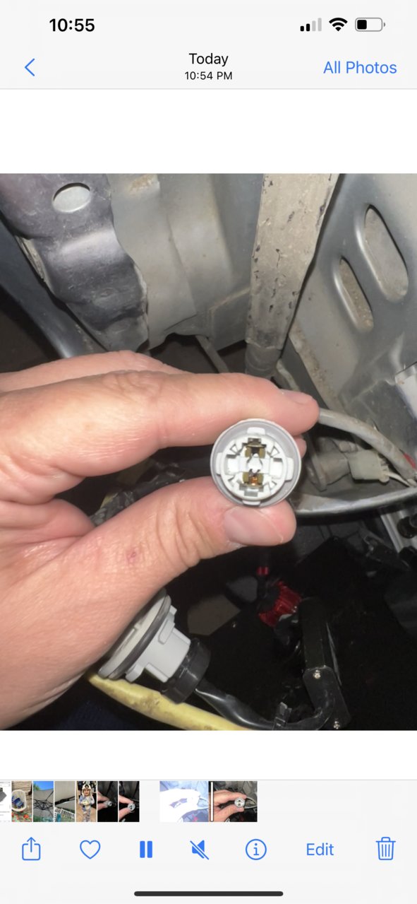

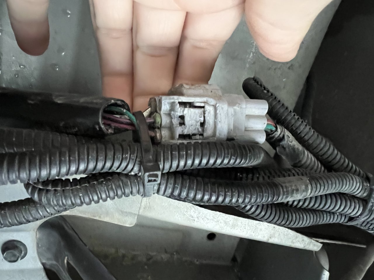

    Did anyone ever confirm if this works on a 2007-2013? Interested in buying one. Just upgraded to some super bright leds and the washout now is terrible. It’s actually quite difficult, almost impossible, to see out the camera in reverse.
  15. Apr 29, 2022 at 8:46 PM
    #75
    daveeasa
    daveeasa [OP] FBC Harness Solutions
    Dec 2, 2020
    #55605
    4,192
    David
    If you take a photo of your taillight connector for the reverse bulb and the connector which feeds your license plate lights I can probably tell you what the options are.
    I believe I had a failed attempt from a 2010? He did have an aftermarket bumper but I think no changes to his harness.
    To identify the plate light intercept you chase the harness upstream. Once you locate it, disconnect with parking lights on to confirm.
    With a photo I can probably figure out the connector and then based on locations I can estimate lengths.

    #16099

    Is this what you need?
    Reverse bulb connector
    E3742A43-F420-4620-B064-6E5CA8180C1C.jpg F2C52426-D8FC-488D-B544-504D68877E64.jpg 662D368D-2533-4497-8E3A-7A320FD5B06F.jpg
    License plate connector

    More that we want to chase it upstream. Looks like a pretty good match to my 2000-2006 Tundra DIR. Does your taillight have a 6 position connector feeding all the bulbs? If you hunt through this thread I believe @shifty` posted lots of photos from his install which might help.

    guess I’ll have to look more tom. I found 2 connectors under the truck with multiple wires going to it. I believe one was for the trailer hitch plug and the other seemed to be in a similar location to shiftys (where I had to pop the black piece out of frame to get better access to it) but when I unplugged that one the license plate lights remained on

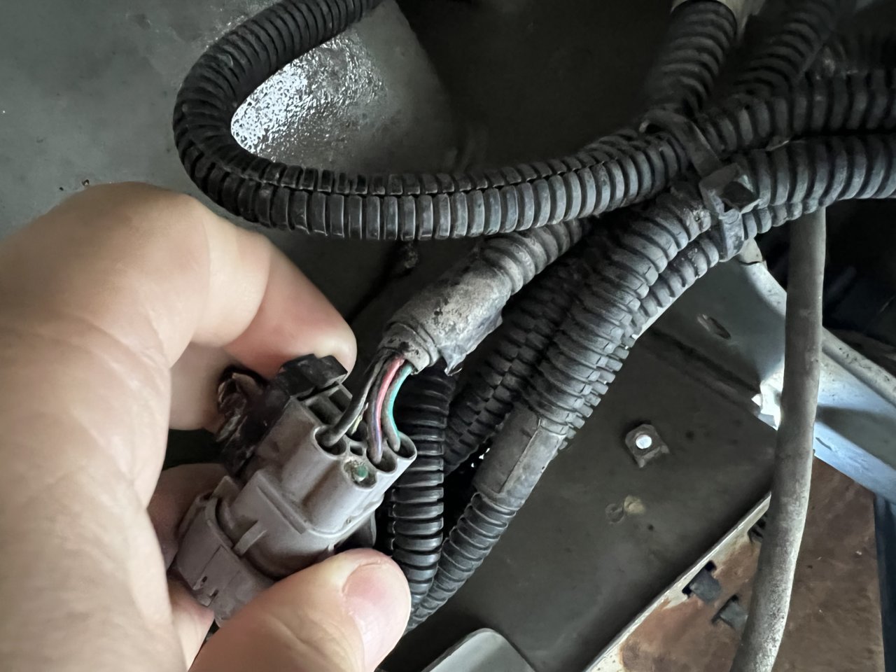

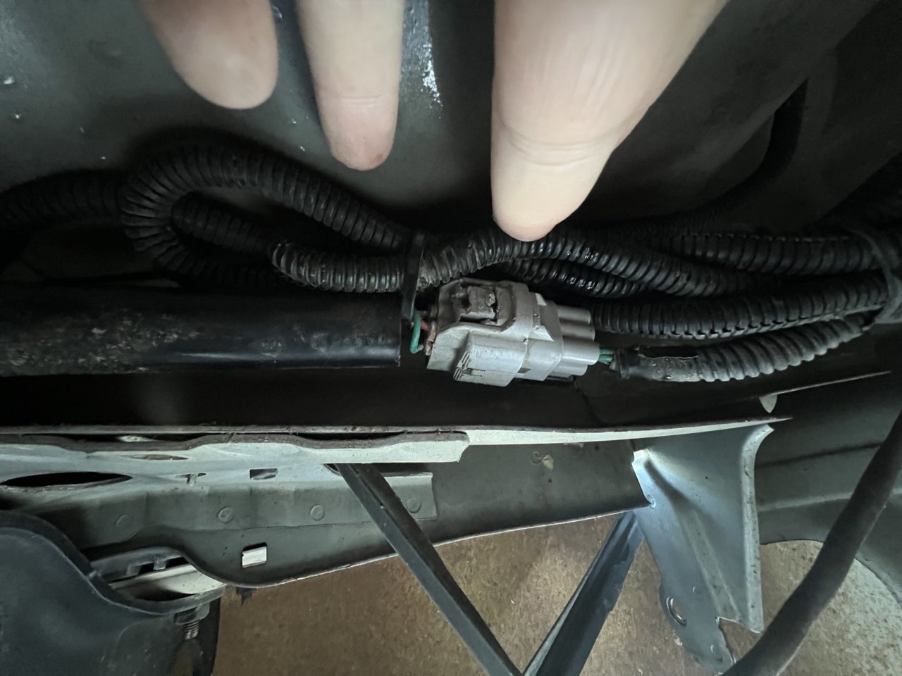

    On my 2002 there is a large intercept for the tow stuff and two six position (5 used) for the taillights, one on each side. And no license plate intercept. Hence the first gen DIR design. I have one built if you want to buy it and try. It should work with the plate bulbs but I’m not certain how to access your reverse signal. I could also tap off the tow connector if you’re not using it and it’s a match to the one spare I happen to have since I bought two. But I think I may not have the terminals and seals for large gauge there and ground is a thick one. I’m way behind on my Tundra tow harness build.
    The taillights should have clean connectors upstream of the bulb. Because replacement taillights would plug in.
    I’m 90% on your truck working with a 2000-2006 Tundra DIR kit. Take a close look at shifty’s photos in daylight underneath your truck and try to confirm the match.

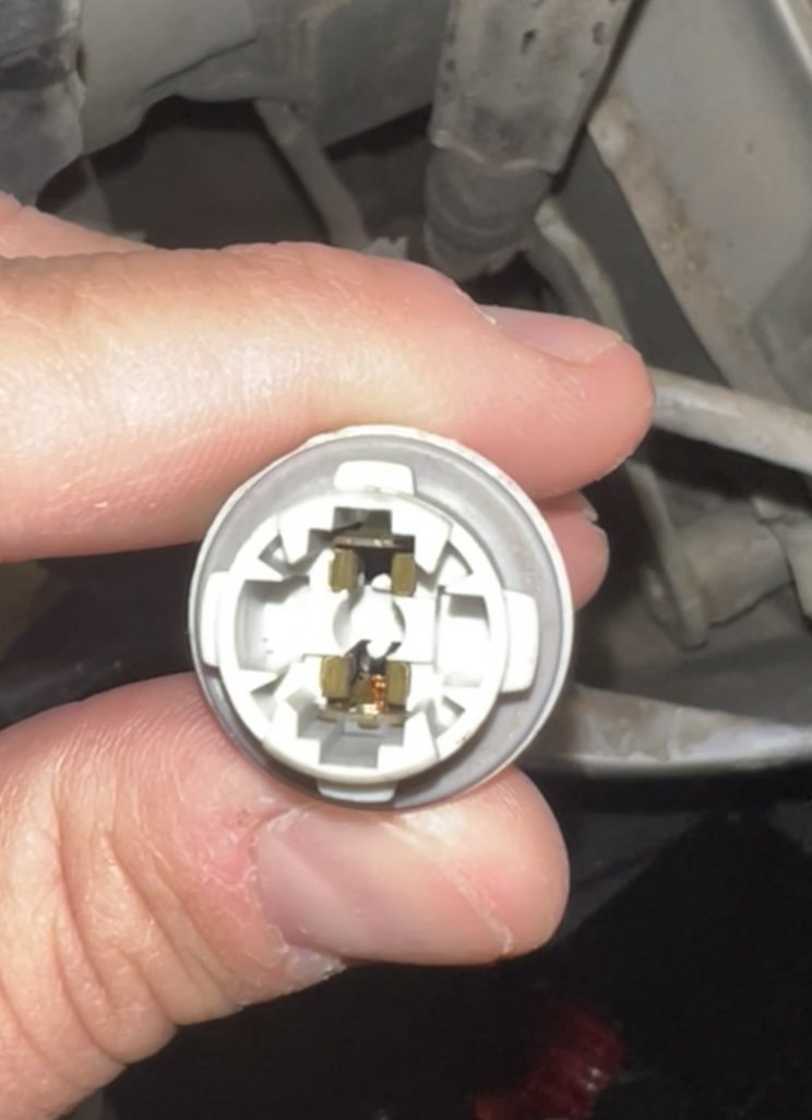

    Heres the plugs I have.
    Plugs in the middle which I believe are for the tow harness
    Then I have one of these connectors on each side which seem to be coming from the taillights.
    Driver:
    ADF3CF2B-DBA3-447E-B32E-C580BBF44BE9.jpg 07468815-AC50-40B7-AB94-4B743D35F05A.jpg
    Passenger:
    6E9267E9-AC6C-4013-8745-D0A9612EF300.jpg DAF43F1D-BF1F-401E-8216-D26472530E2F.jpg

    Yeah that is the 6 position taillight connector. same as FGT.
    If your bumper is stock as it seemed from the photos I’d give the 2000-2006 kit a try. I think it will work. No reason to suspect the pinouts are different on the taillight connector but that’s the lone remaining question. You only need to use the driver side taillight connector. Passenger side stays as is.
    Maybe one last possibility is that the lengths for the plate light T’s are longer for your 2011. If so, you could likely just mount the relay closer. Or, if customizations are needed, your feedback could be used to generate a spec for 2007-2013.

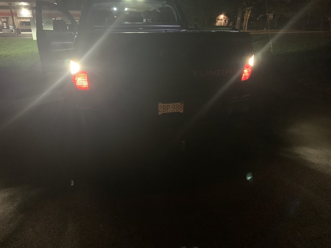

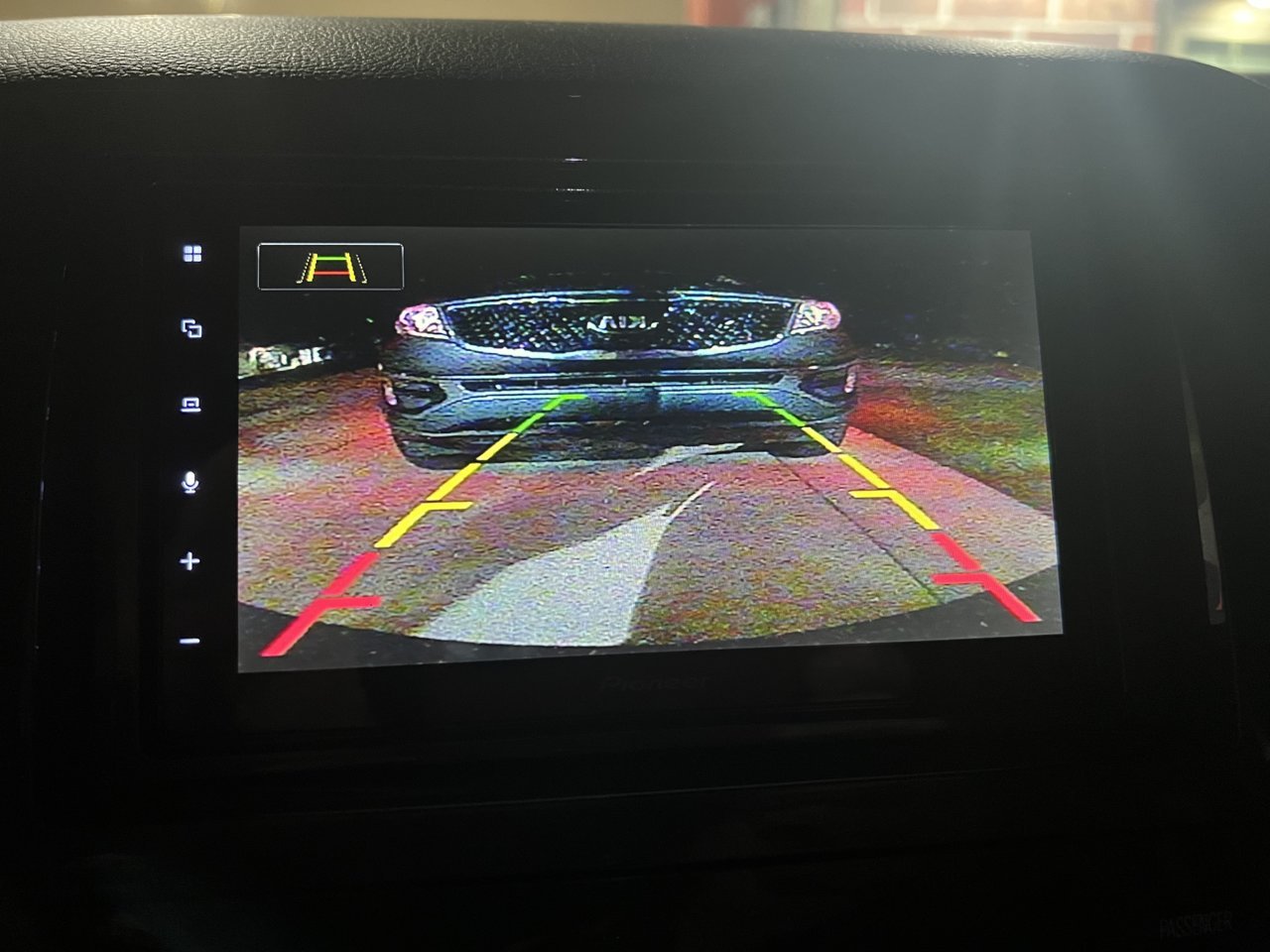

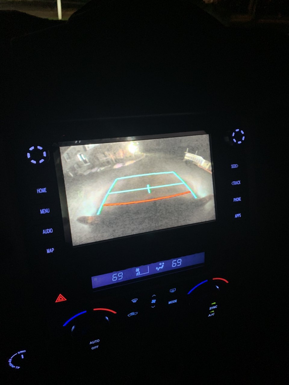

    Success!! The rewired replacement harness came in today. I was able to test it out and it works perfectly on the 2nd gen tundra.
    @daveeasa thanks for your help with getting this done and working
    I will post some pics hopefully tonite of my reverse cam pics with and without it

    Here are some pics of it in action:
    This is the license plate lights on with camera pic. I can barely see anything to reverse
    this is a pic of how the camera looks when reverse is engaged and license plate lights turn off d/t the DIR
    So much better now, thanks again @daveeasa
