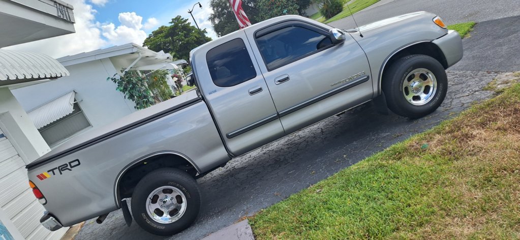

    Hey Dave, truck looks awesome! I love the old school hot rod style rally/US Indy style wheels. That's one I haven't seen, but I really like it.

    Thanks for your kind words. The wheels are Mickey Thompsons and weren't cheap, but have the look I was after. Oddly, the truck has the original Dunlop spare tire with a 22 YO date code. The bad news is that it's rusted solid in place.
